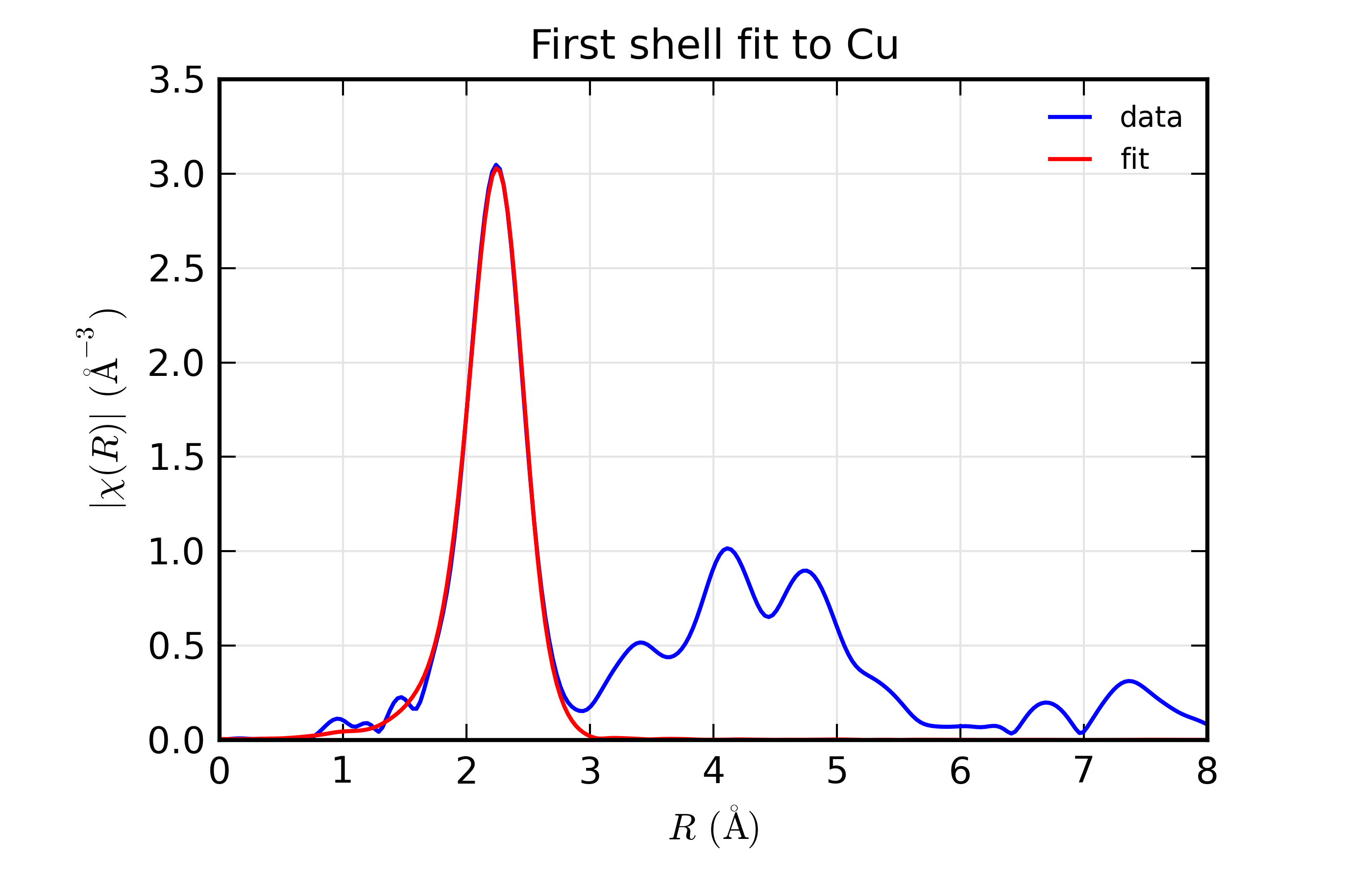

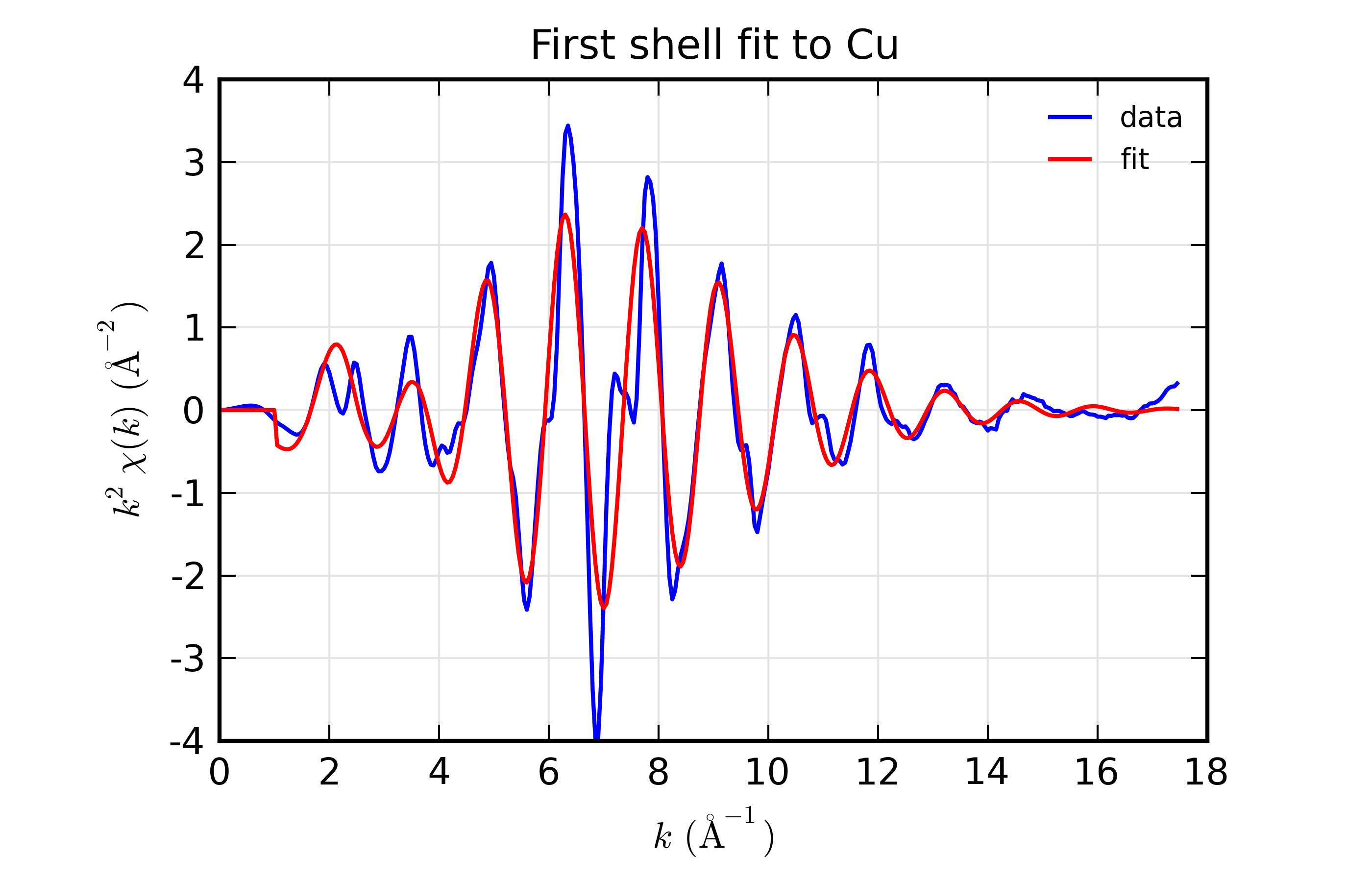

and generates the plots shown below
Results for Feffit for a simple 1-shell fit to a spectrum from Cu metal.
This is a pretty good fit to the first shell of Cu metal, and shows the basic mechanics of fitting XAFS data to Feff Paths. There are several things that might be added to this for modeling more complex XAFS data, including adding more paths to a fit, including multiple-scattering paths, simultaneously modeling more than one data set, and building more complex fitting models. We’ll get to these in the following examples.

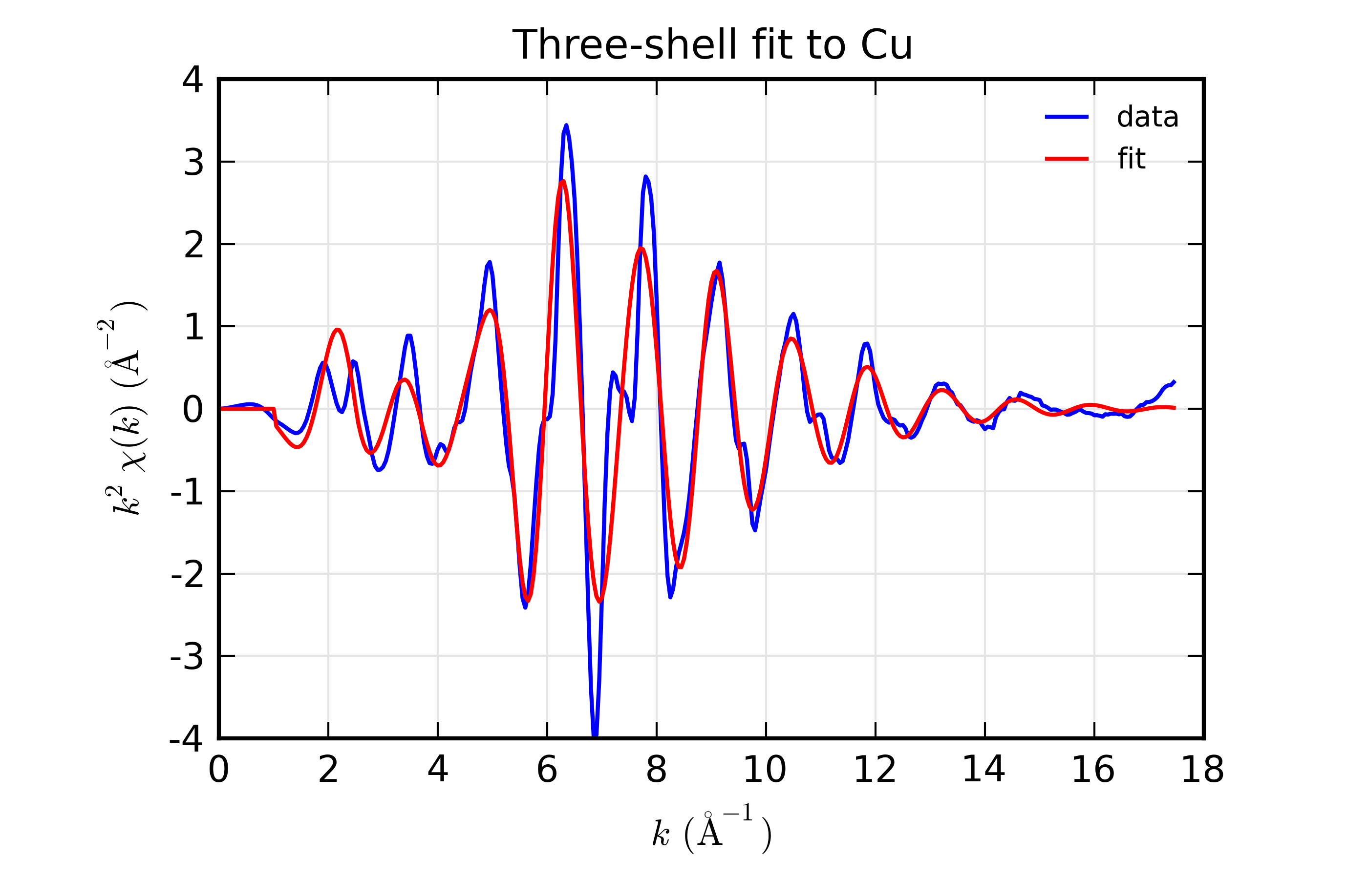

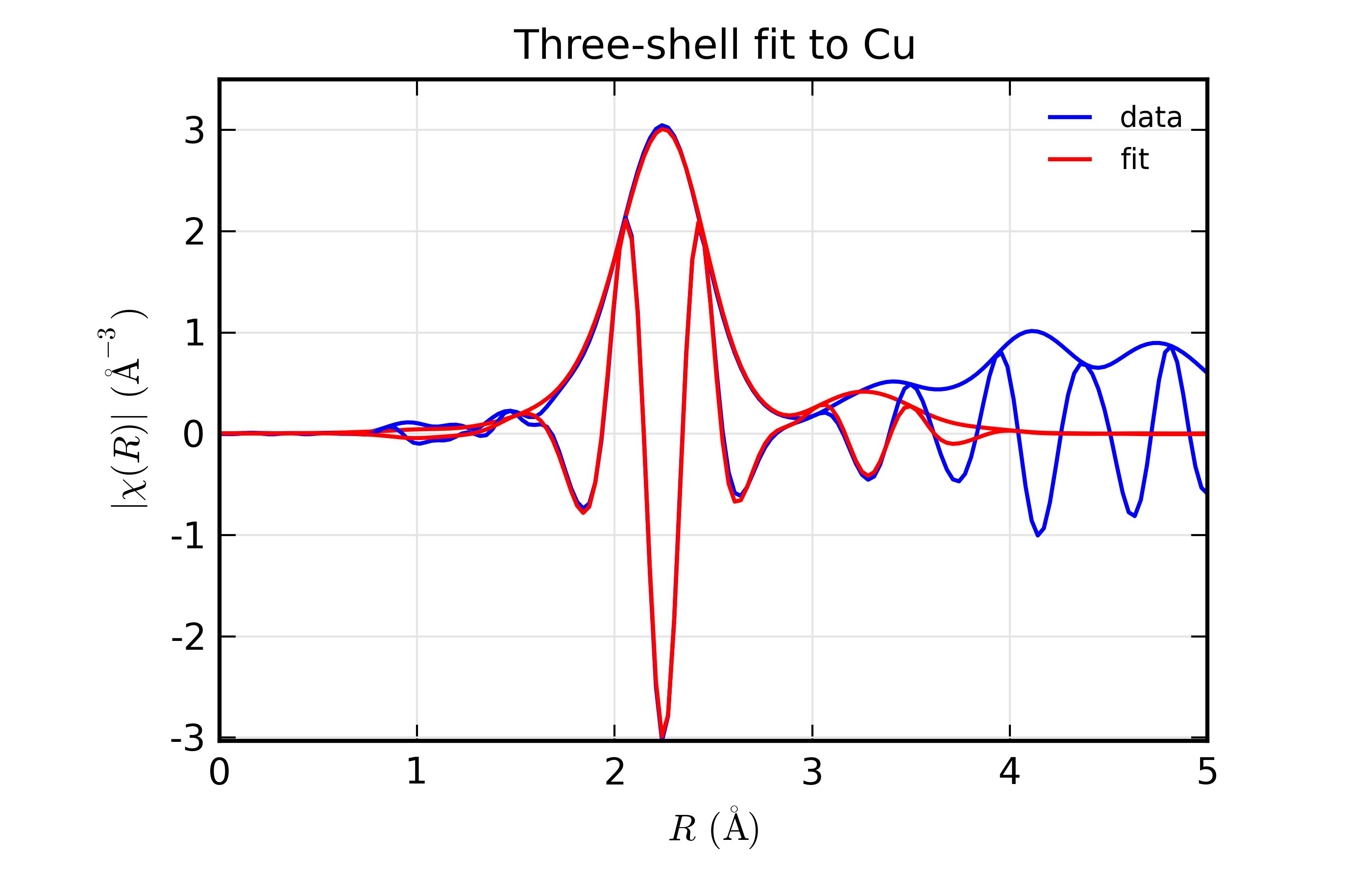

With plots of data and fits as shown below.
Results for Feffit for a 3-shell fit to a spectrum from Cu metal, constraining all path distances to expand with a single variable.

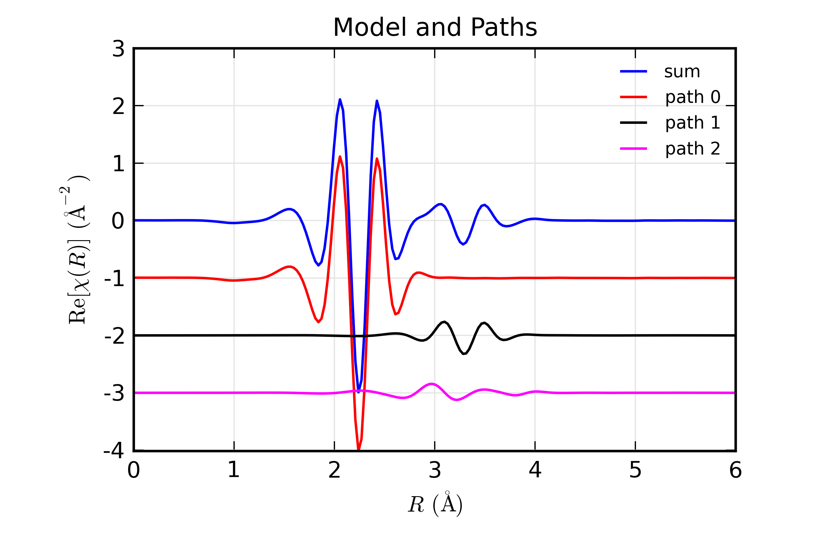

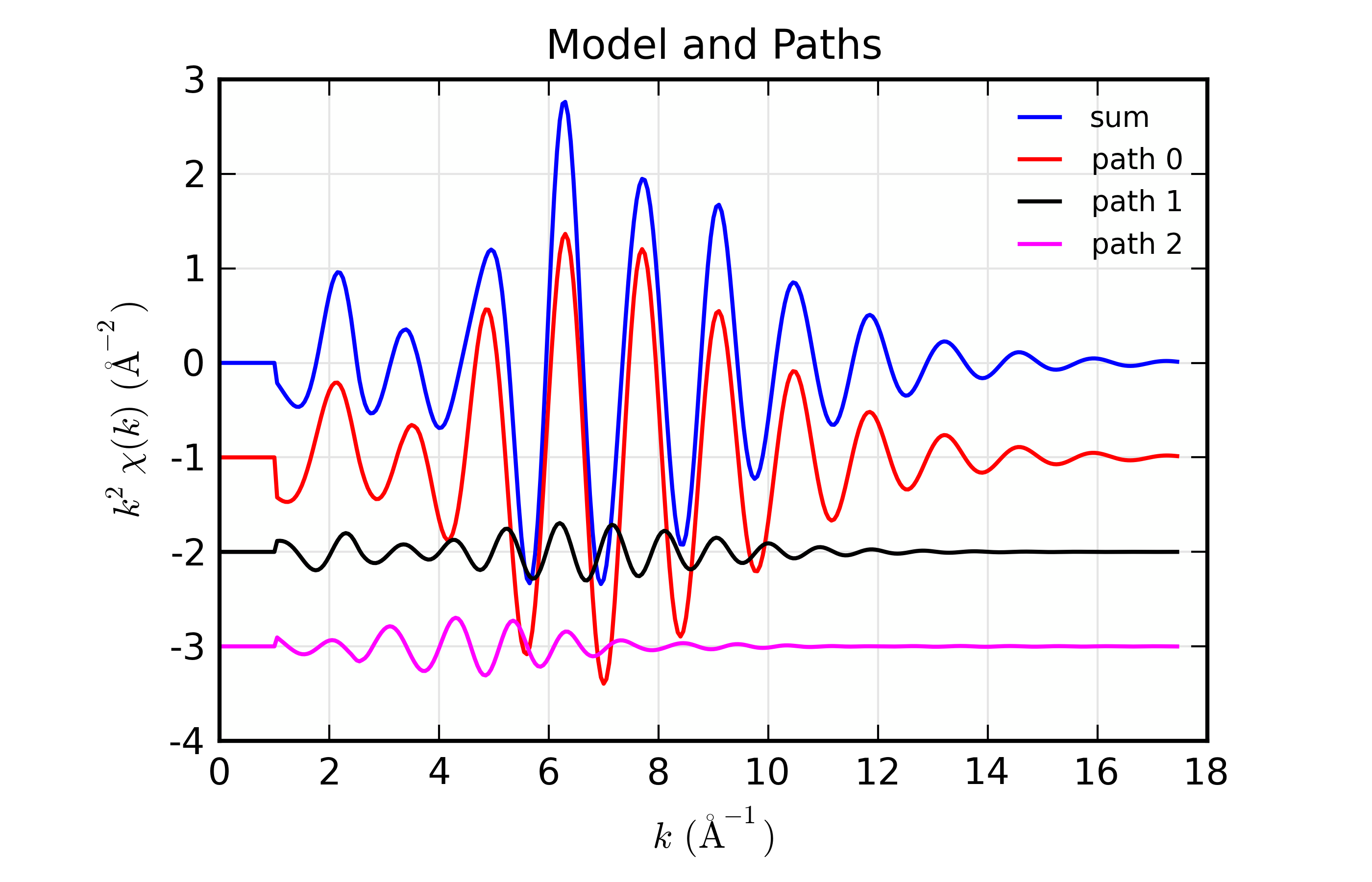

Here, we show both the magnitude and real part of \(\chi(R)\). The fit to the real part shows excellent agreement over the fit \(R\) range of [1.4, 3.4] \(\AA\). It is often useful the contributions from the individual paths. With the macros defined above, this is pretty straightforward, as we can just do:
plot_modelpaths_k(dset, offset=-1)
plot_modelpaths_r(dset, comp='re', offset=-1, xmax=6)
to generate the following plots of the contributions of the different paths:

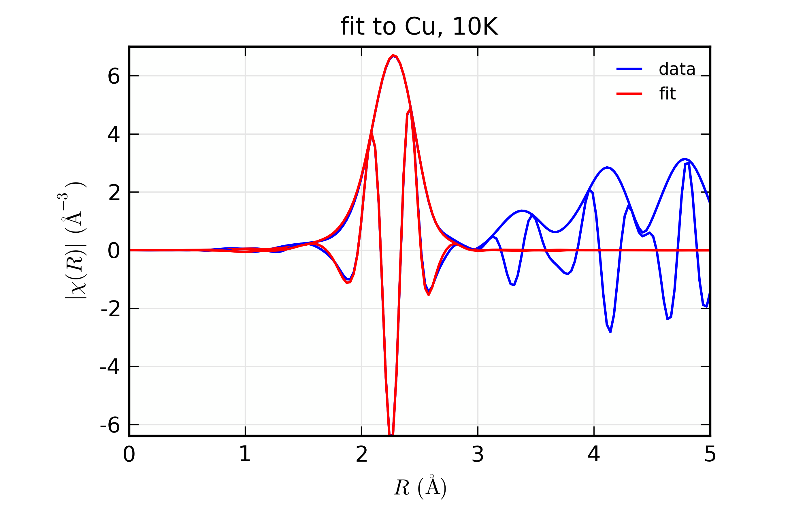

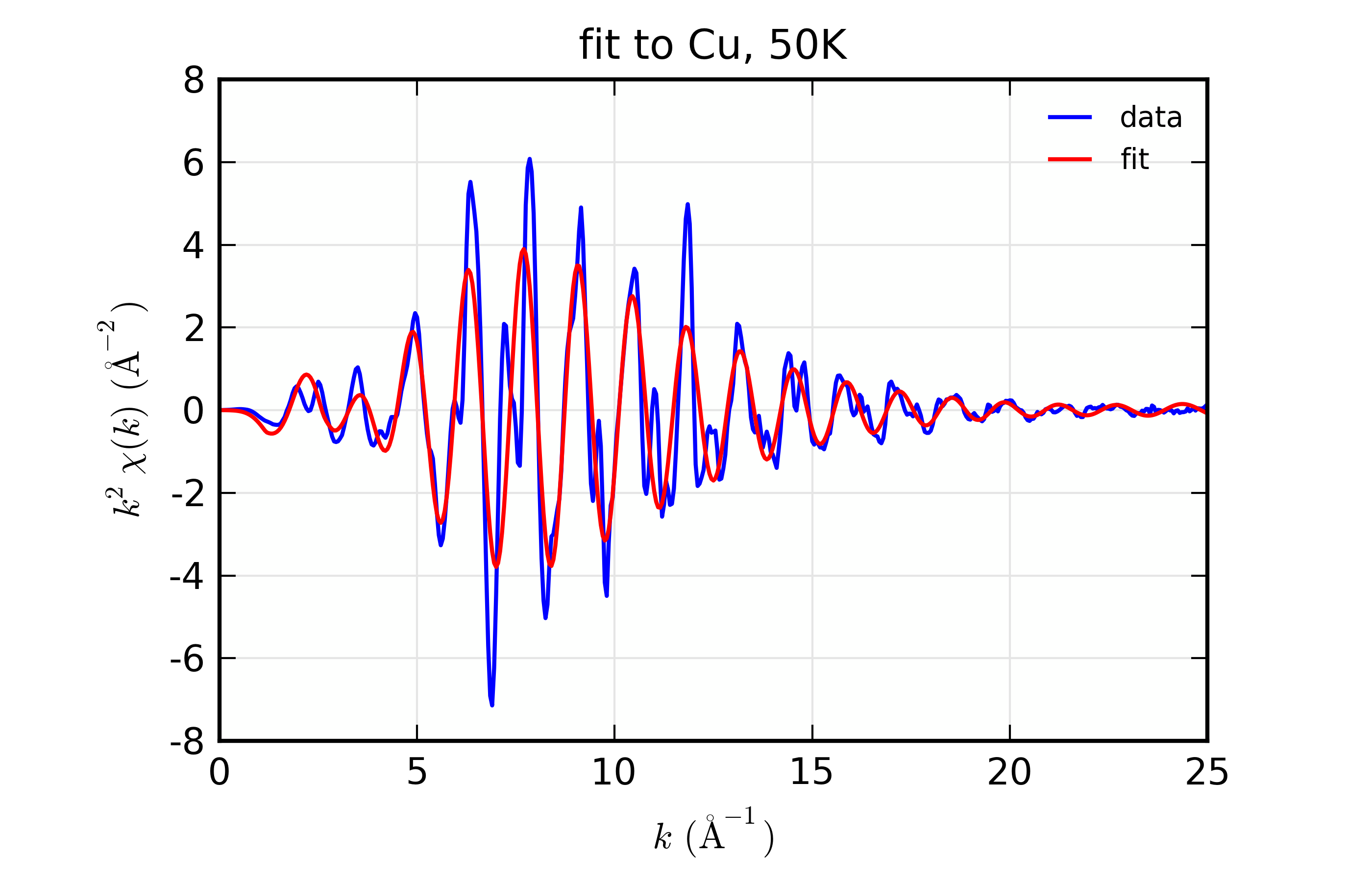

plot_chifit(dset_10, title='fit to Cu, 10K', rmax=5, win=1)
plot_chifit(dset_50, title='fit to Cu, 50K', rmax=5, win=3)
plot_chifit(dset_150, title='fit to Cu, 150K', rmax=5, win=5)
# ## end examples/feffit/doc_feffit3.lar
Here we read in 3 datasets for \(\mu(E)\) data and do the background subtraction on each of them. We define 5 fitting parameters, including the characteristic (here, Einstein) temperature which will determine the value of \(\sigma^2\), and two parameters for the linear temperature dependence of \(R\). The output for this fit is:
=================== FEFFIT RESULTS ====================

dataset 2:
Path pfh2ced6i, Feff.dat file = feff0001.dat
atom x y z ipot
Cu 0.0000, 0.0000, 0.0000 0 (absorber)
Cu 0.0000, -1.8016, 1.8016 1
reff = 2.54780000
degen = 12.0000000
n*s02 = 0.86909294 +/- 0.03045969 'amp'
e0 = 5.37431752 +/- 0.61259622 'del_e0'
r = 2.54800246 +/- 0.00254417 'reff + dr_off + 50*alpha*reff'
deltar = 2.0246e-04 +/- 0.00254417 'dr_off + 50*alpha*reff'
sigma2 = 0.00333714 +/- 1.2785e-04 'sigma2_eins(50, theta)'
dataset 3:
atom x y z ipot
reff = 2.54780000
degen = 12.0000000
r = 2.54952455 +/- 0.00295984 'reff + dr_off + 150*alpha*reff'
deltar = 0.00172455 +/- 0.00295984 'dr_off + 150*alpha*reff'
sigma2 = 0.00503023 +/- 2.9892e-04 'sigma2_eins(150, theta)'
Note that an uncertainty is estimated for the Path parameters, including
sigma2, which is calculated with the sigma2_eins() function.
Such derived uncertainties do reflect the uncertainties and correlations
between variables. For example, a simplistic evaluation for the standard
error in one of the sigma2 parameters using the estimated variance in
the theta might be done as follows:
larch> _ave = sigma2_eins(10, pars.theta)
larch> _dlo = sigma2_eins(10, pars.theta-pars.theta.stderr) - _ave
larch> _dhi = sigma2_eins(10, pars.theta+pars.theta.stderr) - _ave
larch> print "sigma2(T=10) = %.5f (%+.5f, %+.5f)" % (_ave, _dlo, _dhi)
sigma2(T=10) = 0.00328 (+0.00011, -0.00011)
This gives an estimate about 3 times larger than the estimate automatically derived from the fit. The reason for this is that the simple evaluation ignores the correlation between parameters, which is taken into account in the automatically derived uncertainties. In this case, including this correlation significantly reduces the estimated uncertainty.
The output plots for the fits to the three datasets are given below.
Fit to Cu metal at 10 K, 50 K, and 150 K, from simultaneous fit to all 3 datasets with 5 variables used.
Again, in the interest of brevity and consistency through this chapter, these example are deliberately simple and meant to be illustrative of the capabilities and procedures and should not be viewed as limiting the types of problems that can be modeled.

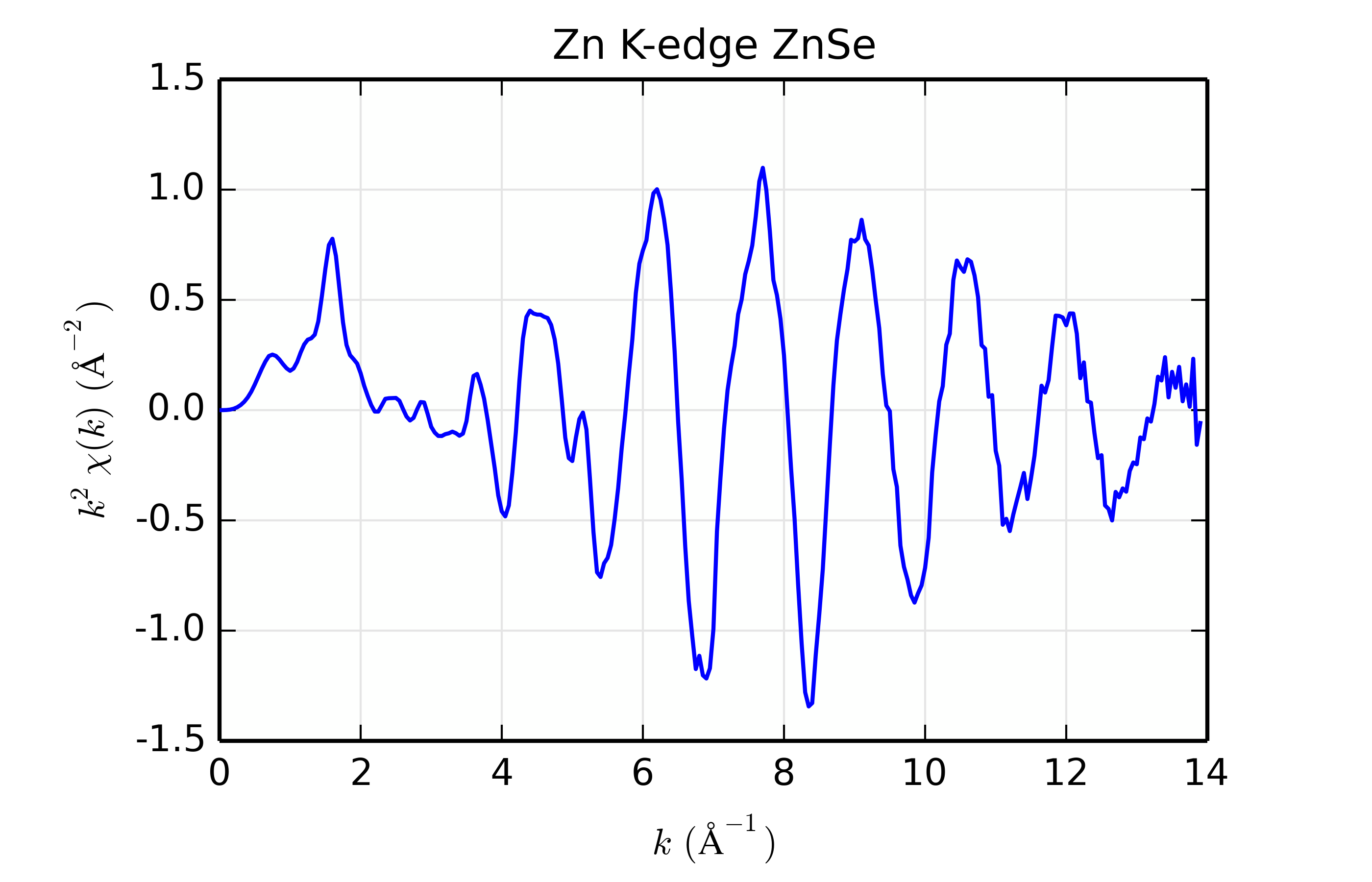

11.8.13. Example 6: Testing EXAFS sensitivity to \(Z\)¶
EXAFS is known to be sensitive to the atomic number \(Z\) of the scattering atom. This is due to the \(Z\) dependence of the scattering amplitude and phase shift (\(f(k)\) and \(\delta(k)\) in the EXAFS Equation of Section 11.7.5). A rule-of-thumb that is often stated is that EXAFS is sensitive to \(Z \pm 5\), or perhaps pessimistically to row of the Periodic Table, but not as sensitive as \(Z \pm 1\). Occassionally, you may see work that claims very fine \(Z\) sensitivity, such as being able to distinguish N and O ligands. In those works, XAFS results are typically used with chemical arguments about steric effects or known bond distances.
In this section, we’ll explore the \(Z\) sensitivity of XAFS with real data, by constructing Feff paths with different scatterers and trying to fit data with these different scattering paths. This makes a nice exercise in how to manipulate Feff, how to fit XAFS data, and how to compare XAFS fits. Just to make it a little more complicated, we’ll also explore the idea of Phase corrected Fourier transforms and how they might be used to better determine both \(R\) and \(Z\). The example script here is a little more complex than what we’ve seen above, using many feature of the Larch scripting language to do repeated fits and mathematically manipulating the arrays of data.
For this example, we’ll use Zn K-edge data of ZnSe, with \(\chi(k)\) data shown in Figure 11.8.15. The data is pretty good but not perfect, and is useful for the study here mainly because the structure is simple, with a well-isolated and well-ordered shell of scatterers (the cubic ZnS structure with 1 Zn site surrounded by 4 Se at 2.45 \(\rm\AA\)). While we’re sure that the scatterer should be Se, we’ll try scatterers of Zn, Ge, Se, Br, and Rb, spanning a small but sufficient range of \(Z\).
To construct the scattering paths, we’ll modify a Feff input file. To do
this, we start with a feff.inp file generated for crystalline ZnSe by the
ATOMS program, and add an IPOT to the list of atomic potentials (here the
line 3 35 Br), and then replace the IPOTs for 1 of the neighboring Se
atoms (that is, replacing a 2 with a 3, and changing the tag for
convenience). The resulting feff.inp file for Br looks this:

The script to compare the fits will loop over these different scattering paths, doing a fit for each path, and store the results. This takes advantage of several features of the Larch scripting capabilities, including defining functions, and constructs like loops and dictionaries, as well as mathematical manipulation of the resulting arrays for the phase correction. The full script is:

After reading in the data, the script builds Feff Paths, putting them into a dictionary. After define the fitting transform range, the script loops over each of the scatterers, doing a simple first-shell fit with each. The the phase-corrected \(\chi(R)\) is then calculated, and the peak value of \(R\) is found for this array. Finally, results are printed out.
Table of ZnSe Results. The results from fitting ZnSe XAFS data to scattering paths of Zn-Zn, Zn-Ge, Zn-Se, Zn-Br, and Zn-Rb. All paths started at the nominal distance of 2.454 \(\rm\AA\).
Scatterer reduced chi-square \(S_0^2\) \(\sigma^2\) \(E_0\) \(R\) \(R_{\rm{ph cor}}\) Zn (30) 57.5 0.73(0.07) 0.0040(0.0006) -7.98(1.23) 2.471(0.006) 2.451 Ge (32) 32.4 0.90(0.06) 0.0050(0.0005) -2.99(0.93) 2.461(0.004) 2.457 Se (34) 12.7 0.89(0.04) 0.0059(0.0003) 0.09(0.58) 2.448(0.003) 2.461 Br (35) 16.7 1.08(0.06) 0.0070(0.0004) 1.71(0.79) 2.444(0.003) 2.462 Rb (37) 88.7 1.10(0.14) 0.0073(0.0009) 5.27(1.42) 2.425(0.007) 2.467
The results of the fits are given in the Table of ZnSe Results, with graphs below showing fits to the 5 different scatterers. The dependence of the results on \(Z\) of the back-scattering atom is seen to be reasonably strong. The values for reduced chi-square definitely indicate that Zn-Se is the best fit, and the values for the fitted parameters have rather clear correlations with \(Z\) – \(S_0^2\), \(\sigma^2\), and \(E_0\) increase with \(Z\), while \(R\) decreases. If anything, the \(Z \pm 5\) rule-of-thumb seems pessimistic, though the fits with Ge and Br look decent enough that it would be easy to conclude that \(Z \pm 2\) is reasonable.
As a curious side note, we note that \(S_0^2\) increases with
\(Z\). The scattering factor should also increase with \(Z\), which
might lead us to suspect a trend in the opposite direction. The confounding
factor here is \(\sigma^2\) – if we fix \(\sigma^2\) to 0.006 (by
changing vary=True to vary=False) and re-run the fits, \(S_0^2\)
has a slight negative dependence on \(Z\).
