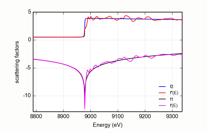

The input \(\mu(E)\) data are first matched to the tabulated \(f''(E)\) using the MBACK algorithm of :cite::Weng with an option of using the modification proposed by :cite::lee-xiang. This scales the measured \(\mu(E)\) to the size of the tabulated function and adjusts the overall slope of the data to best match the tabulated value. This is seen at the top of Figure Figure 11.9.1.
The difference between the scaled \(\mu(E)\) and the tabulated \(f''(E)\) is then subjected to the KK transform. The result is added to the tabulated \(f'(E)\) spectrum to produce the resulting real part of the energy-dependent complex scattering factor. This is shown at the bottom of Figure 11.9.1.
../_images/diffkk_cu.png
Figure 11.9.1 The anomalous scattering factors determined for copper metal from a copper foil, compared with the bare-atom, Cromer-Liberman values.

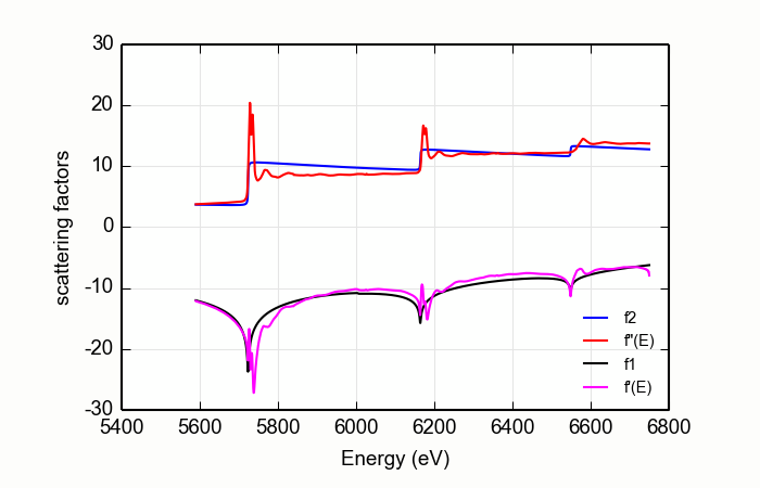

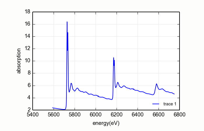

The diffKK method is fairly straightforward for K edge data. The algorithm for matching the measured \(\mu(E)\) to the tabulated \(f''(E)\) works quite well over the entire data range, resulting in a relatively unambiguous determination of \(f'(E)\). The situation for L edge data is a bit more complicated.
Consider the CeO2L edge data shown on the right on Figure 11.9.4. For these data, the matching algorithm is quite a bit more challenging, in part due to the very large spectral weight underneath the white lines and in part because the step size ratios in real data may not match the step size ratios in the tabulated \(f'(E)\).
../_images/diffkk_ceo2_xafs.png
Figure 11.9.2 L edge data measured on CeO2
../_images/diffkk_ceo2_notok.png
Figure 11.9.3 A poor stab at diffKK analysis of CeO2
../_images/diffkk_ceo2_ok.png
Figure 11.9.4 A better stab at diffKK analysis of CeO2

These larch command created the plot in Figure 11.9.3.
data=read_ascii('CeO2_L321.xmu')
dkk=diffkk(data.e, data.xmu, z=58, edge='L3', mback_kws={'e0':5723, 'order':2})
dkk.kk()
The large white lines of the L3and L2edges cause an upwards slope in the function used to match the measured data to the tabulated data. This results in a suspicious \(f'(E)\). The situation is even worse when a higher order polynomial is used for the normalization.
