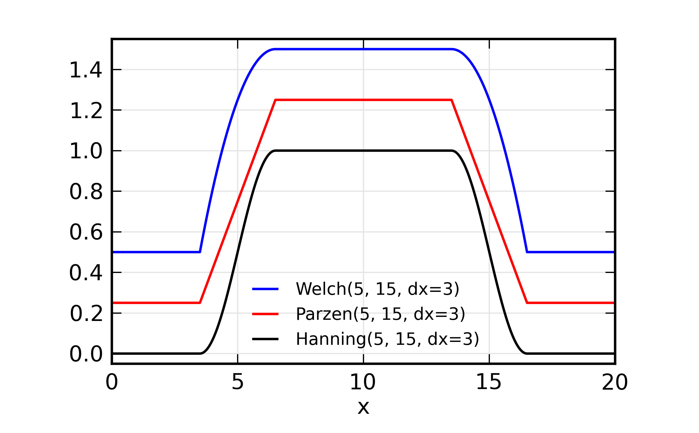

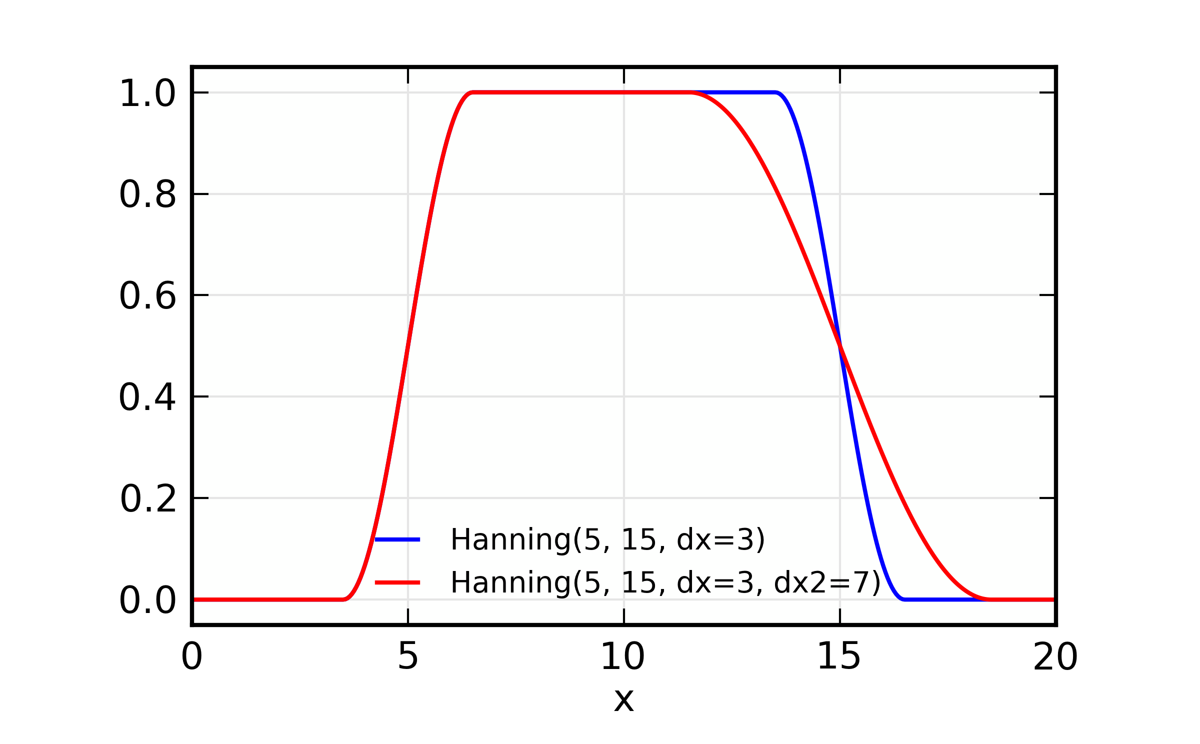

11.5.5. Catalog of Fourier transform window
Here, we give a series of example windows, to illustrate the different window types and the effect of the various parameters. The meanings of xmin, xmax, dx and dx2 are identical for the Hanning, Parzen and Welch windows, and illustrated in the two following figures.

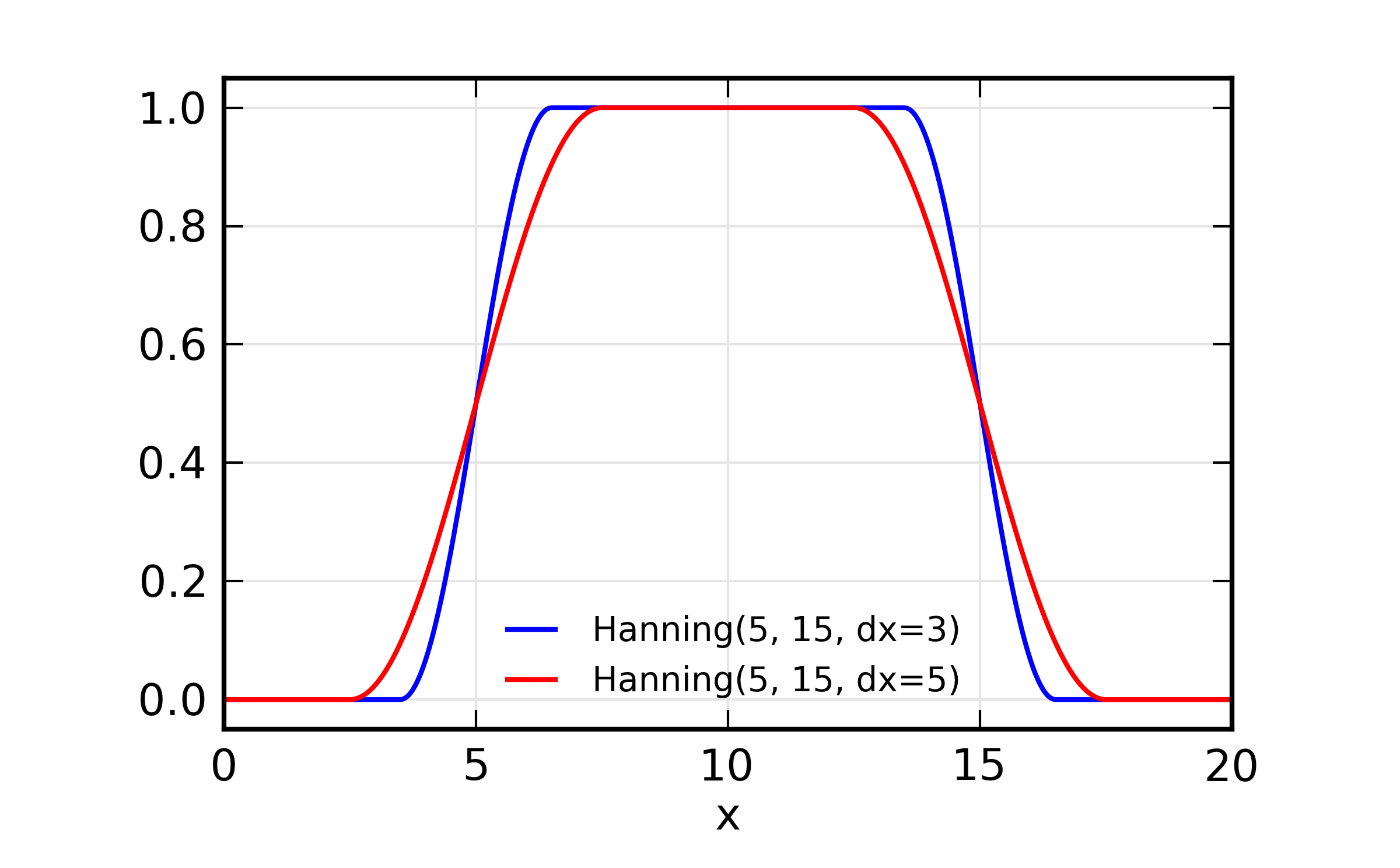

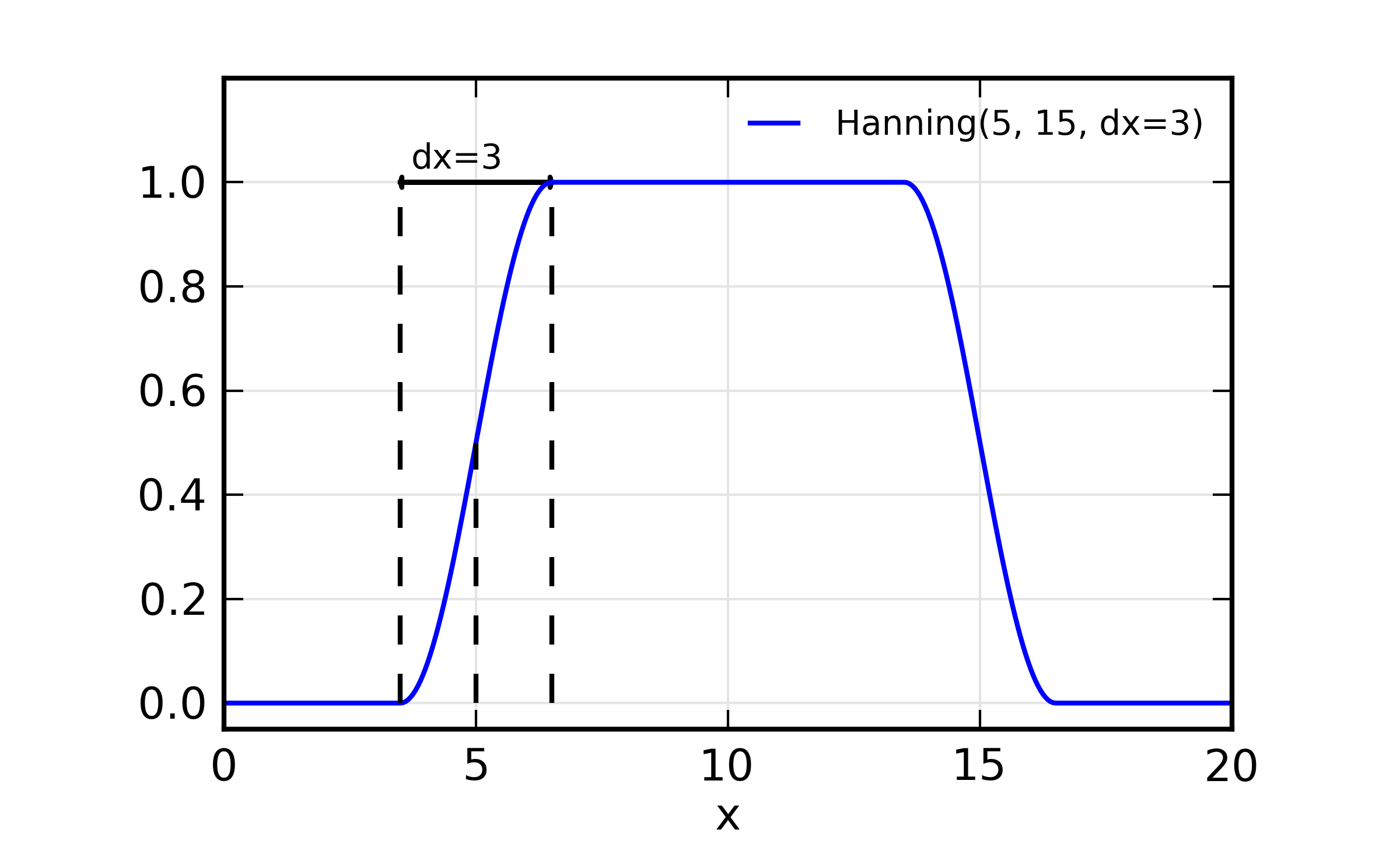

../_images/ftwin_example1.png
../_images/ftwin_example2.png
Fourier Transform window examples and illustration of parameter meaning for the Hanning, Parzen, and Welch windows. Note that \(\Omega(x=x_{\rm min}) = \Omega(x=x_{\rm max}) = 0.5\), and that the meaning of dx is to control the taper over which the window changes from 0 to 1. Here, xmin=5 and xmax=15.

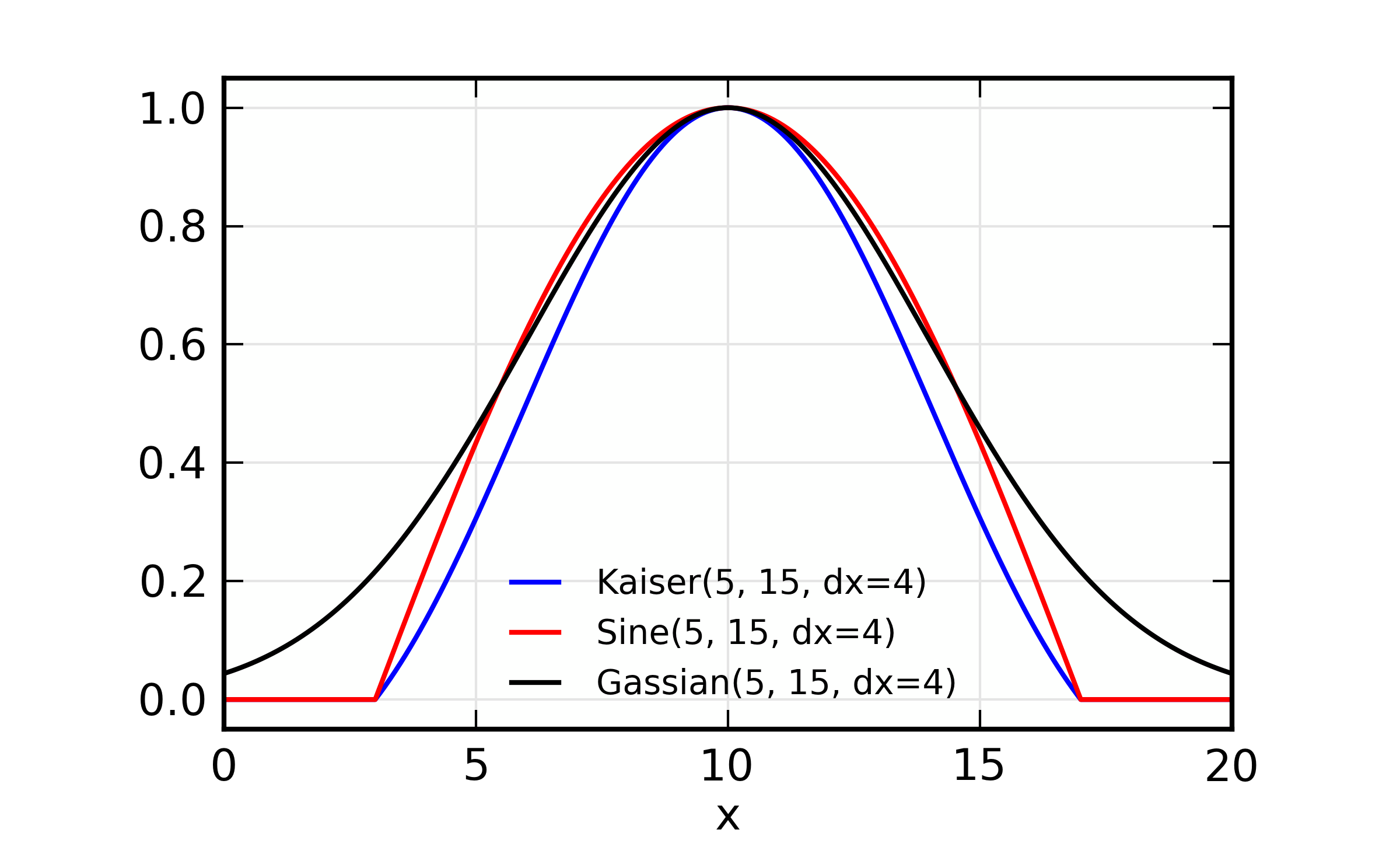

Some more window functions:
../_images/ftwin_example3.png
../_images/ftwin_example4.png
Fourier Transform window examples and illustration of parameter meaning. On the left, a comparison of Welch, Parzen, and Hanning with the same parameters is shown. On the right, the effect of dx2 is shown as a different amount of taper on the high- and low-x end of the window. As before, xmin=5 and xmax=15.

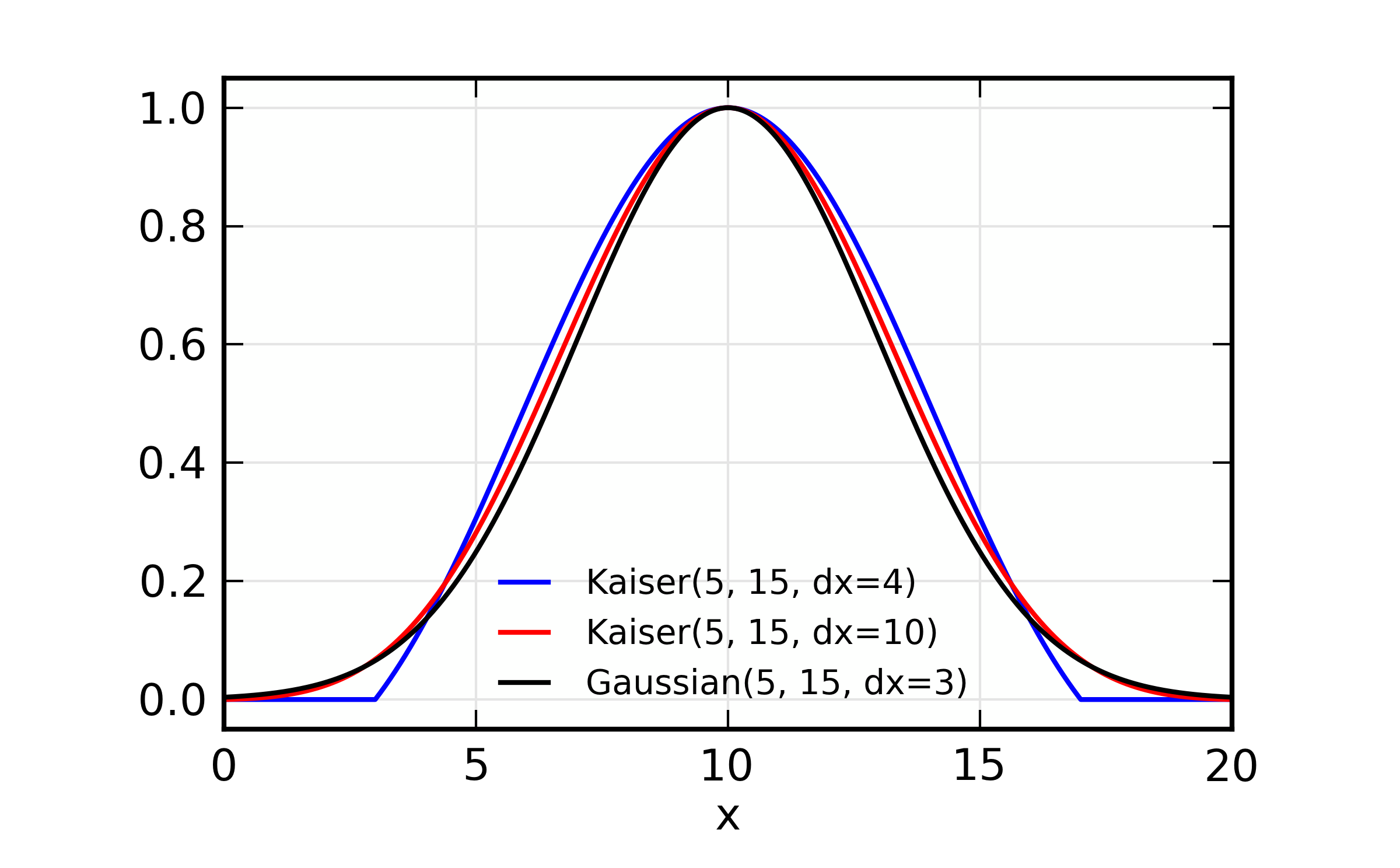

The Gaussian, Sine, and Kaiser-Bessel windows are illustrated next. These go to 1 at the average of xmin and xmax, but do not stay at 1 over a central portion of the window – they taper continuously. The Gaussian window is a simple Gaussian function, and is not truncated according to xmin and xmax, and the dx parameter sets the width. The Sine and Kaiser-Bessel windows both go to zero at xmin-dx/2 and xmax + dx/2. For very large values of dx, the Kaiser-Bessel window approaches a nearly Gaussian lineshape.
../_images/ftwin_example5.png
../_images/ftwin_example6.png
Fourier Transform windows. On the left, a comparison of Kaiser-Bessel, Sine, and Gaussian windows with the same parameters is shown. On the right, the effect of dx is shown for the Kaiser-Bessel window, and a closer comparison to a Gaussian window is made.

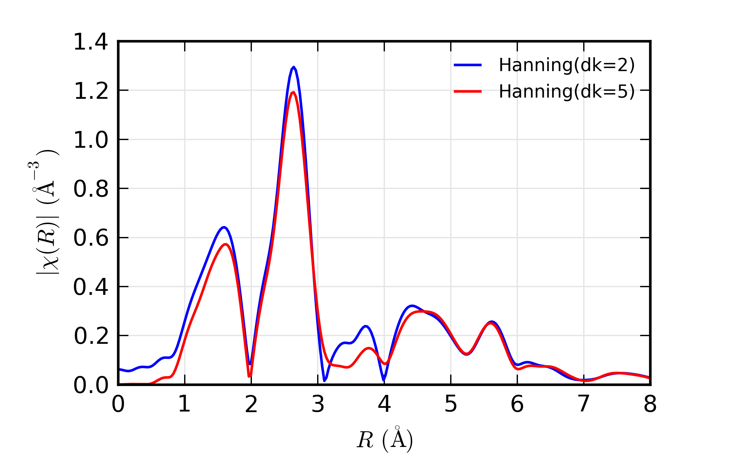

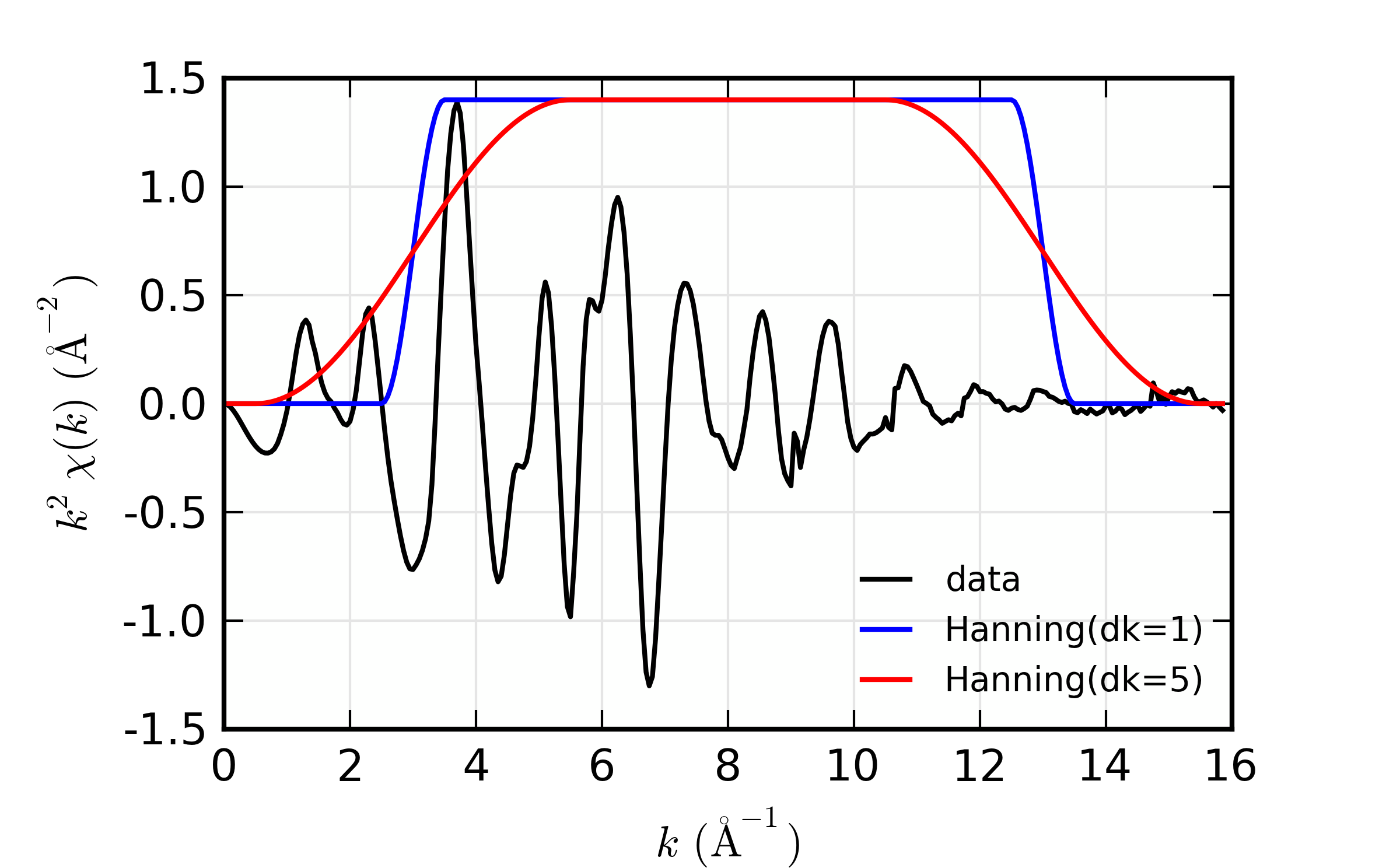

We start with a comparison of a small value of dk and a larger value. A script that runs xftf(), changing on dk would look like:
xftf(dat1.k, dat1.chi, kmin=3, kmax=13, dk=1, window='hanning',
     kweight=kweight, group=dat1)
dat2 = group(k=dat1.k, chi=dat1.chi) # make a copy of the group
xftf(dat2.k, dat2.chi, kmin=3, kmax=13, dk=5, window='hanning',
     kweight=kweight, group=dat2)
would result in the following results:
../_images/xft_example1.png
../_images/xft_example2.png
Comparison of the effect of different values of dk on real XAFS Fourier transforms. Increasing dk reduces peak heights and tends to broaden peaks, but the effects are rather small.

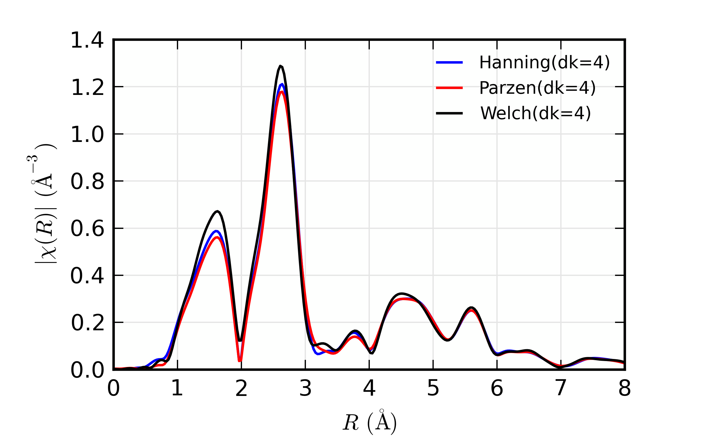

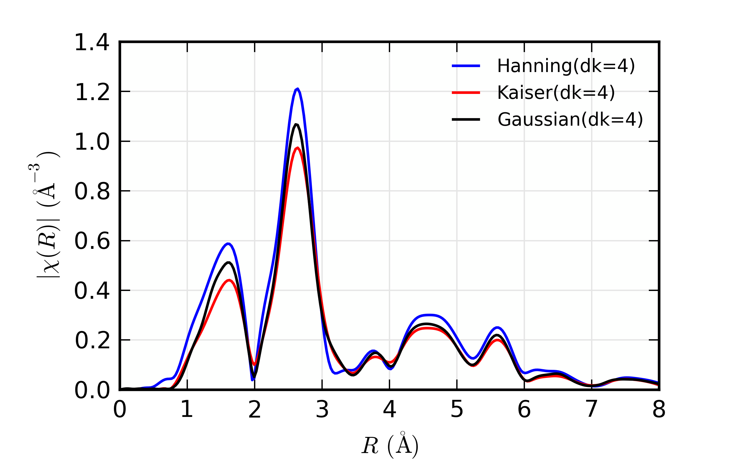

A script that runs xftf() with consistent parameters, but different window types:
xftf(dat1.k, dat1.chi, kmin=3, kmax=13, dk=4, window='hanning',
xftf(dat2.k, dat2.chi, kmin=3, kmax=13, dk=4, window='parzen',
dat3 = group(k=dat1.k, chi=dat1.chi) #
xftf(dat3.k, dat3.chi, kmin=3, kmax=13, dk=4, window='welch',
     kweight=kweight, group=dat3)
dat4 = group(k=dat1.k, chi=dat1.chi) #
xftf(dat4.k, dat4.chi, kmin=3, kmax=13, dk=4, window='kaiser',
     kweight=kweight, group=dat4)
dat5 = group(k=dat1.k, chi=dat1.chi) #
xftf(dat5.k, dat5.chi, kmin=3, kmax=13, dk=4, window='gaussian',
     kweight=kweight, group=dat5)
../_images/xft_example3.png
../_images/xft_example4.png
Comparison of the effect of different window types on real XAFS Fourier transforms.

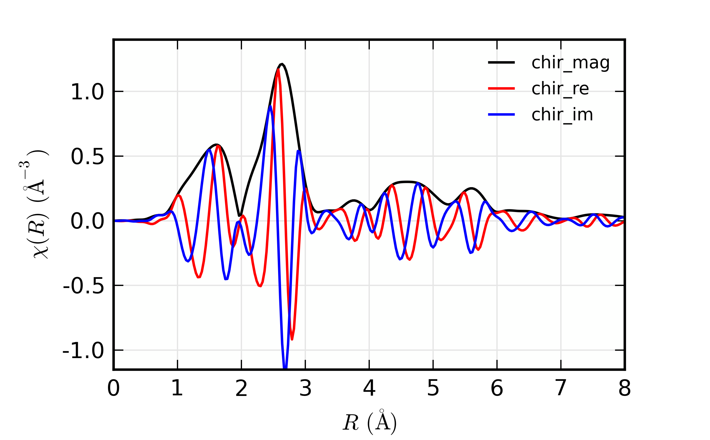

We now turn our attention to the different components of the Fourier transform. As above, it is most common to plot the magnitude of the Fourier transform. But, as the transformed \(\chi(R)\) is complex, it can be instructive to plot the real and imaginary components, as shown below:
newplot(dat1.r, dat1.chir_mag, xmax=8, label='chir_mag',
        show_legend=True, legend_loc='ur', color='black',
        xlabel=r'$R \rm\, (\AA)$', ylabel=r'$\chi(R)\rm\,(\AA^{-3})$' )
plot(dat1.r, dat1.chir_re, color='red', label='chir_re')
plot(dat1.r, dat1.chir_im, color='blue', label='chir_im')
which results in
../_images/xft_example5.png
Figure 11.5.11 The real and imaginary components of the XAFS Fourier transform.
In fact, in the analysis discussed with feffit(), the real and imaginary components are used, not simply the magnitude.

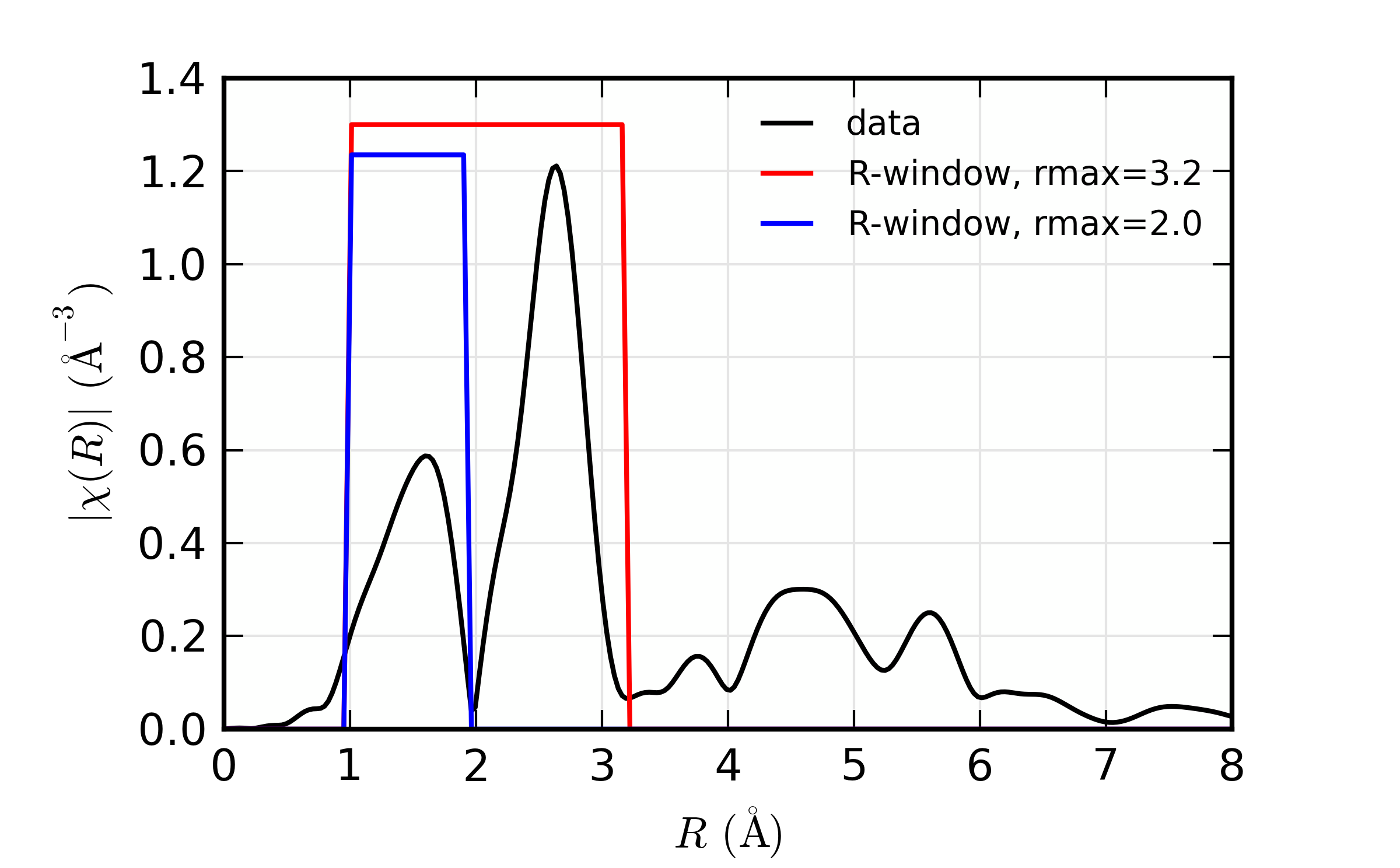

11.5.7. Examples: Reverse XAFS Fourier transforms, Fourier Filtering

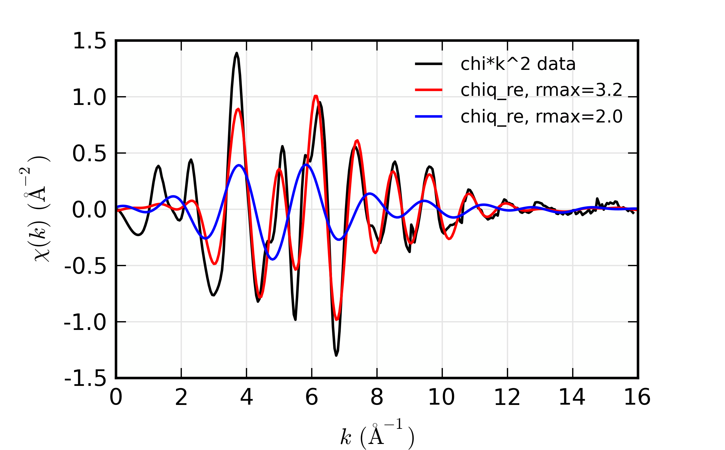

A reverse Fourier transform will convert data from \(\chi(R)\) to \(\chi(q)\). This allows a limited range of frequencies (distances) to be isolated and turned back into a \(\chi(k)\) spectrum. Here, we show two different \(R\) windows to filter either just the first shell of the spectra, or the first two shells, and compare the resulting filtered \(\chi(q)\).
../_images/xft_example6.png
../_images/xft_example7.png
Reverse XAFS Fourier transform, or Fourier filtering. Here, one can see the effect of different window sizes on the Fourier filtered spectrum. Including the first two peaks or shells reproduces most of the original spectrum, with only high-frequency components removed.
Note that it is chiq_re that is compared to the k-weighted chi array.
