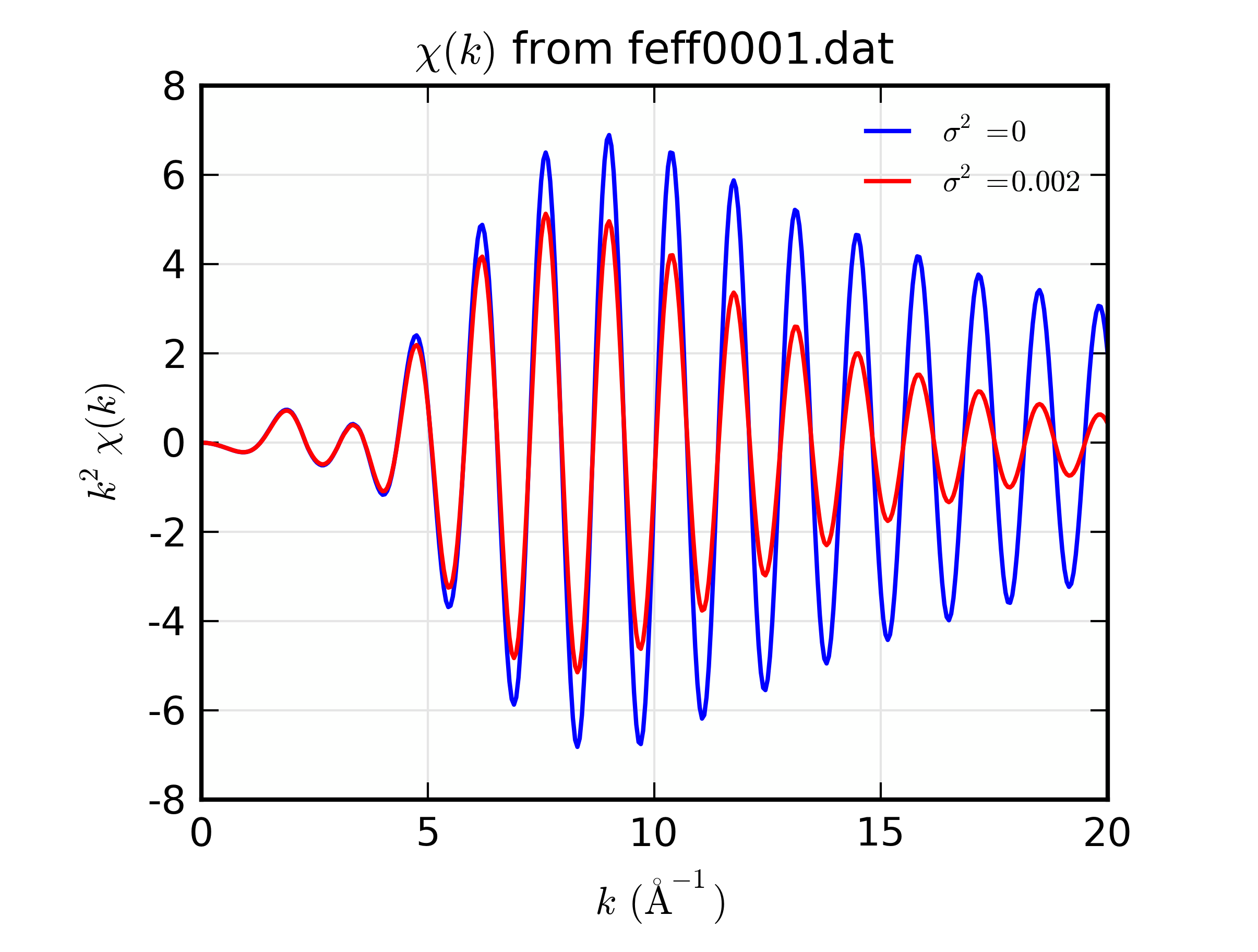

11.7.7. Example: Reading a Feff file
Here we simply read a feffNNNN.dat file and display its components, and calculate \(\chi\) for this path with two different values of \(\sigma^2\).
## examples/feffit/doc_feffdat1.lar
fname = 'feff0001.dat'
path1 = feffpath(fname)
path2chi(path1)
show(path1)
newplot(path1.k, path1.chi*path1.k**2, xlabel=r' $ k \rm\, (\AA^{-1})$',
        ylabel=r'$ k^2\chi(k)$', label = r'$\sigma^2 = 0$', show_legend=True,
        title=r'$\chi(k)$ from %s' % fname)
path1.sigma2 = 0.002
path2chi(path1)
plot(path1.k, path1.chi*path1.k**2, label = r'$\sigma^2 = 0.002$')
## end examples/feffit/doc_feffdat1.lar
The output of this looks like this:

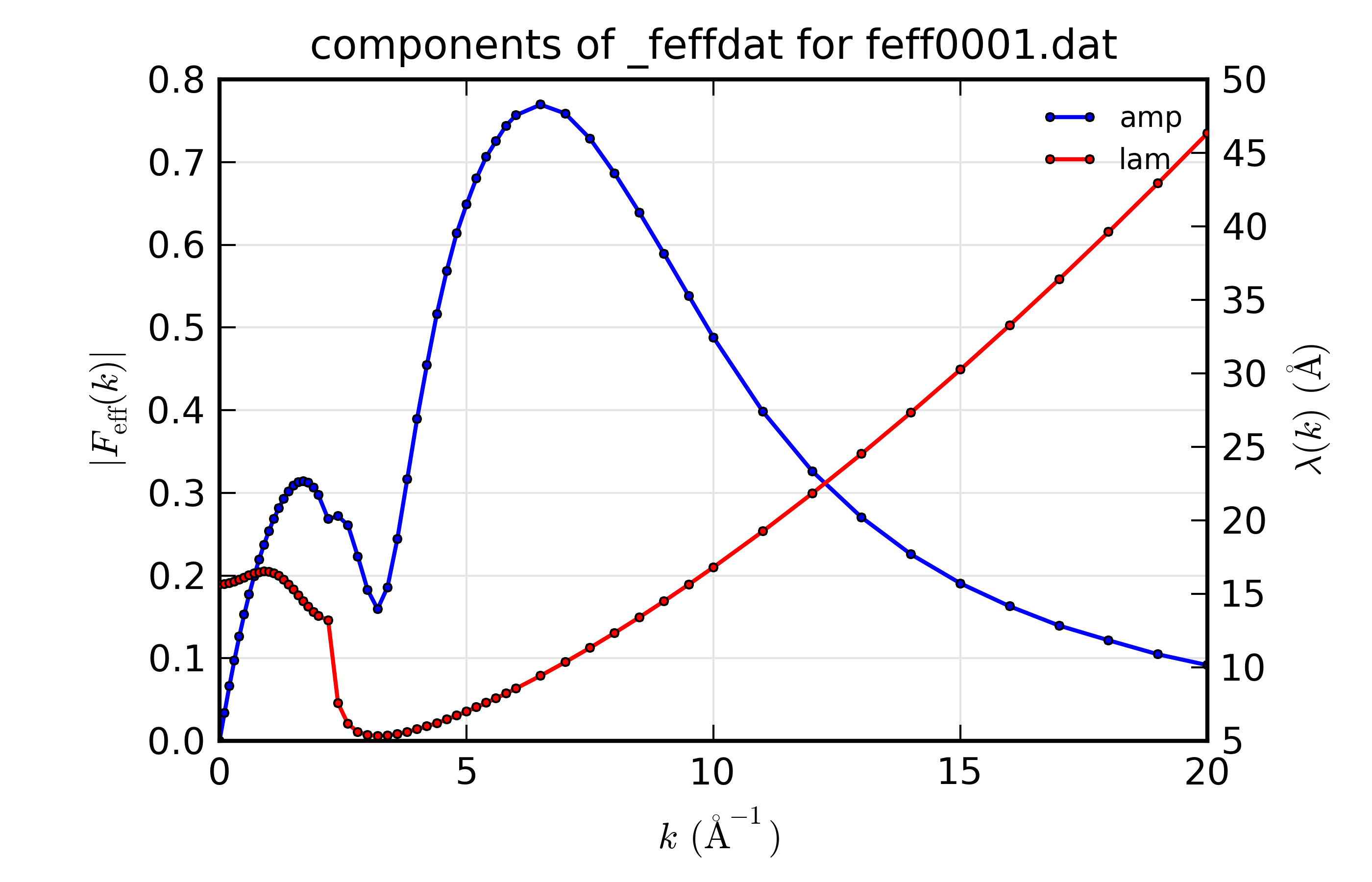

We can also use the data from the _feffdat group to look at the individual scattering components. Thus to look at the scattering amplitude and mean-free-path for a particular scattering path, you could use a script like this:
## examples/feffit/doc_feffdat2.lar
newplot(path1._feffdat.k, path1._feffdat.amp, xlabel=r' $ k \rm\, (\AA^{-1})$',
        ylabel=r'$ |F_{\rm eff}(k)|$', label = r'amp', show_legend=True,
        title=r'components of _feffdat for %s' % fname,
        marker='o', markersize=4)
plot(path1._feffdat.k, path1._feffdat.lam, side='right',
     marker='o', markersize=4,
     label = r'lam', y2label=r'$ \lambda(k) \rm\, (\AA)$')
## end examples/feffit/doc_feffdat2.lar
which will produce a plot like this:
../_images/feffdat_example2.png

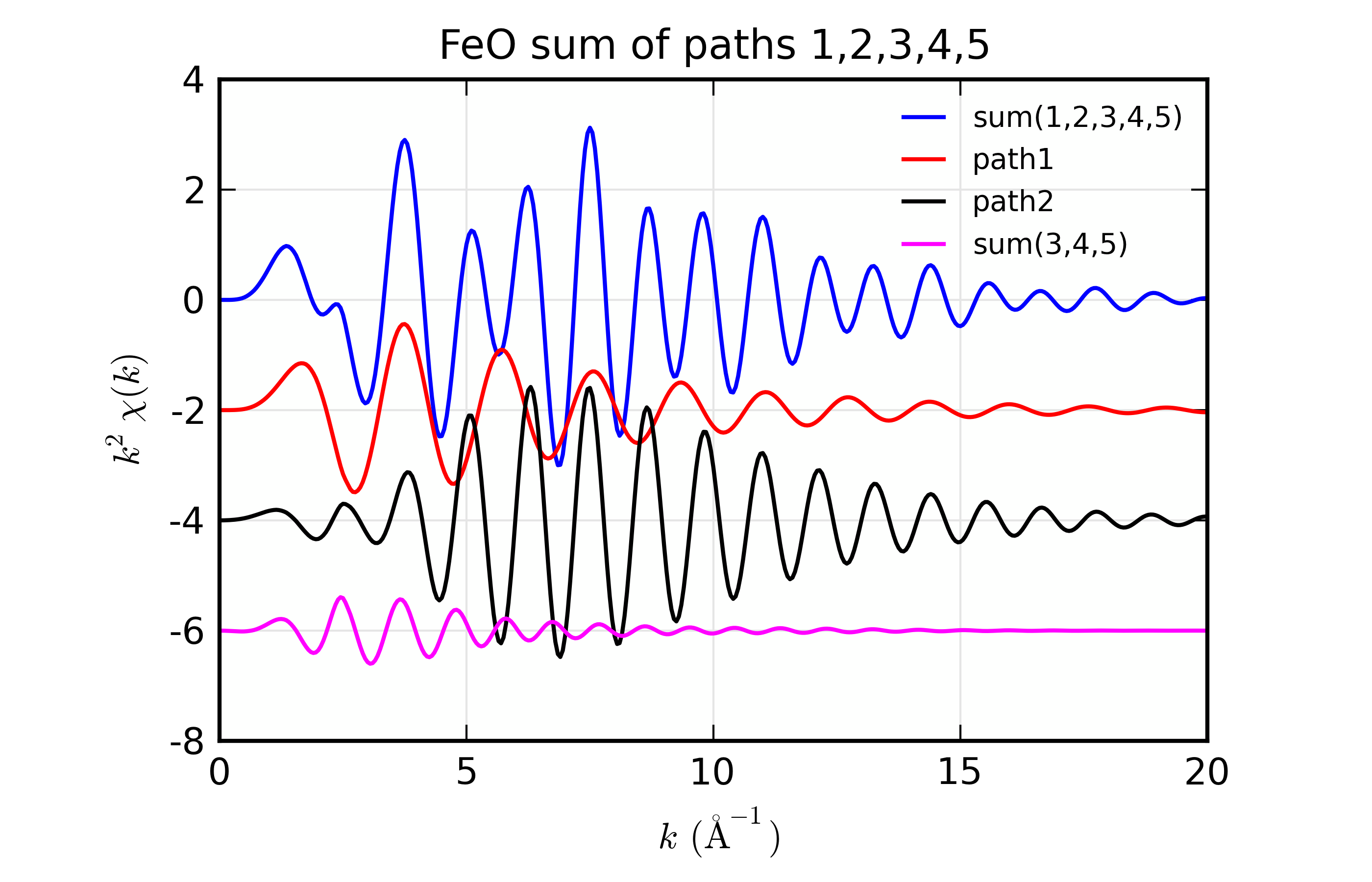

11.7.8. Example: Adding Feff files
Now, we add some Feff files together, applying some path parameters. The example is actually very similar to the one above except that we use ff2chi() to create a \(\chi(k)\) from a list of paths, and put the result into its own group. Thus:
## examples/feffit/doc_feffdat3.lar
# read some paths
path1 = feffpath('feff_feo01.dat')
path2 = feffpath('feff_feo02.dat')
path3 = feffpath('feff_feo03.dat')
path4 = feffpath('feff_feo04.dat')
path5 = feffpath('feff_feo05.dat')
# apply an e0 shift and s02 to all paths:
for p in (path1, path2, path3, path4, path5):
    p.e0  = -0.5
    p.s02 =  0.9
endfor
path1.sigma2 = 0.003
path2.sigma2 = 0.004
path3.sigma2 = 0.006
path4.sigma2 = 0.008
path5.sigma2 = 0.008
mysum = group(label='FeO sum of paths 1,2,3,4,5')
ff2chi([path1, path2, path3, path4, path5], group=mysum)
## now, we can also simply sum paths 3,4,5...
mysum.chi345 = path3.chi + path4.chi + path5.chi
newplot(mysum.k, mysum.chi*mysum.k**2, label='sum(1,2,3,4,5)', show_legend=True,
        ylabel=r'$ k^2\chi(k)$',  title=mysum.label)
plot(path1.k, -2.+path1.chi*path1.k**2, label='path1')
plot(path2.k, -4+path2.chi*path2.k**2, label='path2')
plot(path3.k, -6+mysum.chi345*path3.k**2, label='sum(3,4,5)')
## end examples/feffit/doc_feffdat3.lar
With the result as shown below. Note that we can also make a simple sum of a set of paths, which was done in this example to add the contributions of paths 3, 4, and 5. This works because ff2chi() runs path2chi() for each path to be summed, so that the chi component of the FeffPath group is up to date.
../_images/feffdat_example3.png
Figure 11.7.3 Results for sum of \(\chi(k)\) for list of paths.

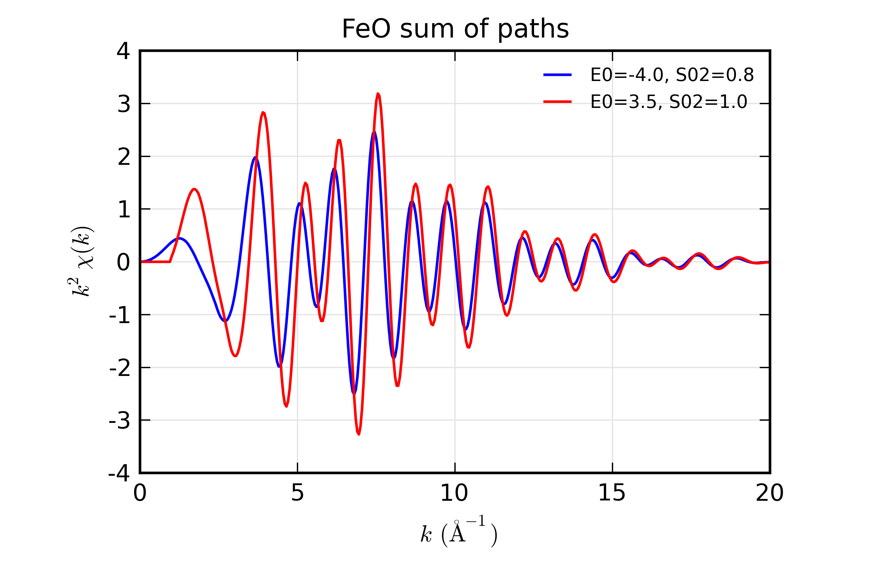

11.7.9. Example: Using Path Parameters when adding Feff files
Using Parameters for modelling data is a key feature of Larch, and if you are modelling XAFS data with Feff, you will want to parameterize Path Parameters, apply them to a set of Paths, and investigate the resulting sum of Paths. This is similar to the examples above, but combines the Parameter concept from the Fitting chapter. In Larch, this looks like:
## examples/feffit/doc_feffdat4.lar
# read some paths
# create a group containing parameters
pars = group(del_e0  = param(-4.0, min=-10, max=10),
             amp = param(0.8, min=0.3, max=1.5))
for p in (path1, path2):
    p.e0  = 'del_e0'
    p.s02 = 'amp'
    p.sigma2 = 0.003
    if p == path2: p.sigma2 = 0.005
endfor
mysum = group(label='FeO sum of paths')
ff2chi([path1, path2], group=mysum, paramgroup=pars)
label='E0=%.1f, S02=%.1f' % (pars.del_e0.value, pars.amp.value)
        label=label, show_legend=True,
        xlabel=r'$ k \rm\, (\AA^{-1})$',
# now change parameter values, re-do sum
pars.del_e0.value = 3.5
pars.amp.value = 1.0
# re-calculate chi for each path with paramgroup set
# then sum the paths ourselves
path2chi(path1, paramgroup=pars)
path2chi(path2, paramgroup=pars)
mysum.chi_alt = path1.chi + path2.chi
plot(mysum.k, mysum.chi_alt*mysum.k**2, label=label)
## end examples/feffit/doc_feffdat4.lar
After reading in the Feff data files, we have created a group pars of Parameters with _math.param(), specifically pars.del_e0 and pars.amp. Then we set the e0 path parameter for each path to the string 'del_e0', and the amp path parameter to 'amp'. We set the sigma2 values to simple numbers, as above.
Now, when running ff2chi(), we give not only a group to put the results in, but also a paramgroup to use as the parameters for evaluating any mathematical expressions we’ve defined for the path parameters. At this point, the strings del_e0 and amp for the path parameters for path 1 and 2 are converted into Parameters and evaluated.
..versionchanged:: 0.9.34
removed _sys.paramGroup, now using fiteval
After plotting the results, we then change the values of the parameters. We could re-run ff2chi(), but we can also just run path2chi() on the paths for which we want to recalculate \(\chi\). Note that we specify the paramgroup to path2chi() here.
../_images/feffdat_example4.png
Figure 11.7.4 Results for making 2 different sums of paths using parameterized Path Parameters
The resulting plot shows the effect of changing \(E_0\) and \(S_0^2\) for a sum of paths. The same result could be shown by just setting the path parameters to the appropriate numerical values, but the use of parameters makes this somewhat more general. As we will see in the next section, the use of parameters also allows us to easily refine their values in a fit of XAFS data to such a sum of paths.
