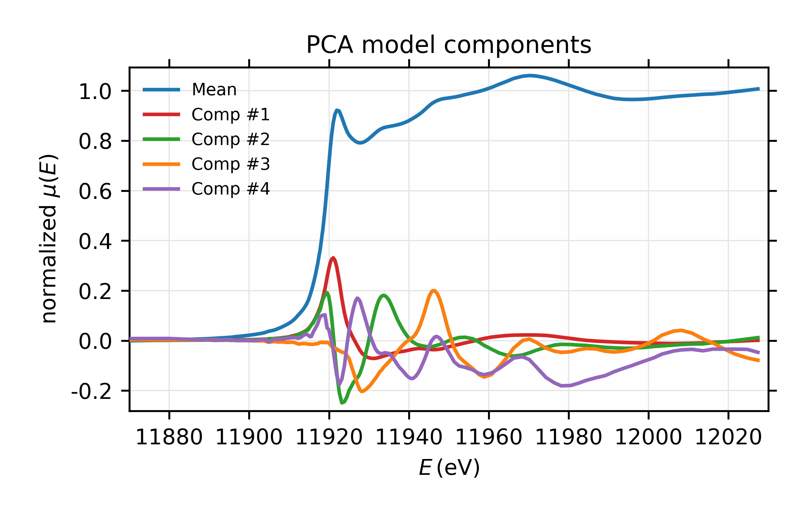

Next, we’re ready to train the PCA model with the collection of standard spectra, so we make a list of groups standards and create a training model that we store in au_pcamodel.
With this PCA model, we can investigate the components and their weights. To be clear, the PCA process first calculates and removes the mean of all the components and then focuses on the variations in the spectra. This is especially helpful for XANES spectra as the mean normalized \(mu(E)\) is almost always larger than the variations. We can then plot the mean and the principal components themselves (in Figure 11.3.1), and the weight of each component (in Figure 11.3.2) to explain the variations in the training set (note that this does not include the mean, and is on a log scale).
../_images/PCA_model_components.png
Figure 11.3.1 Mean and 4 most important components.

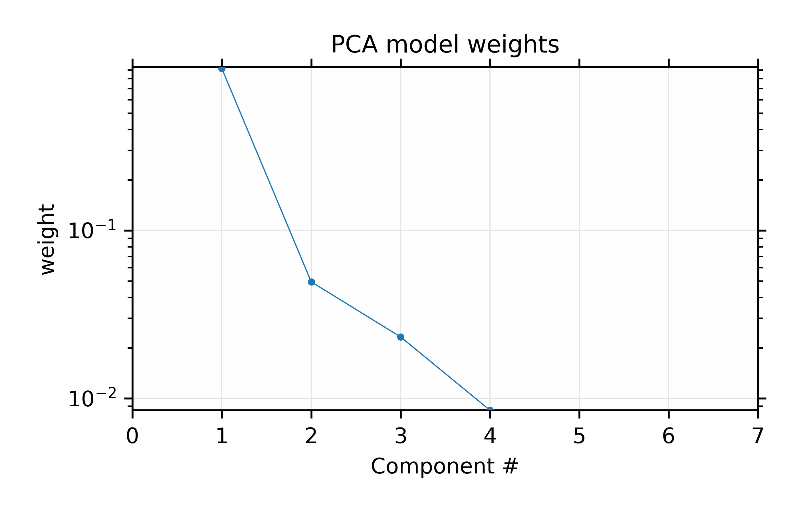

../_images/PCA_model_weights.png
Figure 11.3.2 Fractional weights or variances for the 4 most important components of the Au XANES spectra – not including the mean spectrum.

We also print out the weights of the components which will give:
Comp #  |  Weight   |  Cumulative Total
   1    |  0.91834  |  0.91834
   2    |  0.04938  |  0.96772
   3    |  0.02321  |  0.99093
   4    |  0.00850  |  0.99942
   5    |  0.00058  |  1.00000
   6    |  0.00000  |  1.00000
which shows the values for the weights plotted in Figure 11.3.2 for the principal components. This shows that the first 2 components explain 95% of the variation, and that using 4 components will explain 99.9% of the variation in the data.
