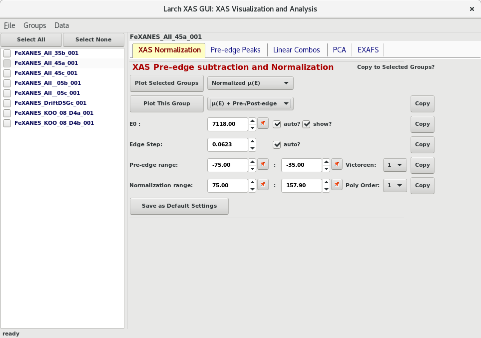

The XAS Viewer GUI includes a simple form for basic pre-edge subtraction, and normalization of XAFS spectra. Figure 5.1 shows the main window for the XAS Viewer program. The left-hand portion contains a list of files (or data groups) that have been read into the program either from individual ASCII column files or Athena Project files. Clicking on the file or group name makes that “the current data group”, while checking the boxes next to each name will select multiple files or group. Buttons at the top of the list of files can be used to “Select All” or “Select None”. In addition, right-clicking on the file list will pop up a menu that allows more detailed selecting of data sets.
../_images/XASViewer_norm_panel.png
Figure 5.1 XASViewer showing the File/Group list on the left-hand side and the the XAFS pre-edge subtraction and normalization panel on the right.

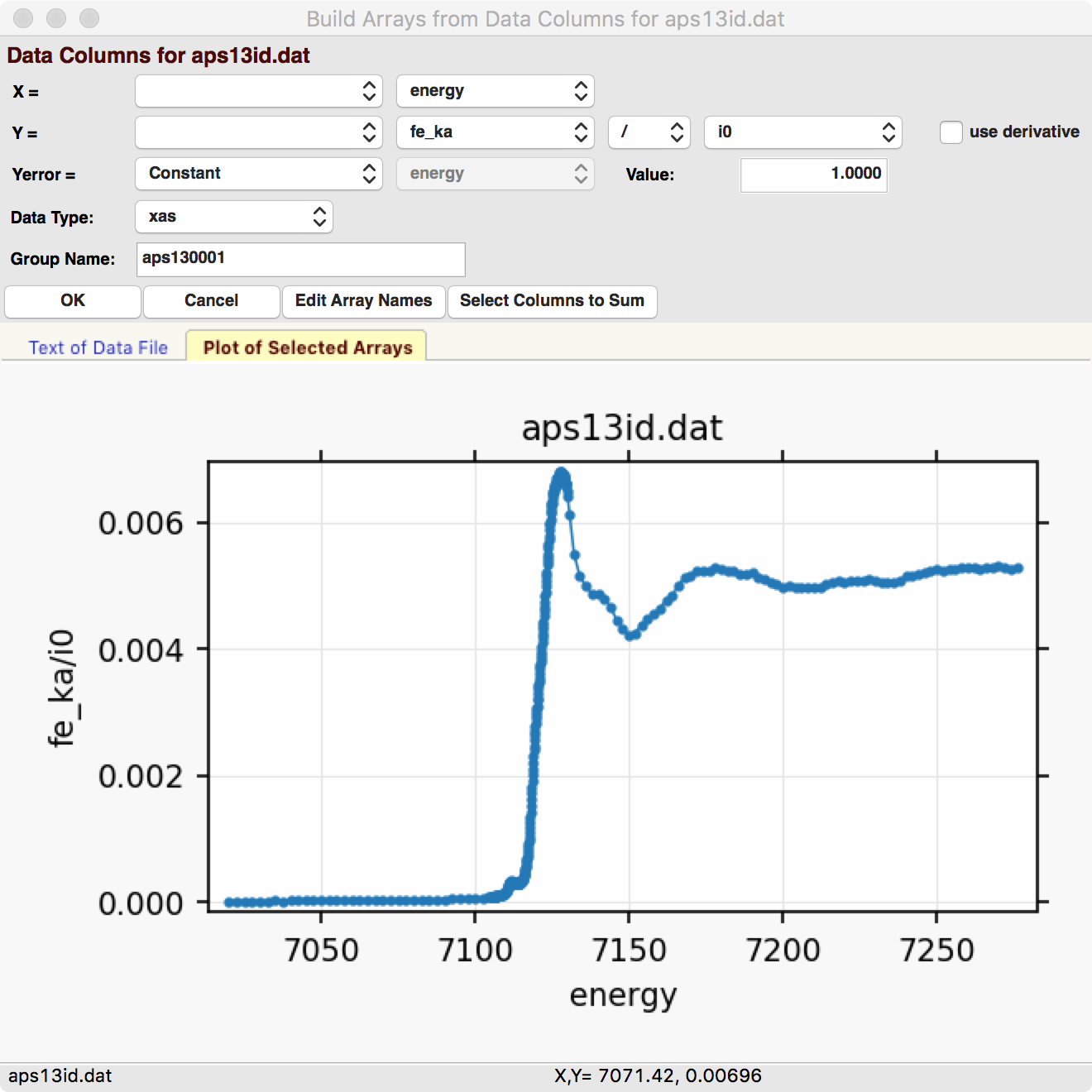

Data groups can be read from plain ASCII data files using a GUI form to help build \(\mu(E)\), or from Athena Project files, as shown in Figure 5.1.1 and Figure 5.1.2. Multiple data groups can be read in, compared, and merged. These datasets can then be exported to Athena Project files, or to CSV files.
../_images/DataImporter.png
Figure 5.1.1 ASCII data file importer.
../_images/AthenaImporter.png
Figure 5.1.2 Athena Project importer.
When reading in raw data, the data importer shown in Figure 5.1.1 will help you build XAFS \(\mu(E)\) from the various columns in your data file. This form wraps some of the routines described in Chapter 8. Currently, this form is somewhat limited in being able to process all data formats, but should be useful for many data sets. If you have trouble reading in your data with XAS Viewer, contact us and we will try to help.

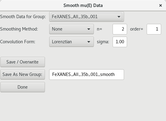

  • smoothing of noisy spectra.

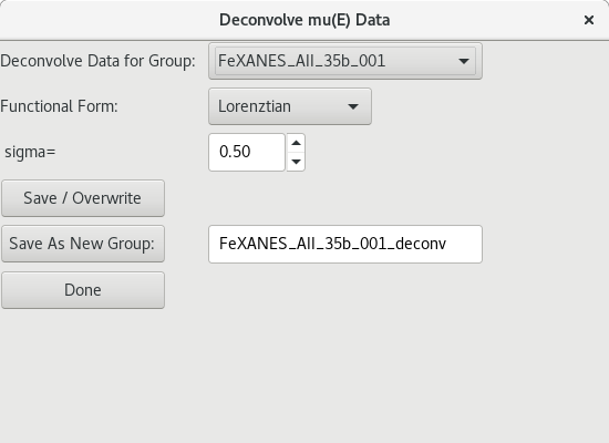

  • de-convolving spectra.

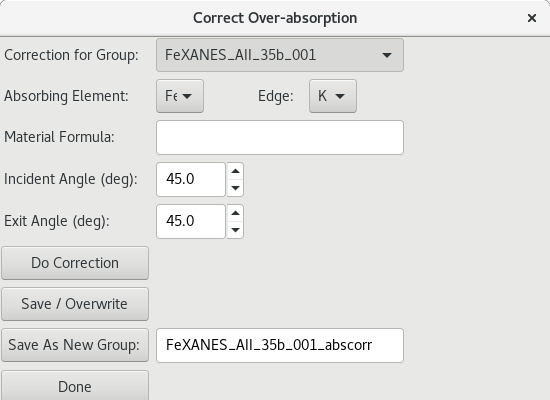

  • correcting over-absorption in fluorescence XANES spectra.

../_images/XASViewer_smooth_dialog.png
Figure 5.2.3 Energy smoothing dialog.
../_images/XASViewer_deconvolve_dialog.png
Figure 5.2.4 Deglitching dialog

../_images/XASViewer_overabsorption_dialog.png
Figure 5.2.6 Over-absortion correction dialog

As above, Figure 5.1 shows the main window for the XAS Viewer program with the right hand side showing the “XAS Normalization” Panel. This panel helps you do pre-edge subtraction and normalization of XAFS data using the pre_edge() function. This processing step is important for getting normalized XAFS spectra that is used for further analysis of both XANES and EXAFS.
From the form, you can plot the data for the current selected group in several ways: Raw \(\mu(E)\), normalized \(\mu(E)\), the derivative \(d\mu(E)/dE\), flattened \(\mu(E)\), or the raw \(\mu(E)\) with the pre-edge line and post-edge normalization curve. You can also set the parameters like \(E_0\) and the edge step and ranges for the pre-edge line and normalization curve. Consult with pre_edge() function for more details on these parameters. You can also plot several selected groups together, and copy processing parameters from one group to another.

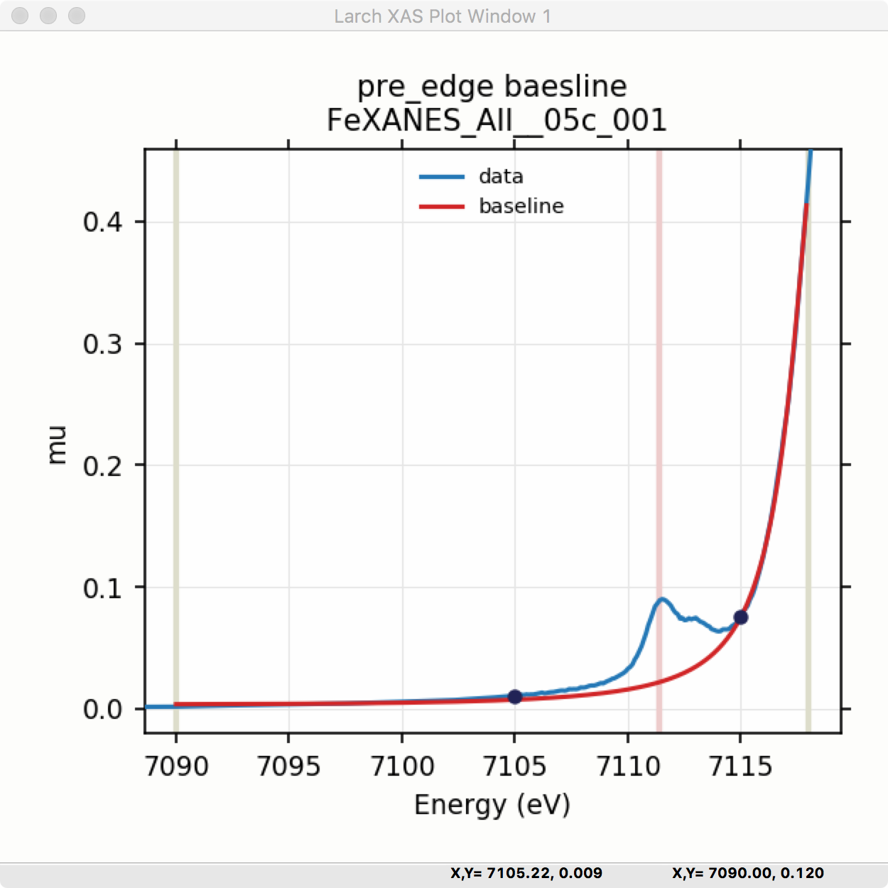

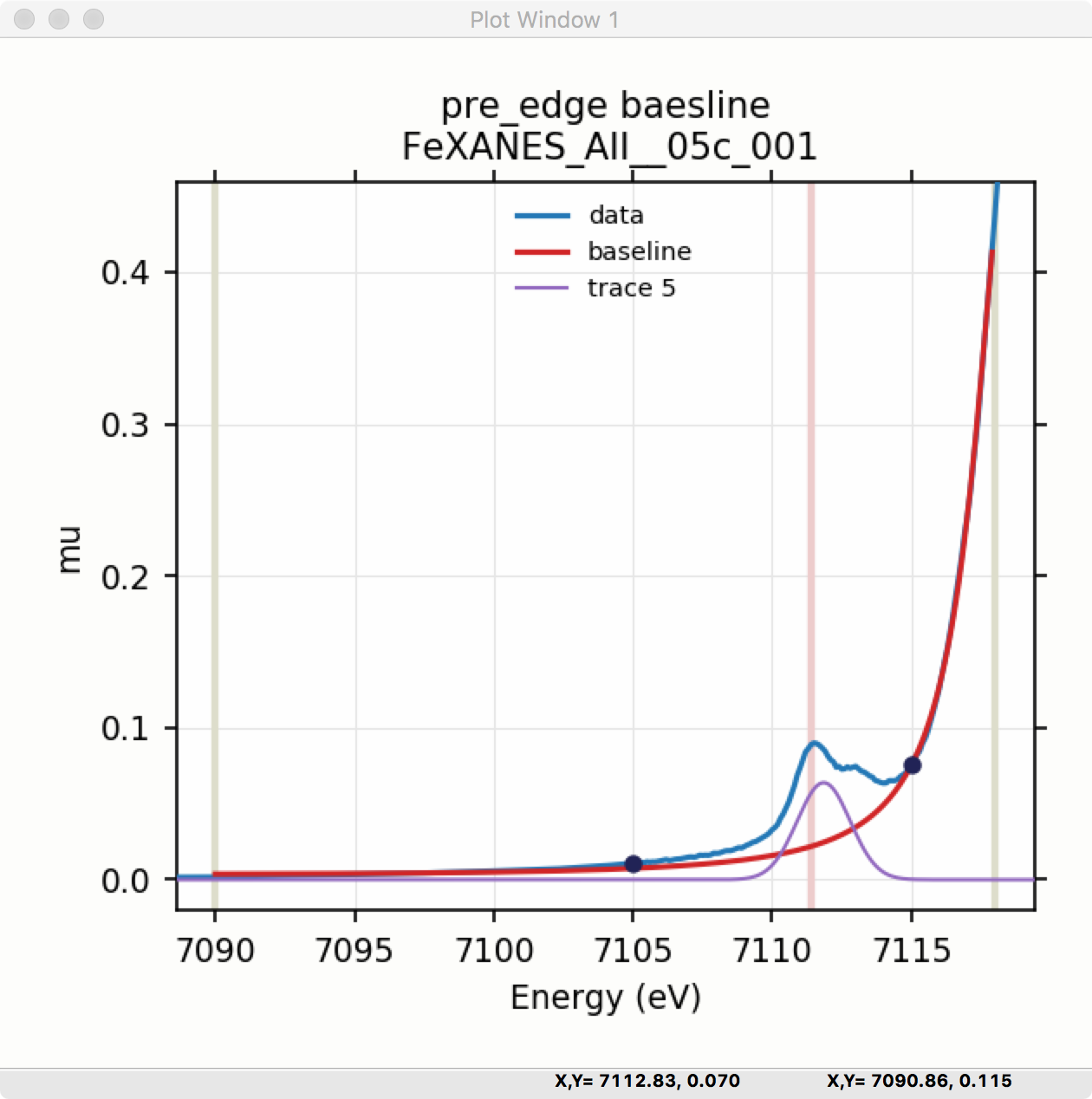

Clicking “Fit baseline” will fit a baseline function and display the plot as shown below. The initial fit may have poorly guessed ranges for the pre-edge peaks and fit range and may require some adjustment. As mentioned above, clicking on the plot will select an energy that can then be transferred to any of the bounds energy using the corresponding pin icon pin on the form.

../_images/XASViewer_prepeaks_baseline_plot.png
Figure 5.4.2 Plot of pre-edge peaks with baseline. The grey vertical lines show the fit range and blue cicrles show the boundaries of the pre-edge peak range ignored in the baseline fit. The pink line shows the centroid of the pre-edge peaks after removal of the baseline.
We will allow the baseline to be refined when fitting the peaks, so it does not need to be modeled perfectly, but it is helpful to get a decent fit to the baseline. Once this baseline is satisfactorally modeled, you can add functions to model the pre-edge peaks themselves. Selecting one of the “Peak Models” (typically Gaussian, Lorentzian, or Voigt) will show a new tab in the “model components area” in the lower part of the form. Since the baseline consists of a Lorentzian curve and a line, there will now be 3 tabs for the 3 components of the pre-edge peak model. The background peak and the background line will have tabs labeled bp_ and bl_, respectively, and the added Gaussian curve will be labeled gauss1_, as shown in Figure 5.4.3, which shows the form with 1 Gaussian peak, and the two-component baseline. You can add more peaks by repeatedly selecting the peak type from the drop-down menu labeled Add Component.

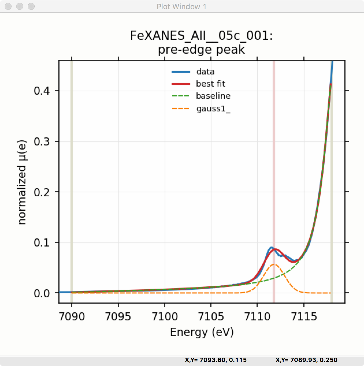

Once the model function is defined and initial parameters values set, clicking the Fit Model button will perform the fit. This will bring up a Fit Result form shown in Figure 5.4.5 and an initial plot of the data and fit as shown in Figure 5.4.6.
The Fit Result panel contains goodness-of-fit statistics and parameter values and uncertainties (or standard error). At the top portion of the form, you can save a model to be read in and used later or export the data and fit components to a simple column-based data file. You can also view the fit goodness-of-fit statistics for the fit. There are also some options and a button for the plot of data and fit.
In the lower portion of the form, you can read the values and uncertainties for the fitting parameters and for a number of derived parameters, including fit_centroid that is the (area-weighted) centroid of the functions that comprise the pre-edge peaks (not including the baseline) and the full-width-at-half-maximumn and height of each of the peaks (note that amplitude represents the area of the unit-normalized peak and height represents the maximum height for a peak). You can click on the button labeled “Update Model with these Values” to put these best-fit values back into the starting values on the main form. In addition, clicking on any variable parameter to show it correlations with other variables. Note that the baseline parameters are refined (by default) in the fit to the pre-edge peaks.
../_images/XASViewer_prepeaks_fitresult1_form.png
Figure 5.4.5 Fit result frame for Pre-edge peak fit for a fit with 1 Gaussian.
../_images/XASViewer_prepeaks_fitresult1_plot.png
Figure 5.4.6 Pre-edge Peak data and best-fit with 1 Gaussian and baseline.

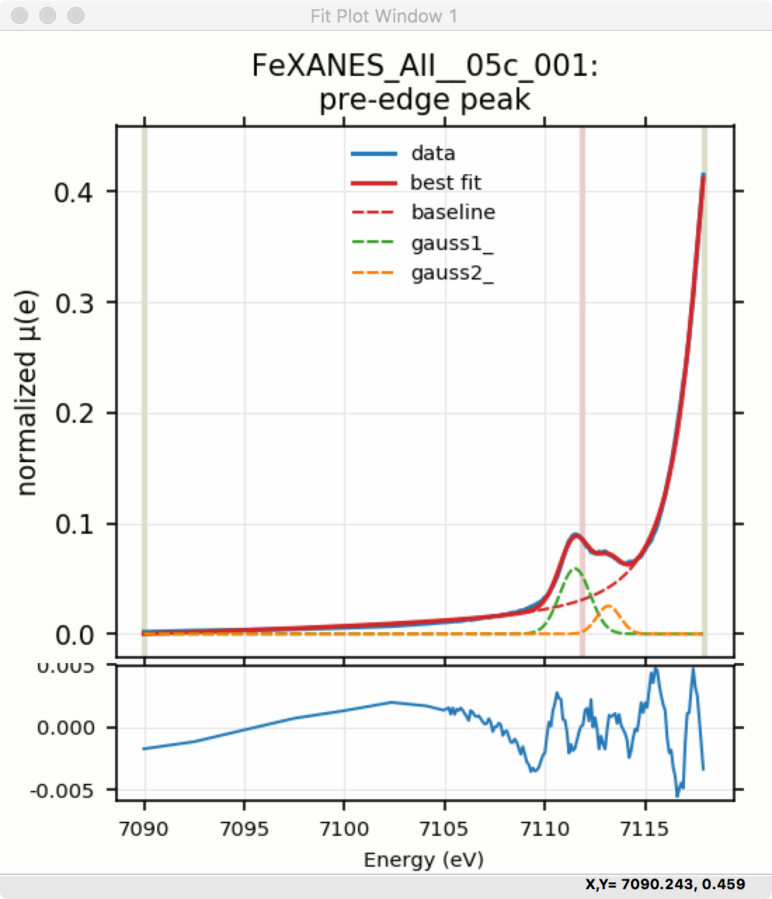

Adding a second Gaussian (and maybe even a third) will greatly help this fit. If we add another Gaussian peak component to the fit model using the drop-down menu of “Add component:”, select initial values for that second Gaussian before, and re-run the fit, we’ll see the Fit Results form and plot as shown in Figure 5.4.8 and Figure 5.4.9.
../_images/XASViewer_prepeaks_fitresult2_form.png
Figure 5.4.8 Fit result frame for Pre-edge peak fit for a fit with 2 Gaussians.
../_images/XASViewer_prepeaks_fitresult2_plot.png
Figure 5.4.9 Pre-edge Peak data and best-fit with 2 Gaussians and baseline.

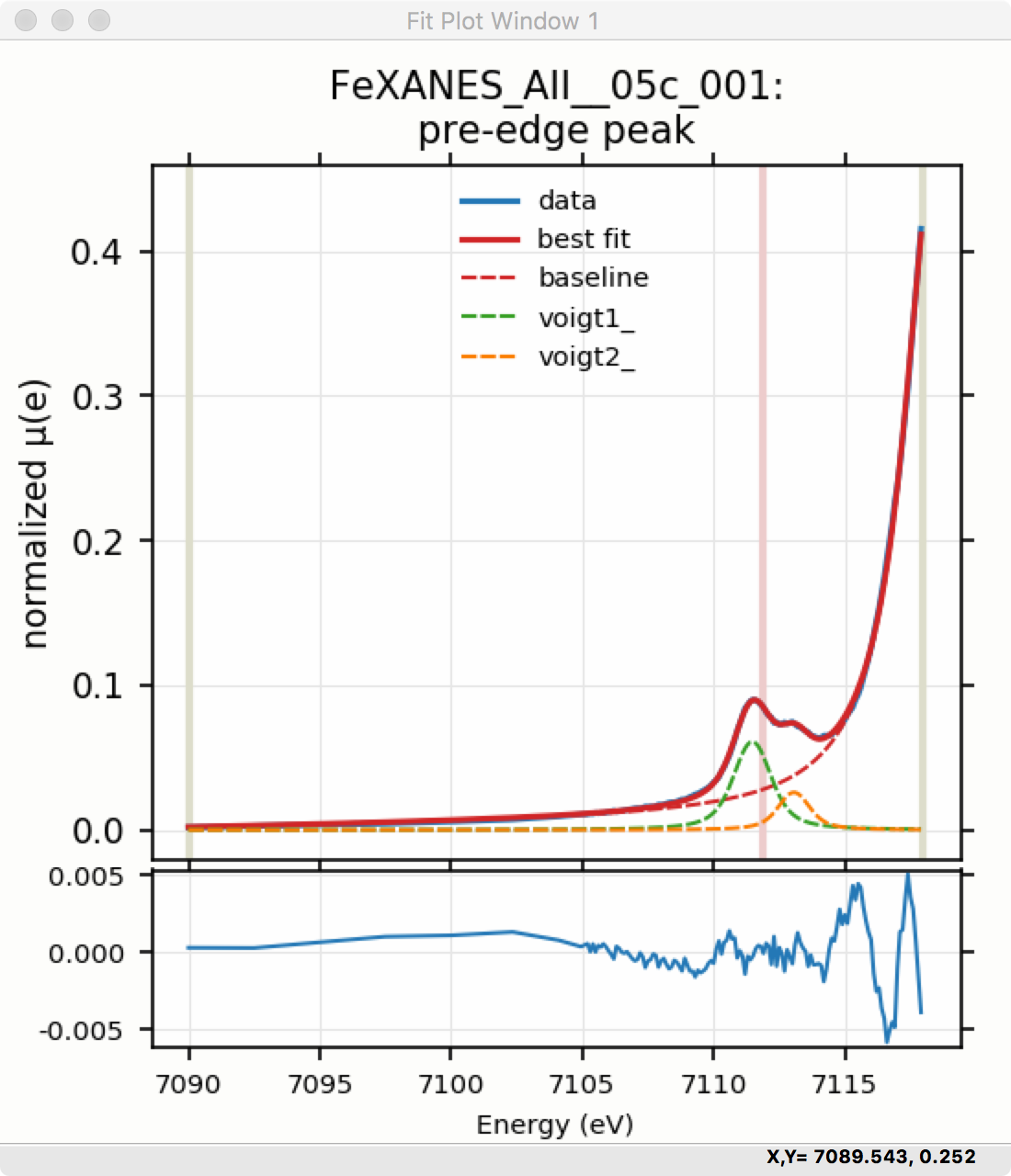

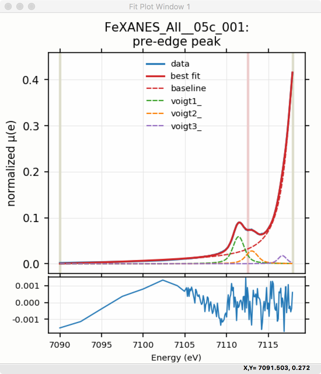

To continue with the analysis of the data in this example, Figure 5.4.9 shows that the fit residual still has significant structure, indicating that either another peak should be included or that the Gaussian peak shape is not a good model for these peaks. In fact, using 2 Voigt functions significantly improves the fit, as shown in Figure 5.4.10, with reduced \(\chi^2\) dropping from 4.4e-6 to 3.2e-6 and similar improvements in the AIC and BIC statistics. To do this, the two Gaussian peaks were deleted and two Voigt peaks added, with initial values selected with the “two click method”.
The fit of the pre-edge peaks is visibly improved but a systematic variation in the residual is still seen at the high energy side of the pre-edge peaks. Adding a third Voigt function at around 7117 eV improves the fit even more as shown in Figure 5.4.11. As shown, the scale of the residual is now 0.001, ten times better than the scale of the fit with 1 peak shown in Figure 5.4.7, and shows much less systematic structure. In addition, all the fit statistics are improved despite now using 14 variables: reduced \(\chi^2\) becomes from 5.1e-7, AIC is -1957 and BIC is -1917.
../_images/XASViewer_prepeaks_fitresult3_plot.png
Figure 5.4.10 Fit result frame for Pre-edge peak fit for a fit with 2 Voigt functions plus the baseline.
../_images/XASViewer_prepeaks_fitresult4_plot.png
Figure 5.4.11 Pre-edge Peak data and best-fit for a fit with 3 Voigt functions plus the baseline.
