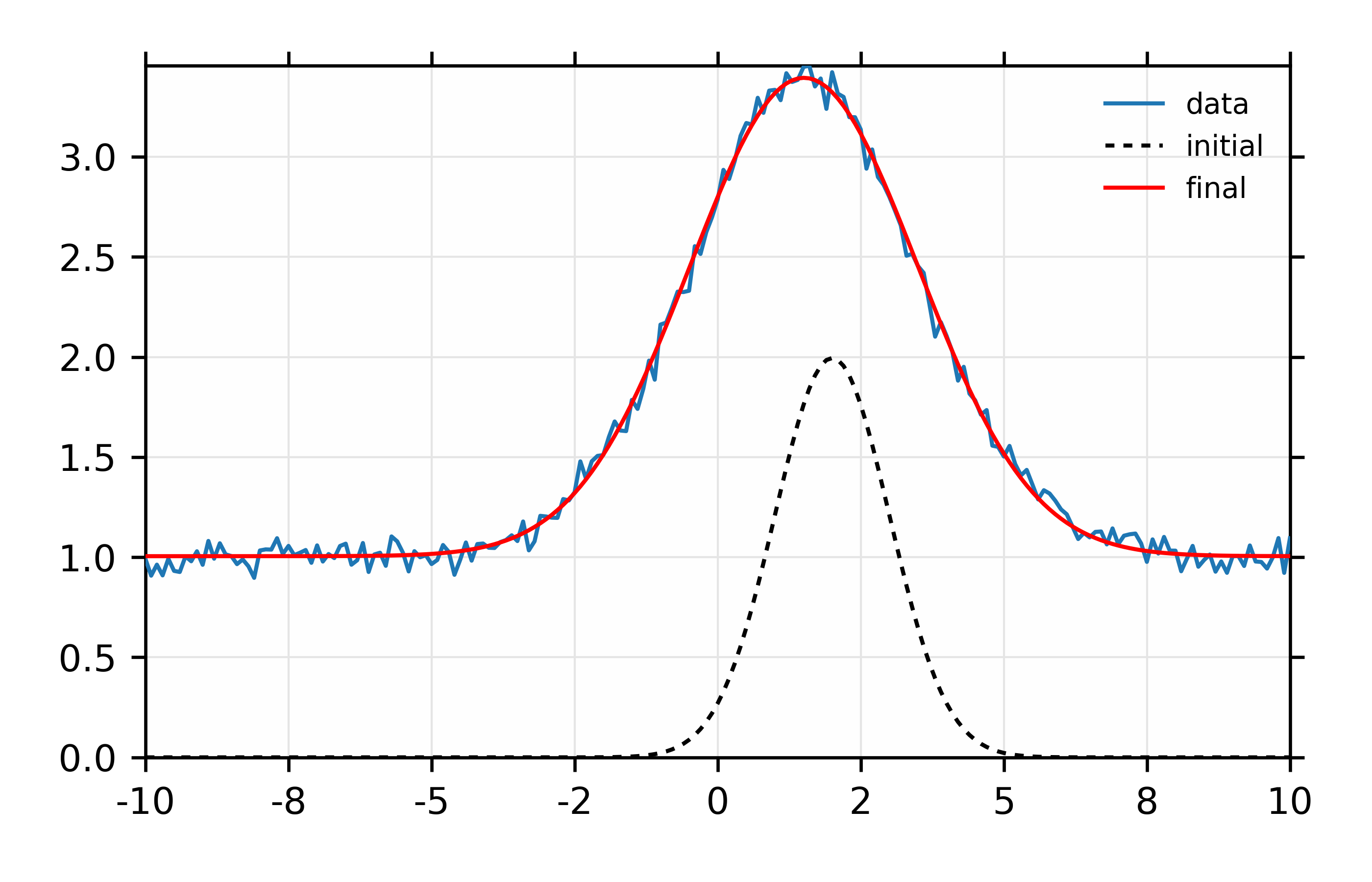

And the plot of data and fit will look like this:
../_images/fit_example1.png
Figure 10.6.1 Simple fit to mock data

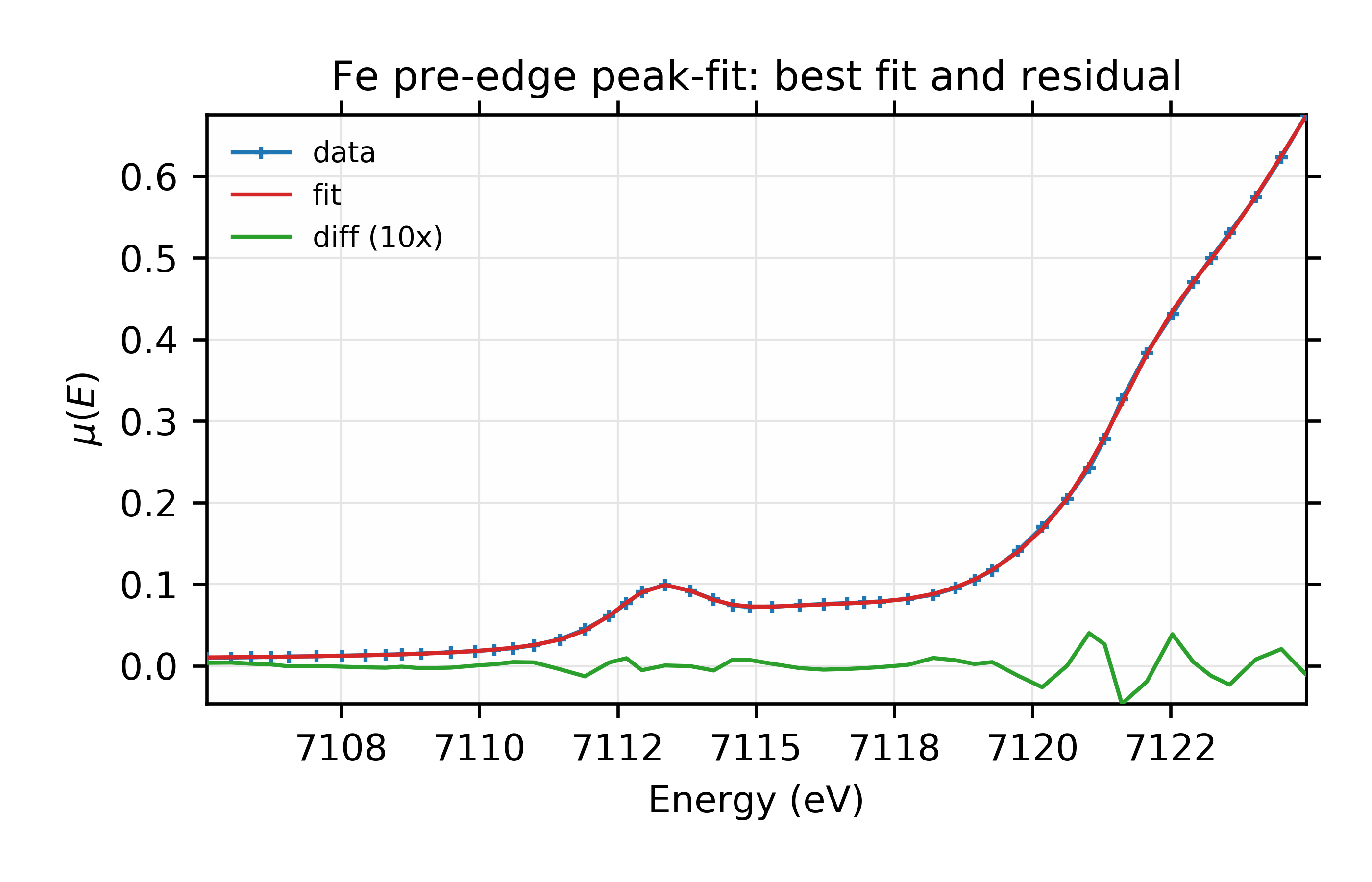

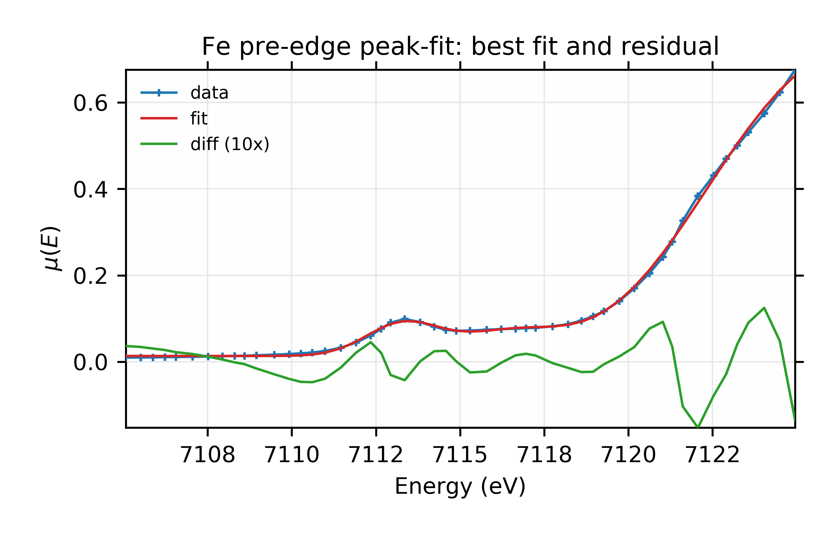

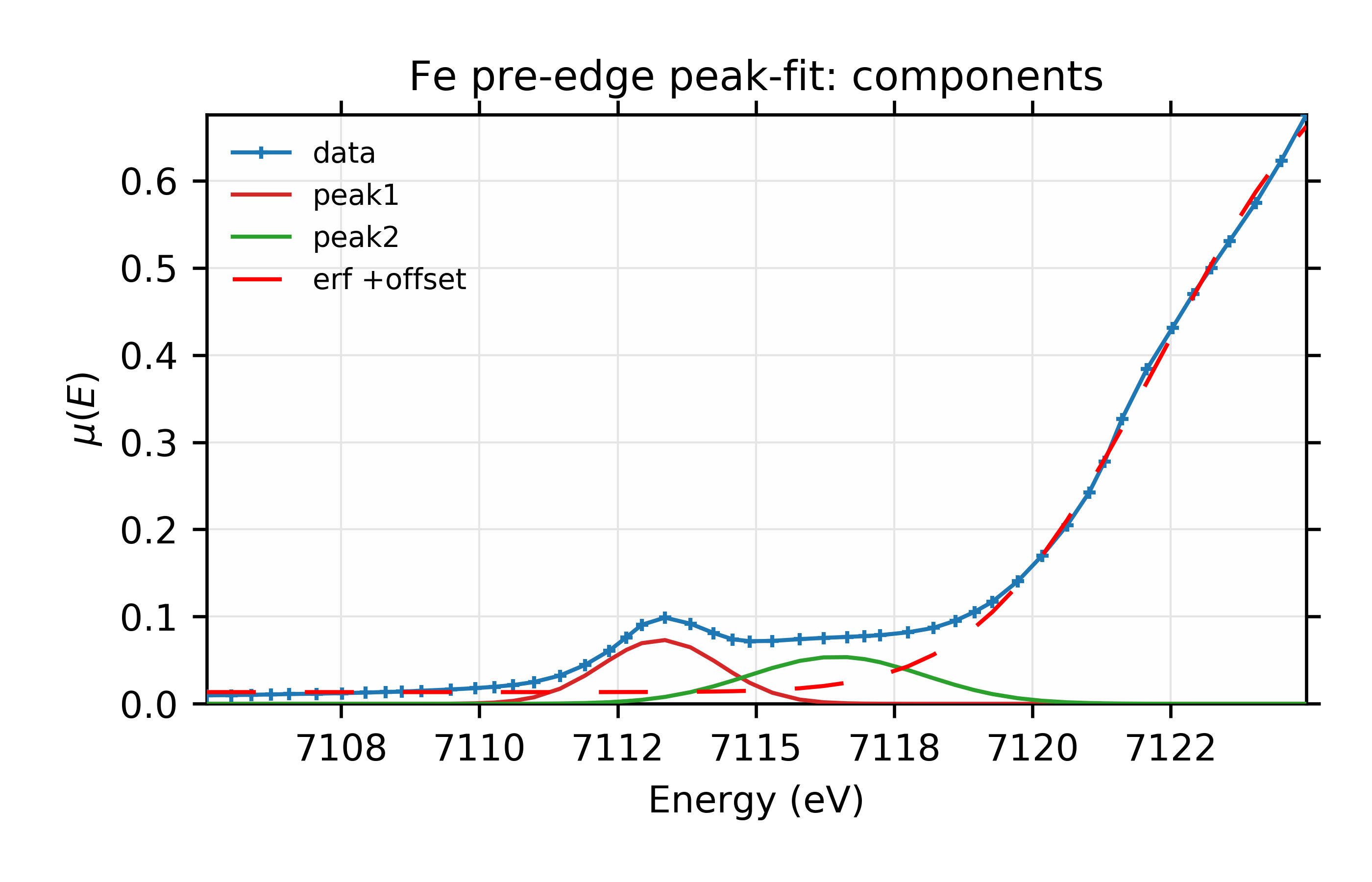

and the plots of the resulting best-fit and components look like these:
../_images/fit_example2a1.png
Figure 10.6.2 Fit to Fe K-edge pre-edge and edge with 2 Gaussian functions and an Error function. Data, fit, and residual.
../_images/fit_example2a2.png
Figure 10.6.3 Fit to Fe K-edge pre-edge and edge with 2 Gaussian functions and an Error function. Fit and individual components.
and we see the fit is pretty good.

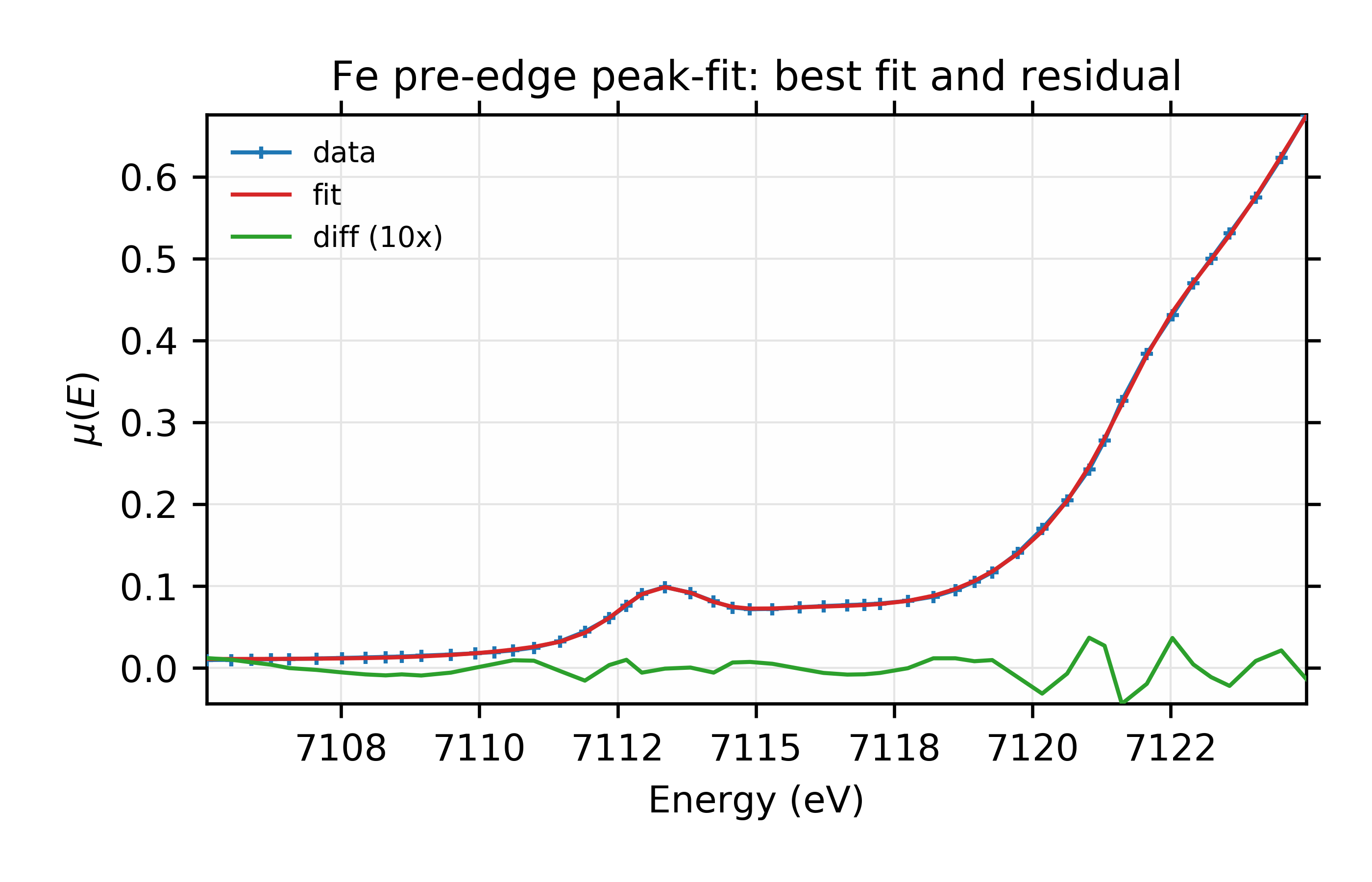

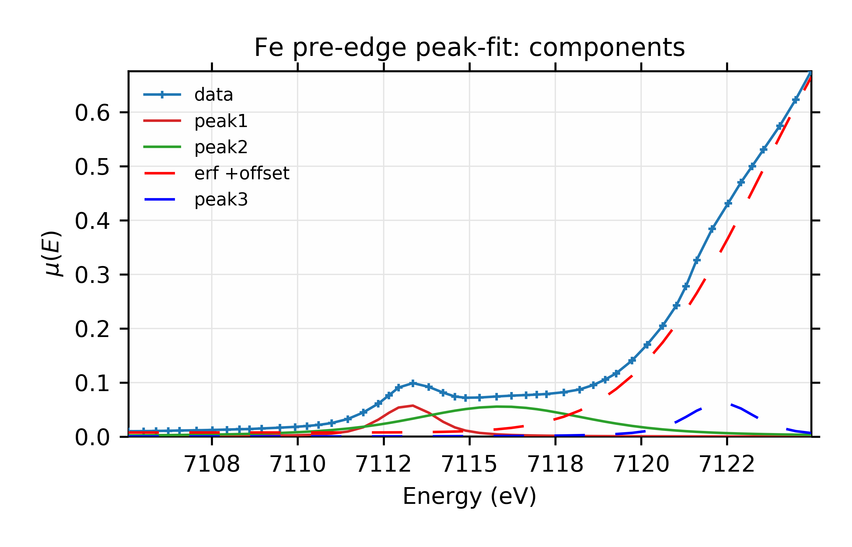

../_images/fit_example2b1.png
Figure 10.6.4 Fit to Fe K-edge pre-edge and edge with 3 Gaussian functions and an Error function. Data, fit, and residual.
../_images/fit_example2b2.png
Figure 10.6.5 Fit to Fe K-edge pre-edge and edge with 3 Gaussian functions and an Error function. Fit with individual components.

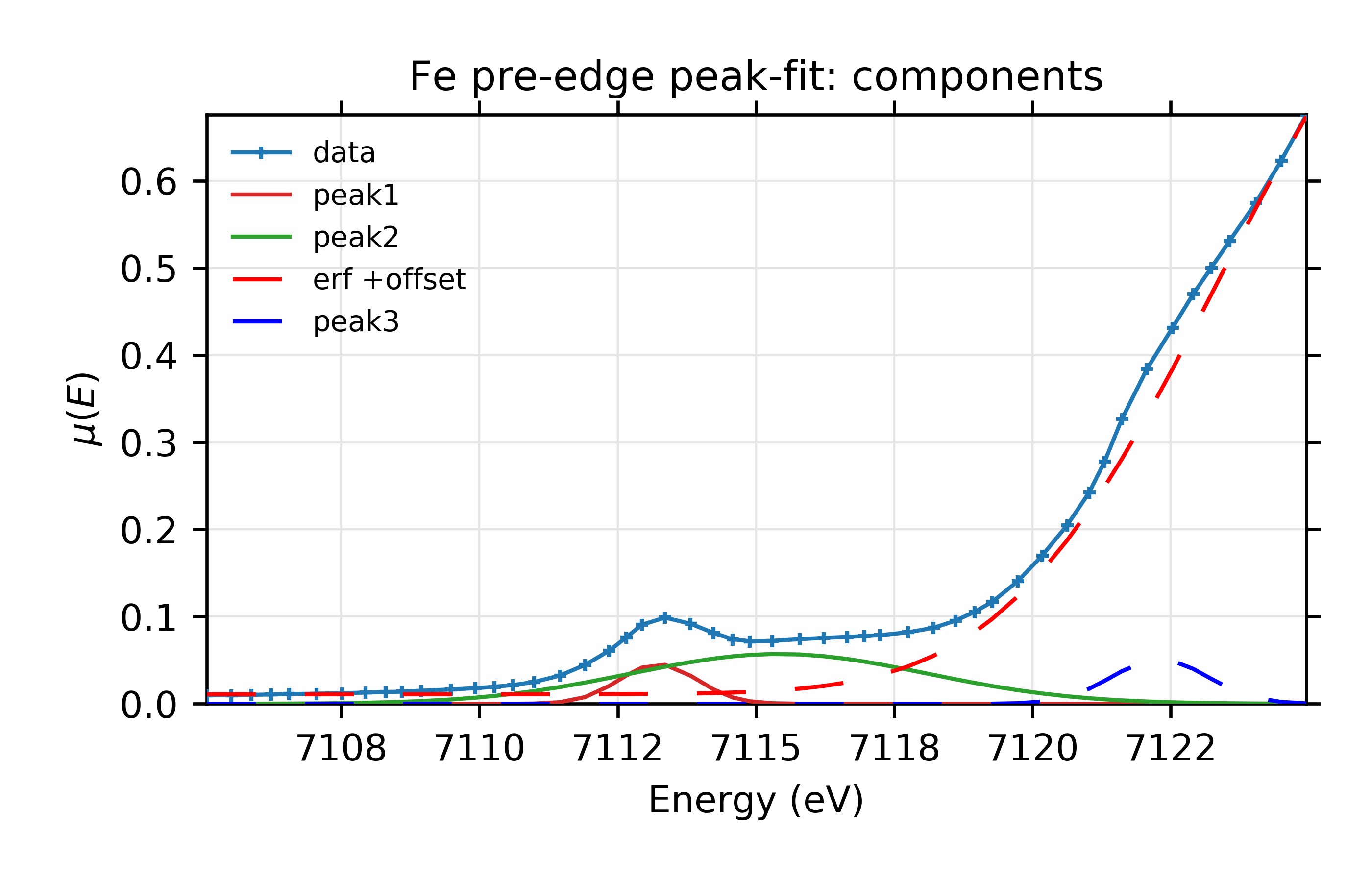

Finally for this example, we can replace the Gaussian peak shapes with other functional forms. To use the Voigt function shown in the previous section, we simply change make_models() to use:
p1 = pars.amp1 * voigt(data.e, pars.cen1, pars.wid1)
p2 = pars.amp2 * voigt(data.e, pars.cen2, pars.wid2)
p3 = pars.amp3 * voigt(data.e, pars.cen3, pars.wid3)
The fit report now reads:
[[Fit Statistics]]
    # function evals   = 476
    # data points      = 51
    # variables        = 13
    chi-square         = 9.2875e-05
    reduced chi-square = 2.4441e-06
    Akaike info crit   = -648.02
    Bayesian info crit = -622.91
[[Variables]]
    amp1:      0.14657959 +/- 0.012760 (8.71%) (init= 0.25)
    amp2:      0.44536523 +/- 0.035916 (8.06%) (init= 0.25)
    amp3:      0.19354556 +/- 0.032364 (16.72%) (init= 0.5)
    cen1:      7113.23780 +/- 0.020989 (0.00%) (init= 7113.25)
    cen2:      7115.91312 +/- 0.134712 (0.00%) (init= 7116)
    cen3:      7122.32066 +/- 0.037577 (0.00%) (init= 7122)
    erf_amp:   0.48986689 +/- 0.023086 (4.71%) (init= 0.5)
    erf_cen:   7123.58055 +/- 0.227490 (0.00%) (init= 7123.5)
    erf_wid:   0.22831037 +/- 0.008305 (3.64%) (init= 0.5)
    off:       0.49735544 +/- 0.023143 (4.65%) (init= 0.5)
    wid1:      0.52826663 +/- 0.027231 (5.15%) (init= 0.6)
    wid2:      1.67565399 +/- 0.093190 (5.56%) (init= 1.2)
    wid3:      0.64297551 +/- 0.047200 (7.34%) (init= 1.2)
and we see that the already very low \(\chi^2\) reduces by another 10%, and improvements of the two information criteria. which suggests a real improvement. For completeness, the plots from this fit look like this:
../_images/fit_example2c1.png
Figure 10.6.6 Fit to Fe K-edge pre-edge and edge with 3 Voigt functions and an Error function. Data, fit, and residual.
../_images/fit_example2c2.png
Figure 10.6.7 Fit to Fe K-edge pre-edge and edge with 3 Voigt functions and an Error function. Fit with individual components.
It’s difficult to see a dramatic difference in fit quality for this data, but the ability to explore fitting with different lineshapes like this is still a useful test of the robustness of the fit.

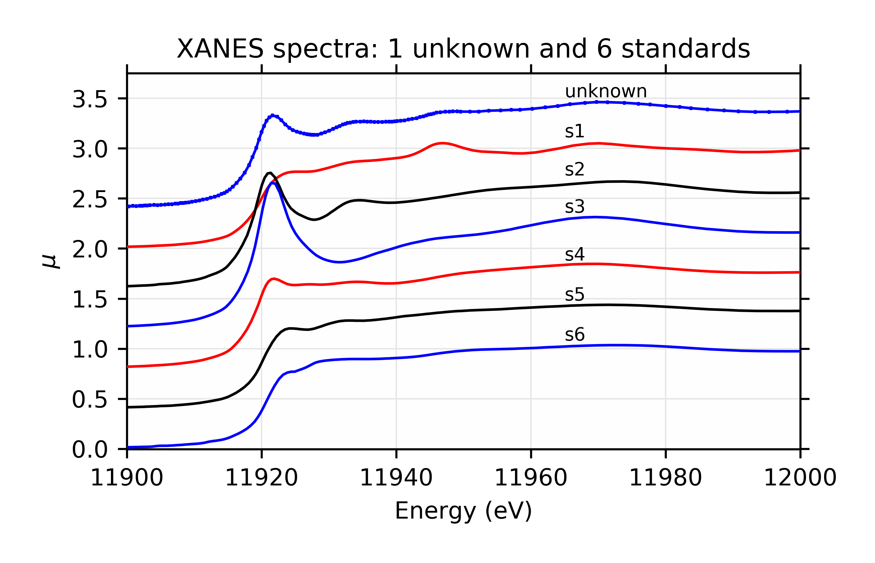

This example is quite a bit simpler than the previous one, though worth an explicit example. Here, we fit a XANES spectra as a linear combination of two other spectra. This approach is often used to compare an unknown spectra with a large selection of candidate model spectra, taking the result with lowest misfit statistics as the most likely results. Though this method should be used with some caution, it is a standard and very simple approach to XANES analysis.
The example here is borrowed from Bruce Ravel’s data and tutorials, and based on the work published by [Larch_1], The goal here is not to repeat the whole of that analysis, but to present the mechanics of the fitting approach. Essentially, we’re asserting that a particular measured spectrum is made of a linear combination of 2 or more other spectra. We have a set of candidate model spectra, and we’re going to try to determine both which of those model spectra combine to match the measured one. Here we will simply assert that all the spectra are aligned in the ordinate and that they are normalized in some reproducible way so that there are essentially no artefacts or systematic problems in the ‘x’ or ‘y’ values of the data.
For the example here, the spectra are held in individual ASCII data files, which we’ll call unknown.dat for the unknown spectrum and s1.dat, s2.dat, …, s6.dat for the spectra on 6 different standards. It is not important for the discussion here what these spectra represent, but they are XANES data taken at the Au L3 edge on various Au compounds.
A visual inspection of the spectra (see Figure 10.6.8) suggests that s2 is probably a major component of the unknown, though the peak around 11950 eV is a feature that only s1 has, so it too may be an important component.
../_images/fit_example3a.png
Figure 10.6.8 Linear Combination Fit of gold XANES in cyanobacteria, after [Larch_1]. Components used for linear combinations.
../_images/fit_example3b.png
Figure 10.6.9 Linear Combination Fit of gold XANES in cyanobacteria, after [Larch_1]. Fit and residual with components s1 and s2.
To quantitatively fit these spectra, we read in all the data, and then create a single group dat that will contain all the data we need. It turns out (and a common issue for XAFS data), the scans here do not have identical energy values, so we both select a limited energy range, and interpolate the standards onto the energy array of the unknown, and put all these spectra into a single group:

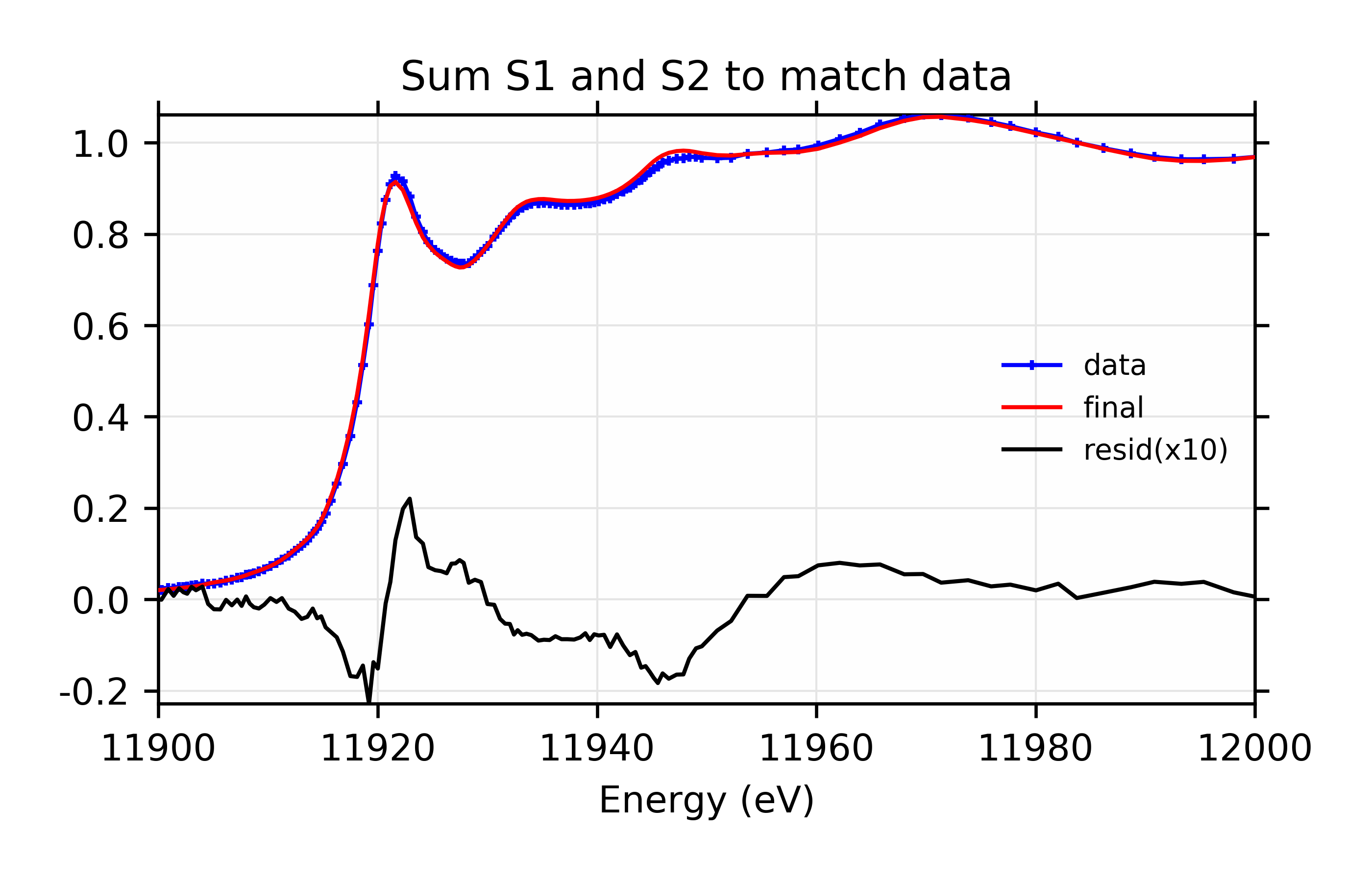

The initial fit to the unknown spectrum with spectra s1 and s2 looks like this:
## examples/fitting/doc_example3/fit1.lar
run('ReadData.lar')
# create a parameter group for the fit:
params = group(amp1 = param(0.5, min=0, max=1),
               amp2 = param(0.5, min=0, max=1),
               amp3 = param(0.0, min=0, max=1),
               amp4 = param(0.0, min=0, max=1),
               amp5 = param(0.0, min=0, max=1),
               amp6 = param(0.0, min=0, max=1))
# define objective function for fit residual
def sum_standards(pars, data):
    return (pars.amp1*data.s1 + pars.amp2*data.s2 + pars.amp3*data.s3 +
            pars.amp4*data.s4 + pars.amp5*data.s5 + pars.amp6*data.s6 )
#enddef
def resid(pars, data):
    return (data.mu - sum_standards(pars, data))/data.eps
#enddef
# set model here: Amp1 is free,
# Amp2 is constrained to be 1 - Amp1
params.amp1.vary = True
params.amp2.expr = '1 - amp1'
# set uncertainty in data that we'll use to scale the returned residual
data.eps  = 0.001
# perform fit
result = minimize(resid, params, args=(data,))
fit = sum_standards(params, data)
print fit_report(result)
plot(data.energy, data.mu,   label='data', color='blue', marker='+',
     markersize=5, show_legend=True, legend_loc='cr', new=True,
     xlabel='Energy (eV)', title='Sum S1 and S2 to match data',
     xmin=11900, xmax=12000)
plot(data.energy, fit,  label='final', color='red')
plot(data.energy, 10*(data.mu-fit),  label='resid(x10)', color='black')
## end of examples/fitting/doc_example3/fit1.lar

and the result for this fit is shown in Figure 10.6.8. This demonstrates the use of simple constraints for Parameters in fits: we’ve used an algebraic expression to ensure that the weights for the two components in the fit add to 1.
The fit here is not perfect, and we suspect there may be another standard as a component to the fit. But at this point, we have several candidate spectra, and a pretty good starting fit, so the main questions are

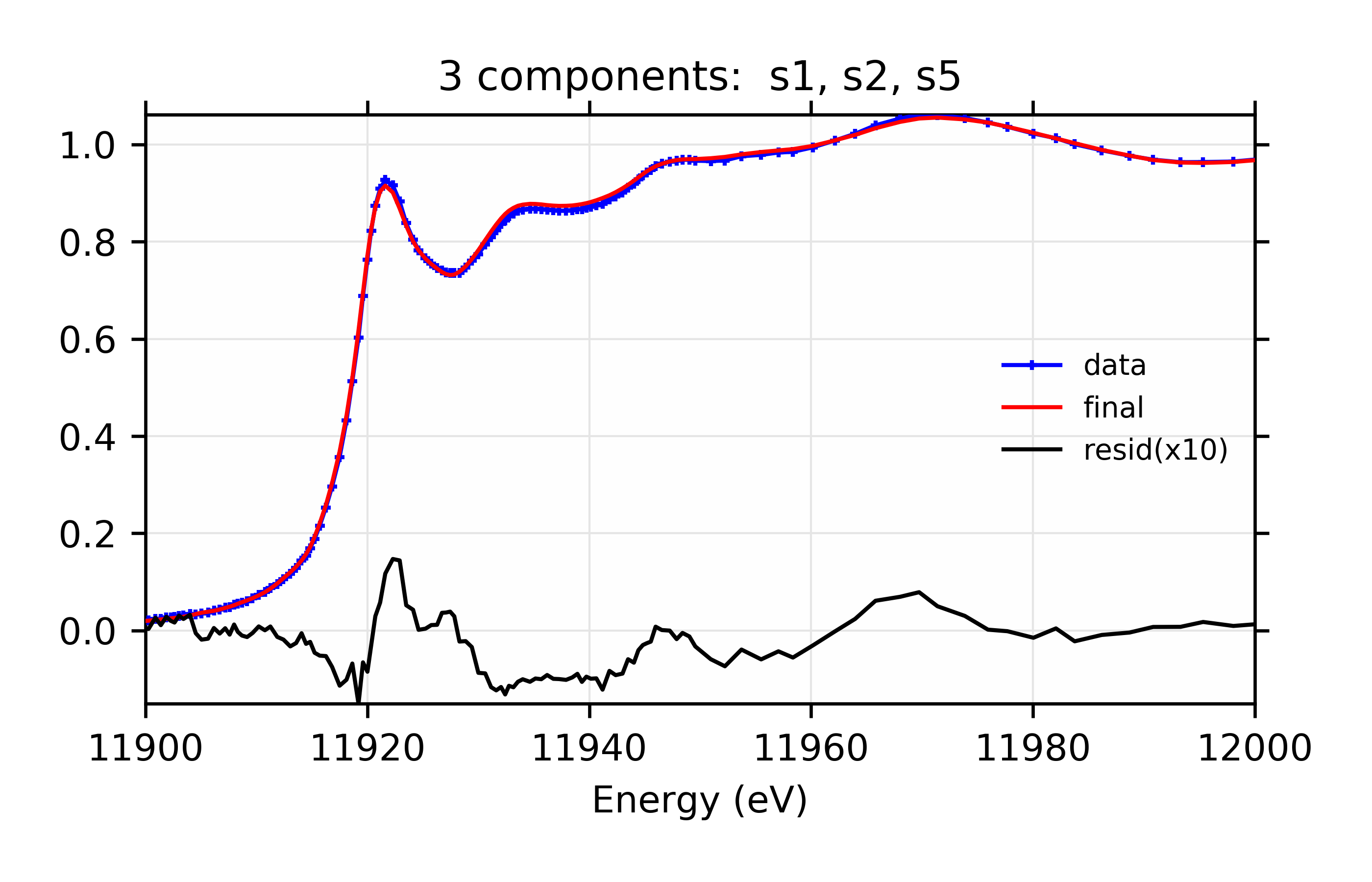

print 'Best Fit:  ', best_params.note
# NOTE!  set paramGroup to best_params to ensure
#        that constraintes are properly evaluated
print fit_report(best_result)
make_plots(best_params, data)
## end of examples/fitting/doc_example3/fit2.lar
There are several points worth noting here:
  1. We make a new copy of the Parameter Group for each fit – this way we can (with some care) switch back and forth between fitting models. Note that we add the non-Parameter note member to this group that give a brief description of the fit. Of course, we could add anything else we wanted.
  2. We set amp1.vary and amp2.vary to True and set one of the other amplitude parameter’s expression to 1 - amp1 - amp2 to impose the desired constraint.
  3. The loop over Parameter groups runs the fit for each set of Parameters, and checks for the lowest value of chi_reduced, aic, and bic.

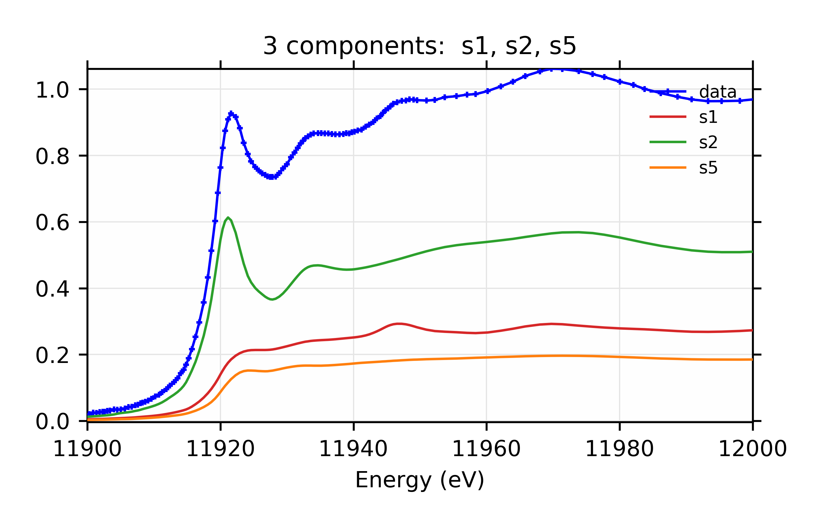

The output of running this gives:

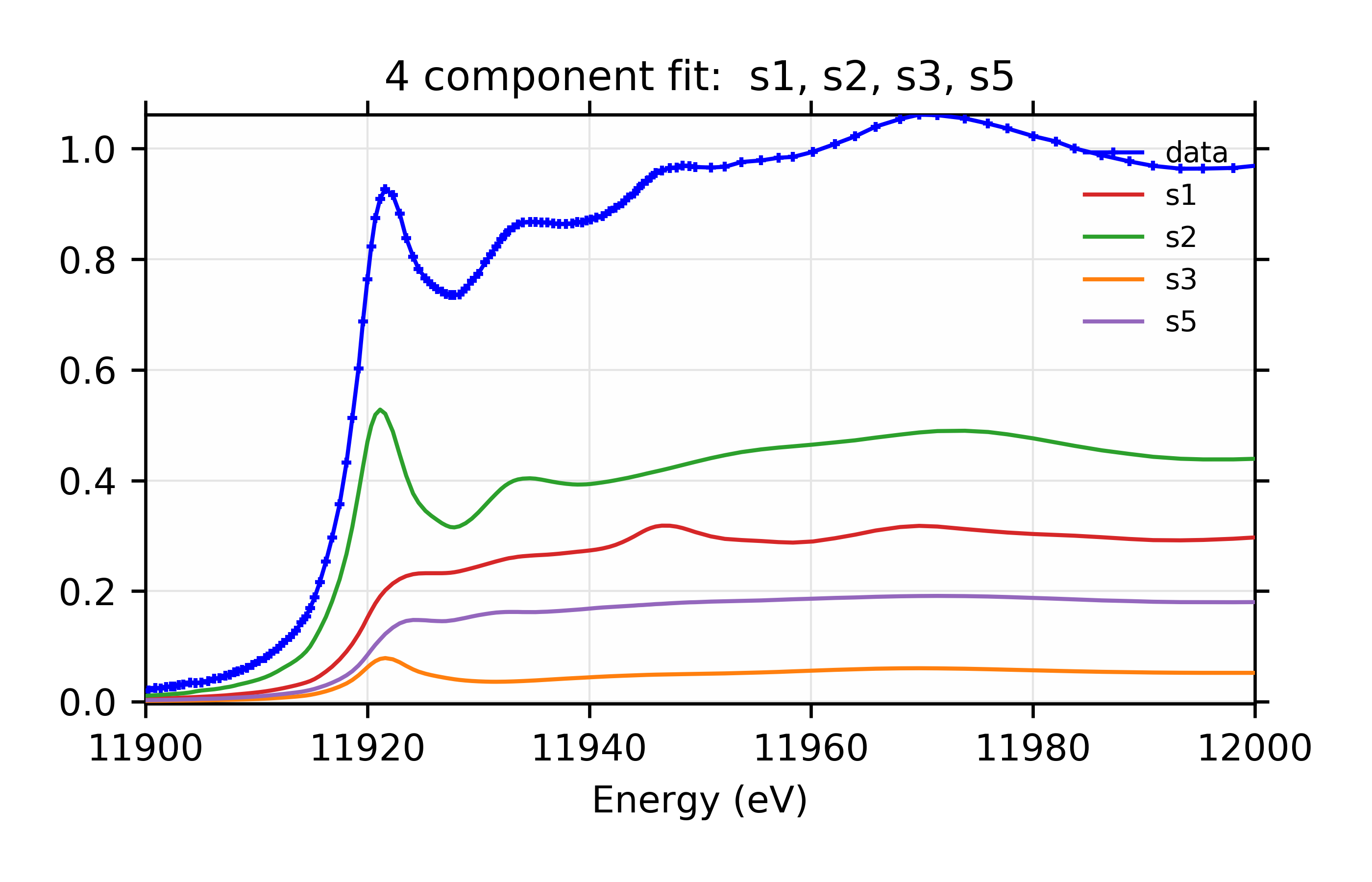

chi_reduced |  A I C  |  B I C | Notes
     58.7   |  652.7  |  655.8 |  2 components:  s1, s2
     40.2   |  592.9  |  599.1 |  3 components:  s1, s2, s3
     37.2   |  580.6  |  586.7 |  3 components:  s1, s2, s4
     32.1   |  557.2  |  563.4 |  3 components:  s1, s2, s5
     37.2   |  580.6  |  586.8 |  3 components:  s1, s2, s6
Best Fit:   3 components:  s1, s2, s5
[[Fit Statistics]]
    # function evals   = 12
    # data points      = 160
    # variables        = 2
    chi-square         = 5078.3
    reduced chi-square = 32.141
    Akaike info crit   = 557.21
    Bayesian info crit = 563.36
[[Variables]]
    amp1:   0.27866516 +/- 0.017035 (6.11%) (init= 0.4)
    amp2:   0.53207041 +/- 0.003491 (0.66%) (init= 0.4)
    amp3:   0 (fixed)
    amp4:   0 (fixed)
    amp5:   0.18926442 +/- 0.016438 (8.69%)  == '1 - amp1 - amp2'
    amp6:   0 (fixed)
[[Correlations]] (unreported correlations are <  0.100)
    C(amp1, amp2)                = -0.270
and the output plots for the best model look like this:

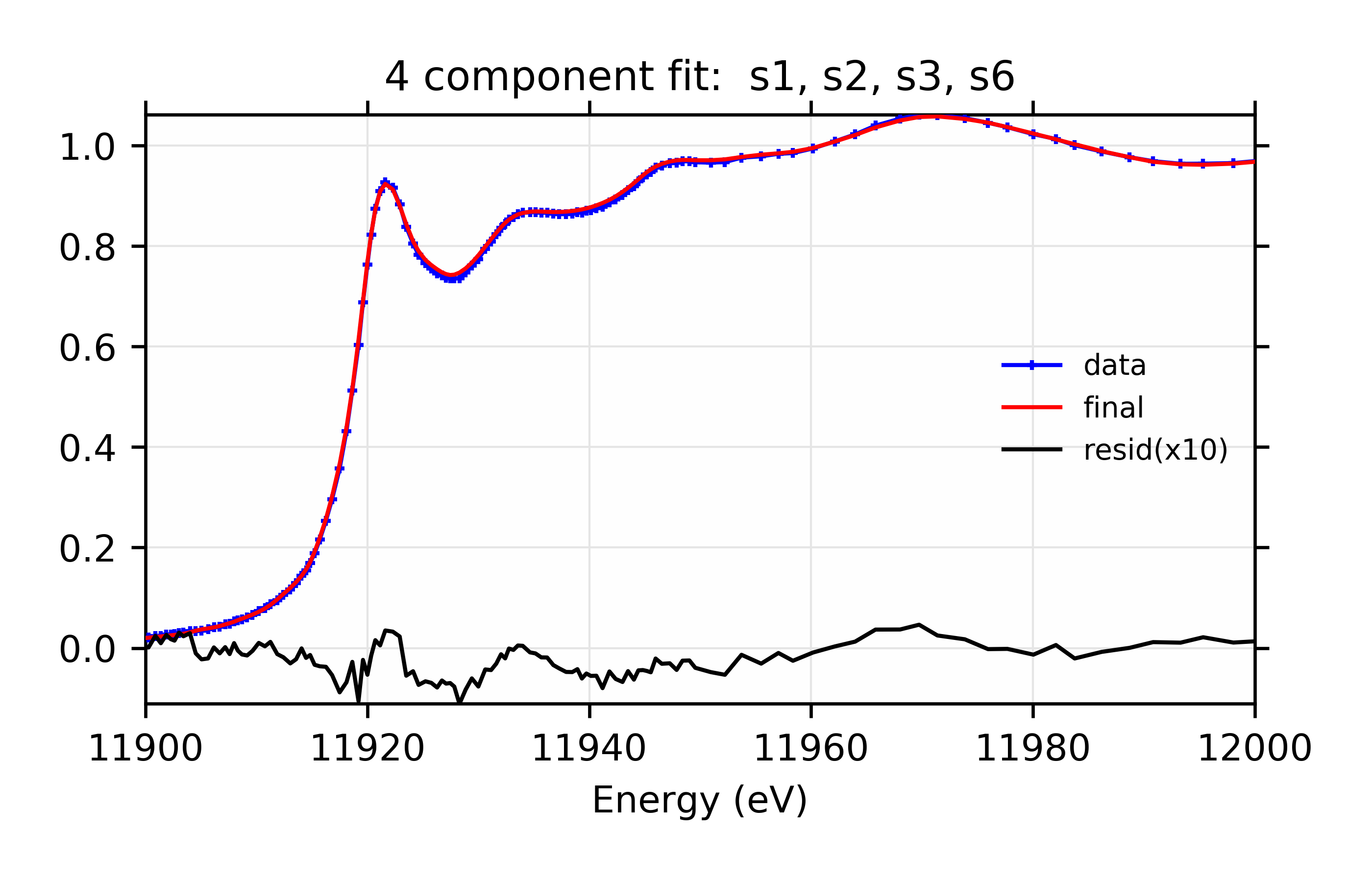

../_images/fit_example3c1.png
Figure 10.6.10 Linear Combination XANES Fit of gold components in cyanobacteria with species s1, s2, and s5. Linear combination fit and residual.
../_images/fit_example3c2.png
Figure 10.6.11 Linear Combination XANES Fit of gold components in cyanobacteria with species s1, s2, and s5. Weighted contribution from individual components.

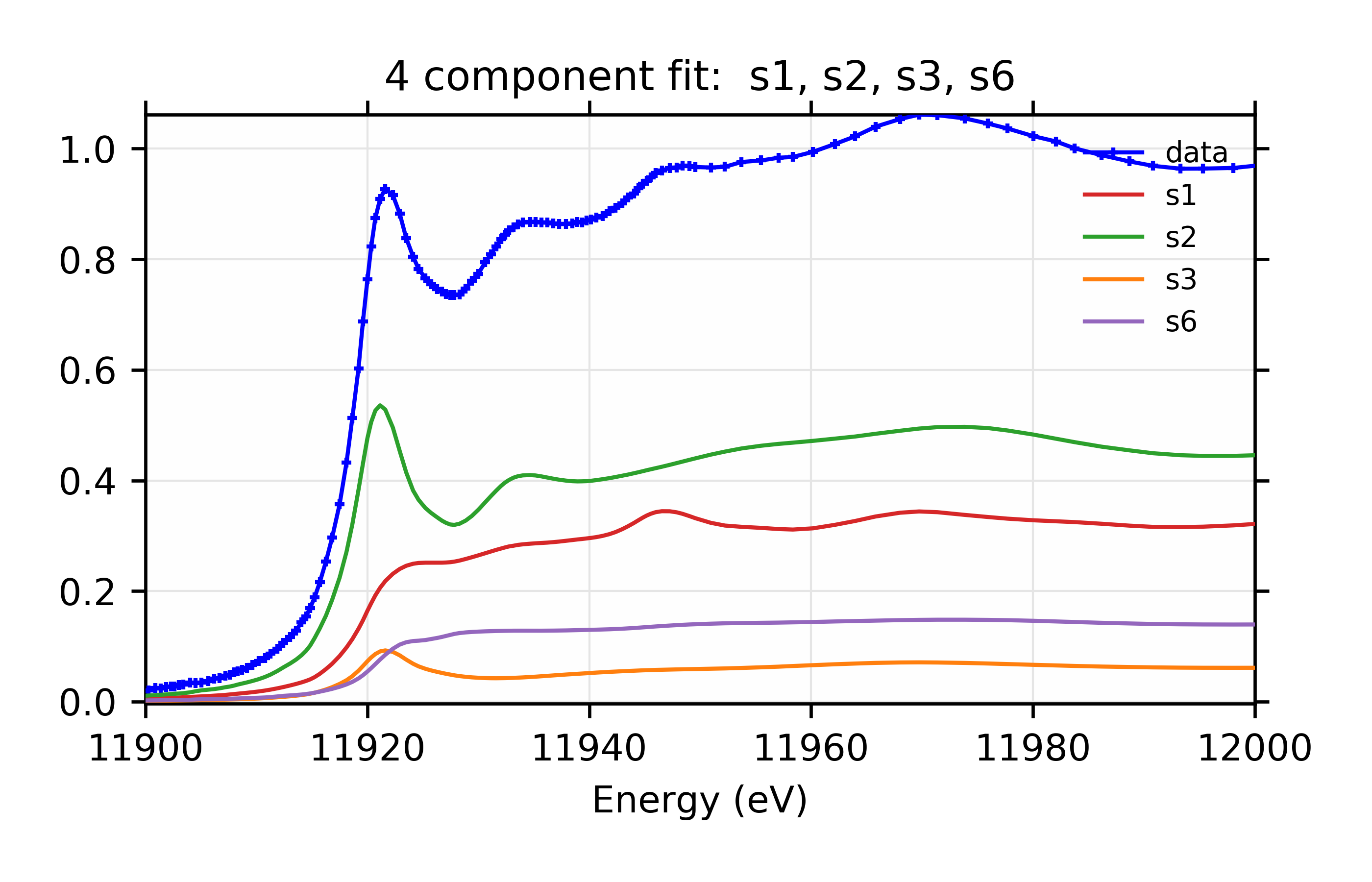

Of course, we aren’t necessarily done here as we haven’t exhausted all possible combinations of components. Included in the examples (examples/fitting/doc_examples3/fit3.lar), but not reprinted here, is a script that runs through all possible combinations of 3 and 4 components, though still assuming that s1 and s2 are components.
The output gives this:
     58.7   |  652.7  |  655.8 |  2 component fit:  s1, s2
     40.2   |  592.9  |  599.1 |  3 component fit:  s1, s2, s3
     37.2   |  580.6  |  586.7 |  3 component fit:  s1, s2, s4
     32.1   |  557.2  |  563.4 |  3 component fit:  s1, s2, s5
     37.2   |  580.6  |  586.8 |  3 component fit:  s1, s2, s6
     59.2   |  656.0  |  665.2 |  4 component fit:  s1, s2, s3, s4
     14.7   |  433.3  |  442.5 |  4 component fit:  s1, s2, s3, s5
     13.3   |  417.6  |  426.8 |  4 component fit:  s1, s2, s3, s6
     30.1   |  547.8  |  557.1 |  4 component fit:  s1, s2, s4, s5
     32.4   |  559.2  |  568.5 |  4 component fit:  s1, s2, s5, s6
     34.3   |  568.8  |  578.0 |  4 component fit:  s1, s2, s4, s6
Best Fit:   4 component fit:  s1, s2, s3, s6
[[Fit Statistics]]
    # function evals   = 37
    # data points      = 160
    # variables        = 3
    chi-square         = 2095.2
    reduced chi-square = 13.345
    Akaike info crit   = 417.56
    Bayesian info crit = 426.78
[[Variables]]
    amp1:   0.32788267 +/- 0.009491 (2.89%) (init= 0.4)
    amp2:   0.46501286 +/- 0.005624 (1.21%) (init= 0.4)
    amp3:   0.06384062 +/- 0.003749 (5.87%) (init= 0)
    amp4:   0 (fixed)
    amp5:   0 (fixed)
    amp6:   0.14326383 +/- 0.008029 (5.60%)  == '1 - amp1 - amp2 - amp3'
    C(amp2, amp3)                = -0.890
    C(amp1, amp2)                = -0.340
You might notice that, whereas the 3 component fit favored adding s5, the four component fit favors s3 and s6. You might further notice that the four component fit with s3 and s5 has reduced chi-square of 14.7, only slightly worse than the best value. For completeness, the parameters for that are:

The plots resulting from both sets of Parameters are shown:
../_images/fit_example3d1.png
Figure 10.6.12 Linear Combination XANES Fit of gold components in cyanobacteria with species s1, s2, s3, and s6. Data, fit, and residual.
../_images/fit_example3d2.png
Figure 10.6.13 Linear Combination XANES Fit of gold components in cyanobacteria with species s1, s2, s3, and s6. Weighted contribution from individual components.
../_images/fit_example3e1.png
Figure 10.6.14 Linear Combination XANES Fit of gold components in cyanobacteria with species s1, s2, s3, and s5. Data, fit, and residual.
../_images/fit_example3e2.png
Figure 10.6.15 Linear Combination XANES Fit of gold components in cyanobacteria with species s1, s2, s3, and s5. Weighted contribution from individual components.
From the plots alone, it is difficult to tell which of these fits is better, and it is probably best to say that these are both good fits. This implies that component s3 is important even if at a very small fraction, and that either component s5 or s6 (which aren’t that different spectroscopically or chemically (see Figure 10.6.8) is present. Of course, the analysis here is not meant to be definitive, and there are many more checks that could be done. To be clear, [Larch_1] looked at many more unknown spectra, and also adjusted the energy ranges of the fits, and concludedd that s1, s2, s3, and s5 were the best components, with concentrations of the components very similar to the ones found here.
