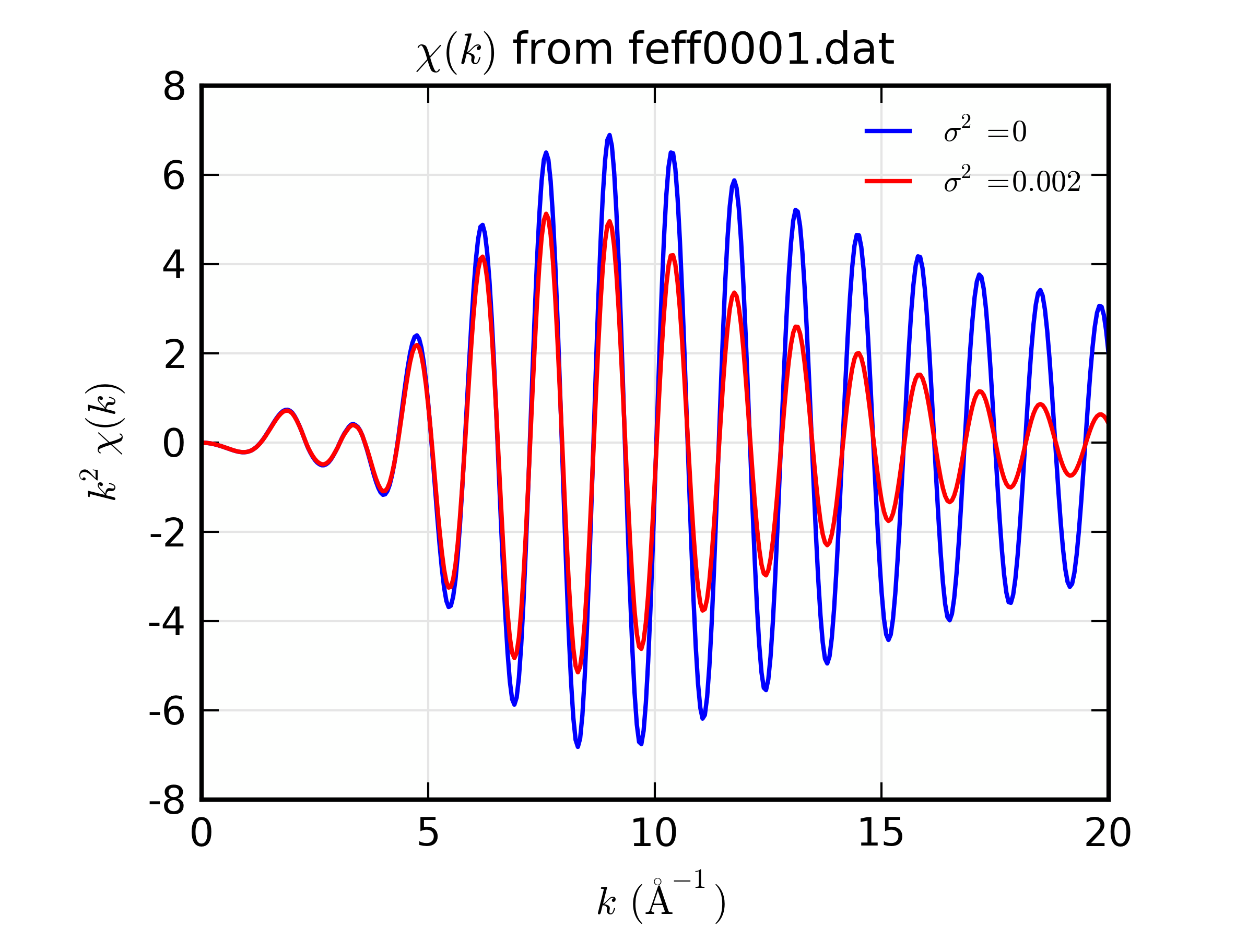

9.7.7. Example: Reading a Feff file¶
Here we simply read a feffNNNN.dat file and display its components, and calculate \(\chi\) for this path with two different values of \(\sigma^2\).
## examples/feffit/doc_feffdat1.lar
fname = 'feff0001.dat'
path1 = feffpath(fname)
path2chi(path1)
show(path1)
newplot(path1.k, path1.chi*path1.k**2, xlabel=r' $ k \rm\, (\AA^{-1})$',
ylabel=r'$ k^2\chi(k)$', label = r'$\sigma^2 = 0$', show_legend=True,
title=r'$\chi(k)$ from %s' % fname)
path1.sigma2 = 0.002
path2chi(path1)
plot(path1.k, path1.chi*path1.k**2, label = r'$\sigma^2 = 0.002$')
## end examples/feffit/doc_feffdat1.lar
The output of this looks like this:
== FeffPath Group feff0001.dat: 16 symbols ==
_feffdat: <Feff.dat File Group: feff0001.dat>
chi: array<shape=(401,), type=dtype('float64')>
chi_imag: array<shape=(401,), type=dtype('float64')>
degen: 12.0
deltar: 0
e0: 0
ei: 0
filename: 'feff0001.dat'
fourth: 0
geom: [('Cu', 29, 0, 0.0, 0.0, 0.0), ('Cu', 29, 1, 0.0, -1.8016, 1.8016)]
k: array<shape=(401,), type=dtype('float64')>
label: 'feff0001.dat'
p: array<shape=(401,), type=dtype('complex128')>
s02: 1
sigma2: 0
third: 0
After the initial read, the values of k, p, chi, and
chi_imag are set to None, and are not calculated until
path2chi() is called.
We can also use the data from the _feffdat group to look at the

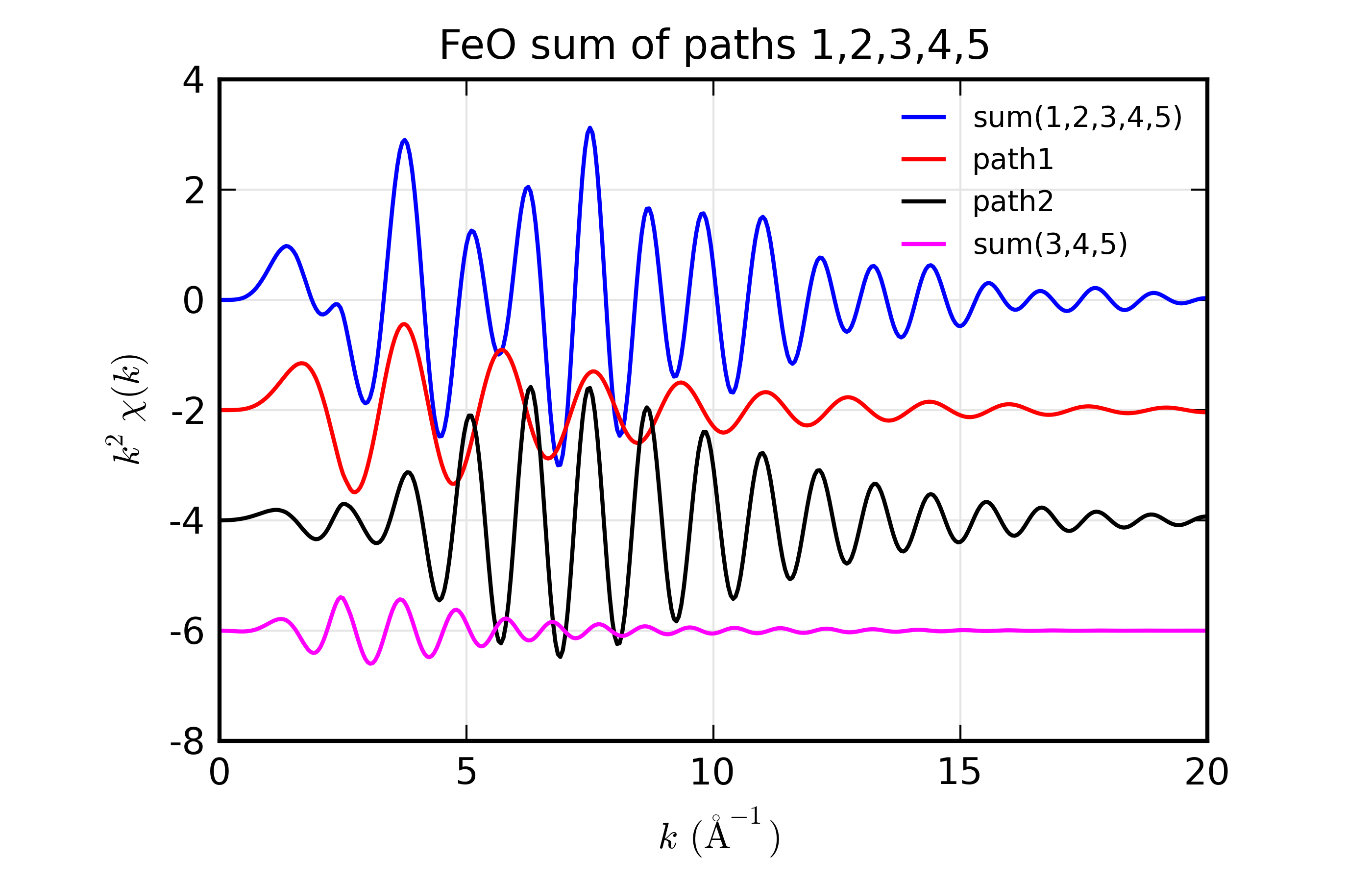

9.7.8. Example: Adding Feff files¶
Now, we add some Feff files together, applying some path parameters. The
example is actually very similar to the one above except that we use
ff2chi() to create a \(\chi(k)\) from a list of paths, and put
the result into its own group. Thus:
## examples/feffit/doc_feffdat3.lar
# read some paths
path1 = feffpath('feff_feo01.dat')
path2 = feffpath('feff_feo02.dat')
path3 = feffpath('feff_feo03.dat')
path4 = feffpath('feff_feo04.dat')
path5 = feffpath('feff_feo05.dat')
# apply an e0 shift and s02 to all paths:
for p in (path1, path2, path3, path4, path5):
p.e0 = -0.5
p.s02 = 0.9
endfor
path1.sigma2 = 0.003
path2.sigma2 = 0.004
path3.sigma2 = 0.006
path4.sigma2 = 0.008
path5.sigma2 = 0.008
mysum = group(label='FeO sum of paths 1,2,3,4,5')
ff2chi([path1, path2, path3, path4, path5], group=mysum)
## now, we can also simply sum paths 3,4,5...
mysum.chi345 = path3.chi + path4.chi + path5.chi
newplot(mysum.k, mysum.chi*mysum.k**2, label='sum(1,2,3,4,5)', show_legend=True,
ylabel=r'$ k^2\chi(k)$', title=mysum.label)
plot(path1.k, -2.+path1.chi*path1.k**2, label='path1')
plot(path2.k, -4+path2.chi*path2.k**2, label='path2')
plot(path3.k, -6+mysum.chi345*path3.k**2, label='sum(3,4,5)')
## end examples/feffit/doc_feffdat3.lar
With the result as shown below. Note that we can also make a simple sum of
a set of paths, which was done in this example to add the contributions of
paths 3, 4, and 5. This works because ff2chi() runs path2chi()
for each path to be summed, so that the chi component of the FeffPath
group is up to date.

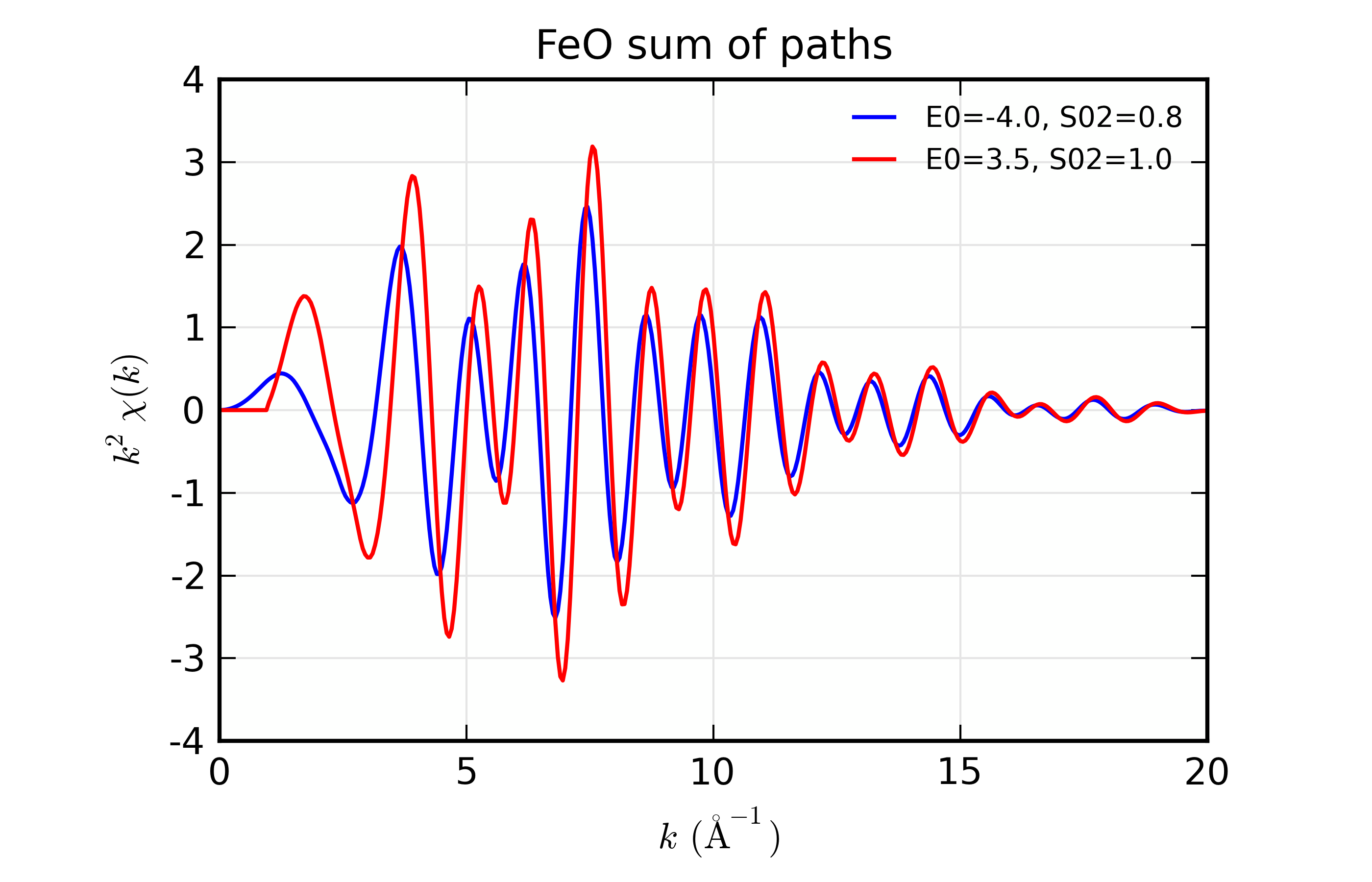

9.7.9. Example: Using Path Parameters when adding Feff files¶
Using Parameters for modelling data is a key feature of Larch, and if you are modelling XAFS data with Feff, you will want to parameterize Path Parameters, apply them to a set of Paths, and investigate the resulting sum of Paths. This is similar to the examples above, but combines the Parameter concept from the Fitting chapter. In Larch, this looks like:
## examples/feffit/doc_feffdat4.lar
# read some paths
# create a group containing parameters
pars = group(del_e0 = param(-4.0, min=-10, max=10),
amp = param(0.8, min=0.3, max=1.5))
for p in (path1, path2):
p.e0 = 'del_e0'
p.s02 = 'amp'
p.sigma2 = 0.003
if p == path2: p.sigma2 = 0.005
endfor
mysum = group(label='FeO sum of paths')
ff2chi([path1, path2], group=mysum, paramgroup=pars)
label='E0=%.1f, S02=%.1f' % (pars.del_e0.value, pars.amp.value)
label=label, show_legend=True,
xlabel=r'$ k \rm\, (\AA^{-1})$',
# now change parameter values, re-do sum
pars.del_e0.value = 3.5
pars.amp.value = 1.0
# re-calculate chi for each path with paramgroup set
# then sum the paths ourselves
path2chi(path1, paramgroup=pars)
path2chi(path2, paramgroup=pars)
mysum.chi_alt = path1.chi + path2.chi
plot(mysum.k, mysum.chi_alt*mysum.k**2, label=label)
## end examples/feffit/doc_feffdat4.lar
After reading in the Feff data files, we have created a group pars of
Parameters with _math.param(), specifically pars.del_e0 and
pars.amp. Then we set the e0 path parameter for each path to the
string 'del_e0', and the amp path parameter to 'amp'. We set
the sigma2 values to simple numbers, as above.
Now, when running ff2chi(), we give not only a group to put the
results in, but also a paramgroup to use as the parameters for
evaluating any mathematical expressions we’ve defined for the path
parameters. At this point, the strings del_e0 and amp for the
path parameters for path 1 and 2 are converted into Parameters and
evaluated.
- ..versionchanged:: 0.9.34
- removed _sys.paramGroup, now using fiteval
After plotting the results, we then change the values of the parameters.
We could re-run ff2chi(), but we can also just run path2chi()
on the paths for which we want to recalculate \(\chi\). Note that we
specify the paramgroup to path2chi() here.
The resulting plot shows the effect of changing \(E_0\) and \(S_0^2\) for a sum of paths. The same result could be shown by just setting the path parameters to the appropriate numerical values, but the use of parameters makes this somewhat more general. As we will see in the next section, the use of parameters also allows us to easily refine their values in a fit of XAFS data to such a sum of paths.
