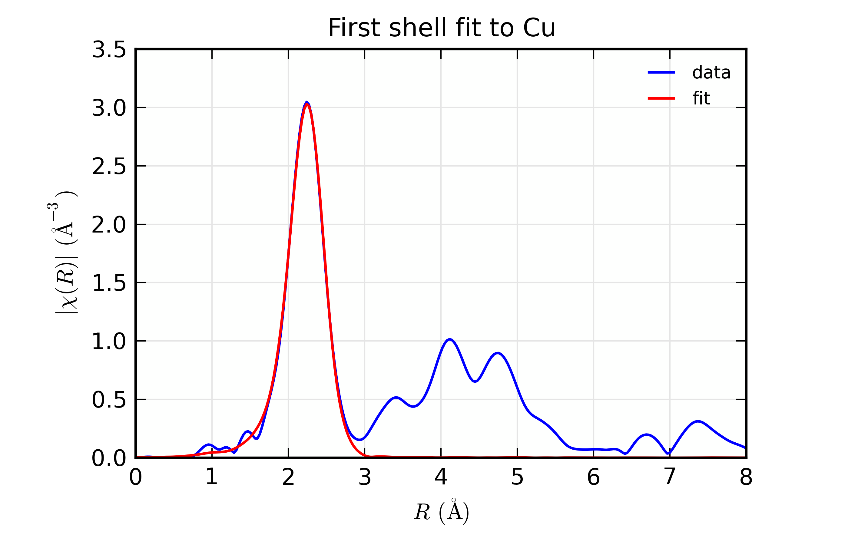

9.8.8. Example 1: Simple fit with 1 Path
We start with a fairly minimal example, fitting spectra read from a data file with a single Feff Path.
## examples/feffit/doc_feffit1.lar
# read data
cu_data  = read_ascii('../xafsdata/cu_metal_rt.xdi')
autobk(cu_data.energy, cu_data.mutrans, group=cu_data, rbkg=1.0, kw=2)
# define fitting parameter group
pars = group(amp    = param(1.0, vary=True),
             del_e0 = param(0.0, vary=True),
             sig2   = param(0.0, vary=True),
             del_r  = guess(0.0, vary=True) )
# define a Feff Path, give expressions for Path Parameters
path1 = feffpath('feffcu01.dat',
                 s02    = 'amp',
                 e0     = 'del_e0',
                 sigma2 = 'sig2',
                 deltar = 'del_r')
# set tranform / fit ranges
trans = feffit_transform(kmin=3, kmax=17, kw=2, dk=4, window='kaiser', rmin=1.4, rmax=3.0)
# define dataset to include data, pathlist, transform
dset = feffit_dataset(data=cu_data, pathlist=[path1], transform=trans)
# perform fit!
out = feffit(pars, dset)
print(feffit_report(out))
try:
    fout = open('doc_feffit1.out', 'w')
    fout.write("%s\n" % feffit_report(out))
    fout.close()
except:
    print('could not write doc_feffit1.out')
#endtry
plot_chifit(dset)
## end examples/feffit/doc_feffit1.lar
This simply follows the essential steps:
1. A group of parameters pars is defined. Note that you can include upper and/or lower bounds and mix the use of _math.guess() and _math.param().
2. A Feff Path is defined with feffpath(), as discussed in the previous section. Here we assign each of the Path Parameters to the name of one of the fitting parameters. More complex expressions and relations can be used, but for this example, we’re keeping it simple.
3. A Feffit Transform is created with feffit_transform(), which essentially sets the Fourier transform parameters and fit ranges.
4. A Feffit Dataset is created with feffit_dataset(). To begin the fit, this includes a data group, a transform group, and a pathlist, which is a list of FeffPaths.
5. The fit is run with feffit(), and the output group is saved. This output group is used by feffit_report() to generate a fit report (shown below).
6. Plots are made from the dataset, using rather long-winded plot() commands.
running this example prints out the following report:
=================== FEFFIT RESULTS ====================
[[Statistics]]
   nvarys, npts       = 4, 104
   n_independent      = 15.260
   chi_square         = 38.0085
   reduced chi_square = 3.37545
   r-factor           = 0.00279
   Akaike info crit   = 21.9259
   Bayesian info crit = 24.8269
[[Data]]
   fit space          = 'r'
   r-range            = 1.400, 3.000
   k-range            = 3.000, 17.000
   k window, dk       = 'kaiser', 4.000
   paths used in fit  = ['feffcu01.dat']
   k-weight           = 2
   epsilon_k          = Array(mean=0.001076, std=0.003504)
   epsilon_r          = 0.036161
[[Variables]]
   amp            =  0.928280 +/- 0.039477   (init=  1.000000)

and generates the plots shown below
../_images/feffit_example1.png
Figure 9.8.1 Data and Fit in \(k\) space
../_images/feffit_example2.png
Figure 9.8.2 Data and Fit in \(R\) space
Results for Feffit for a simple 1-shell fit to a spectrum from Cu metal.
This is a pretty good fit to the first shell of Cu metal, and shows the basic mechanics of fitting XAFS data to Feff Paths. There are several things that might be added to this for modeling more complex XAFS data, including adding more paths to a fit, including multiple-scattering paths, simultaneously modeling more than one data set, and building more complex fitting models. We’ll get to these in the following examples.

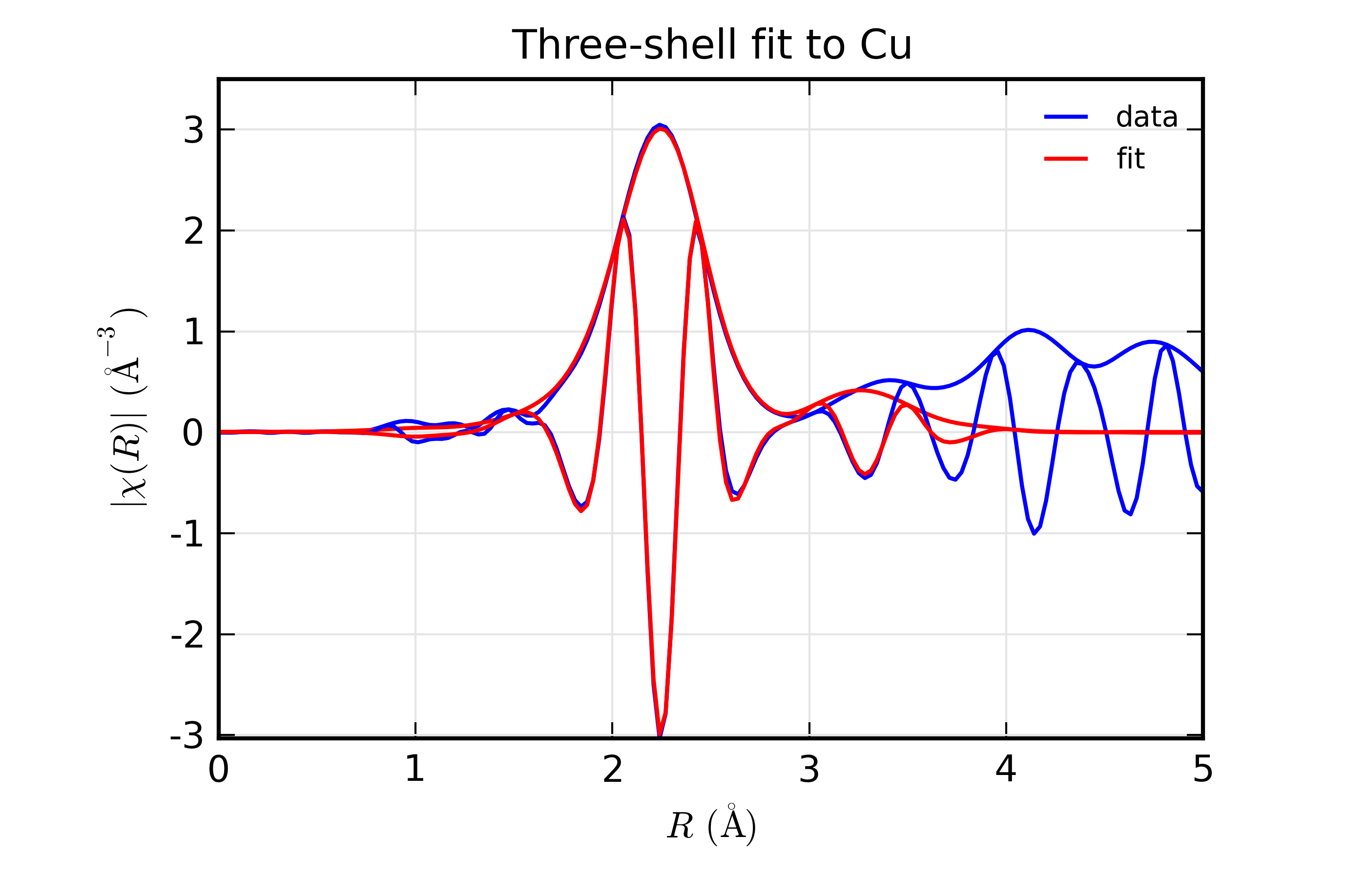

9.8.9. Example 2: Fit 1 dataset with 3 Paths
We’ll continue with the Cu data set, and add more paths to model further shells. This is fairly straightforward, but in the interest of space, we’ll limit the example here to 3 paths to model the first two shells of copper. This is a small step, but highlights a main concern with XAFS analysis that we need to address. This is the fact that there simply is not enough freedom in the XAFS signal to measure all the possible adjustable Path Parameters independently. Thus we need to be able to apply constraints to the Path Parameters.
Here, we use two of the most common types of constraints. First, we apply the same amplitude reduction factor and the same \(E_0\) shift to all Paths. These may seem obvious for this example, but for more complicated examples, either including shells of mixed species or Feff Paths generated from different calculation, these become less obvious.
Second, we introduce a scale the change in distance by a single expansion factor \(\alpha\) (alpha in the script), and using the built-in value of half-path distance, reff, and setting deltar = 'alpha*reff' for all Paths. During the calculation of \(\chi(k)\) for each path that happens in the fitting process, the value of reff will be updated to the correct value for each path. Thus, as the value of alpha varies in the fit, each path will use its proper value for reff, so that each deltar will be different but not independent. This ensures that all the path lengths change in a manner consistent with one another.
## examples/feffit/doc_feffit2.lar
# read data
# read data

trans = feffit_transform(kmin=3, kmax=17, kw=2, dk=4, window='kaiser', rmin=1.4, rmax=3.5)
dset  = feffit_dataset(data=cu_data, pathlist=[path1, path2, path3], transform=trans)
# perform fit!
report = feffit_report(out)
print( report)
run('doc_macros.lar')
write_report('doc_feffit2.out', report)

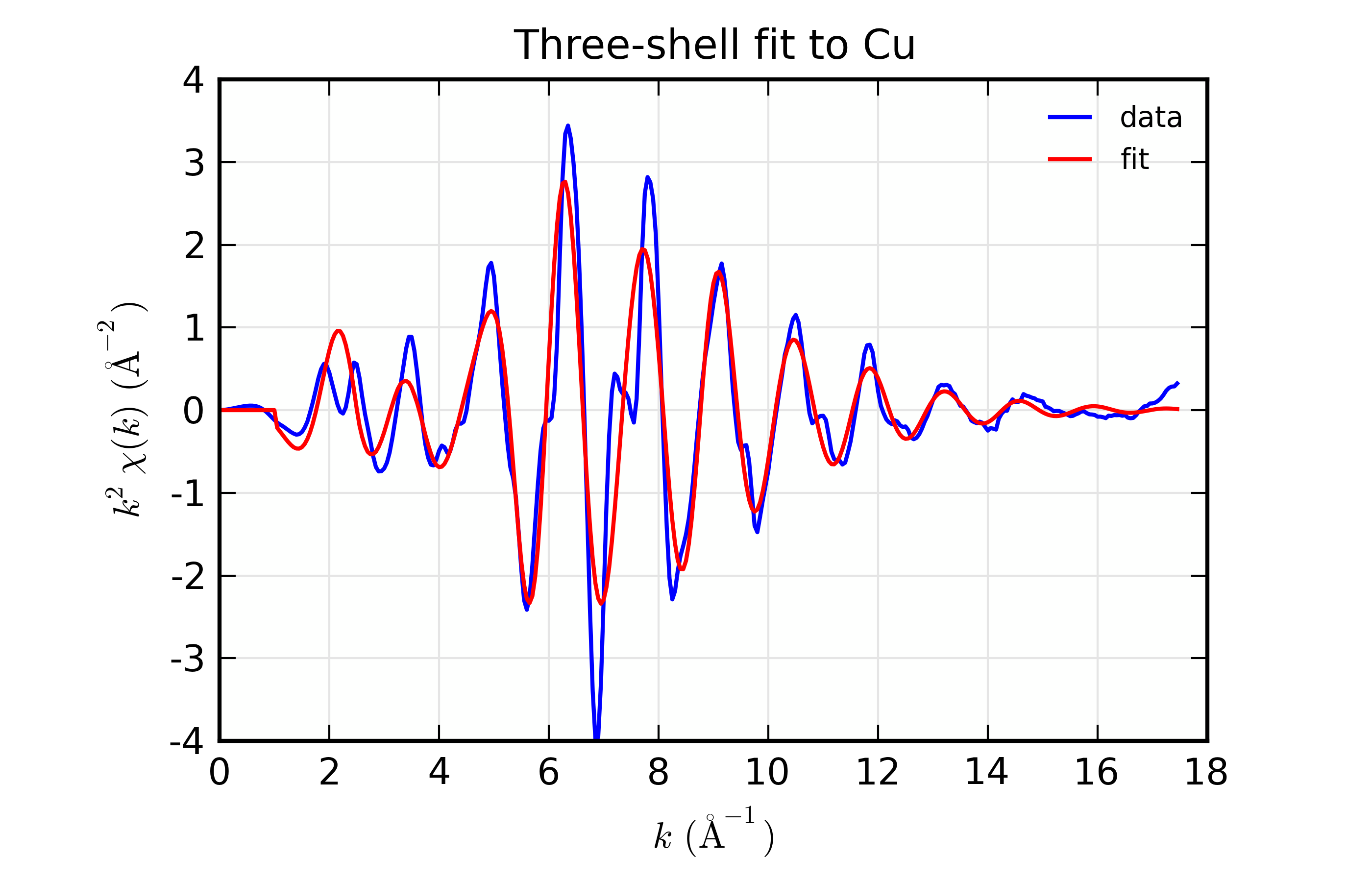

plot_chifit(dset, title='Three-shell fit to Cu', rmax=5)
## end examples/feffit/doc_feffit2.lar
Here we simply create path2 and path3 using nearly the same parameters as for path1. Compared to the previous example, the other changes are that the \(R\) range for the fit has been increased so that the fit will try to fit the second shell, and that sigma2 is allowed to vary independently for each path.
The output for this fit is a bit longer, being:

With plots of data and fits as shown below.
../_images/feffit_example3.png
../_images/feffit_example4.png
Results for Feffit for a 3-shell fit to a spectrum from Cu metal, constraining all path distances to expand with a single variable.

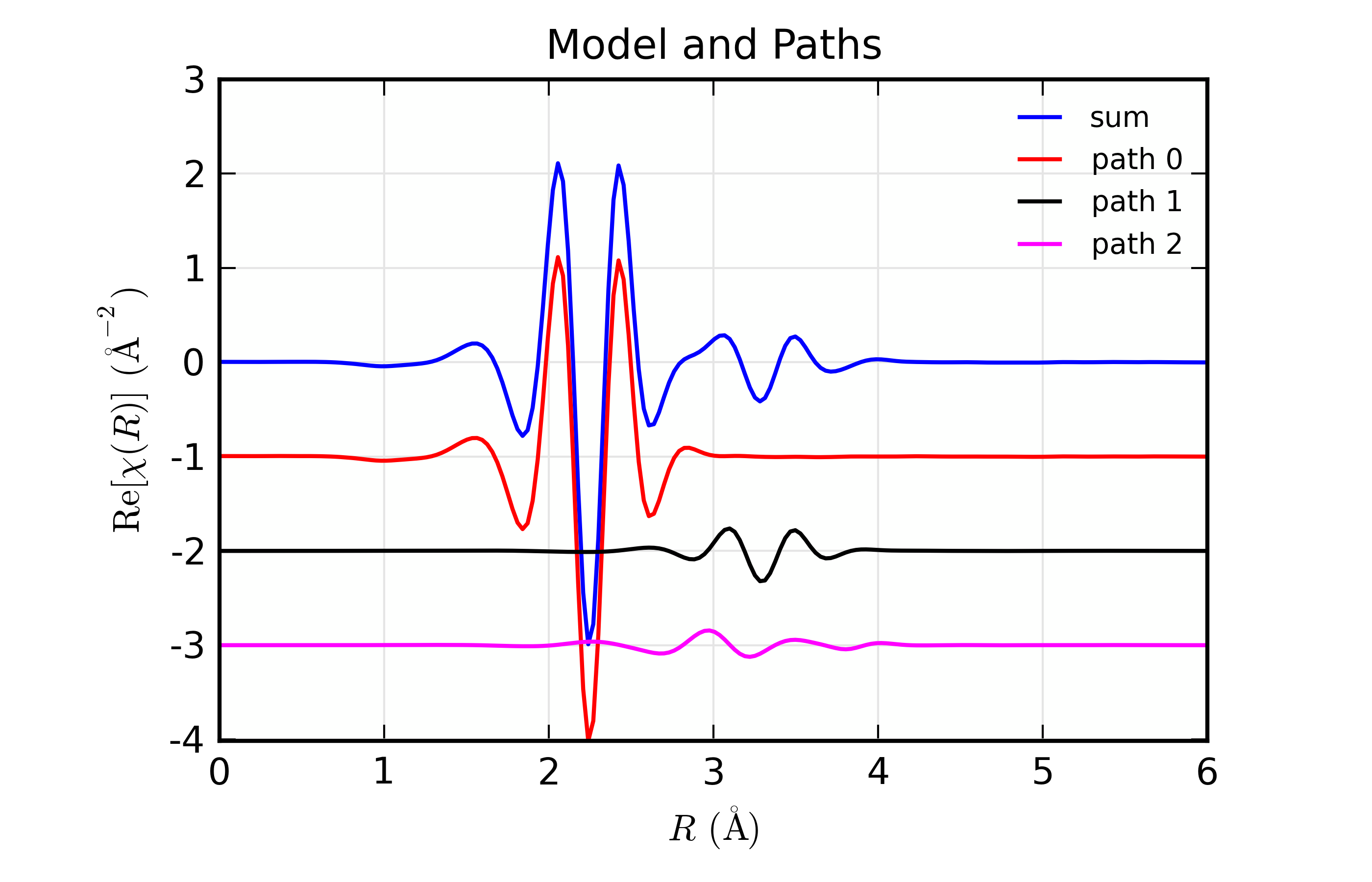

Here, we show both the magnitude and real part of \(\chi(R)\). The fit to the real part shows excellent agreement over the fit \(R\) range of [1.4, 3.4] \(\AA\). It is often useful the contributions from the individual paths. With the macros defined above, this is pretty straightforward, as we can just do:

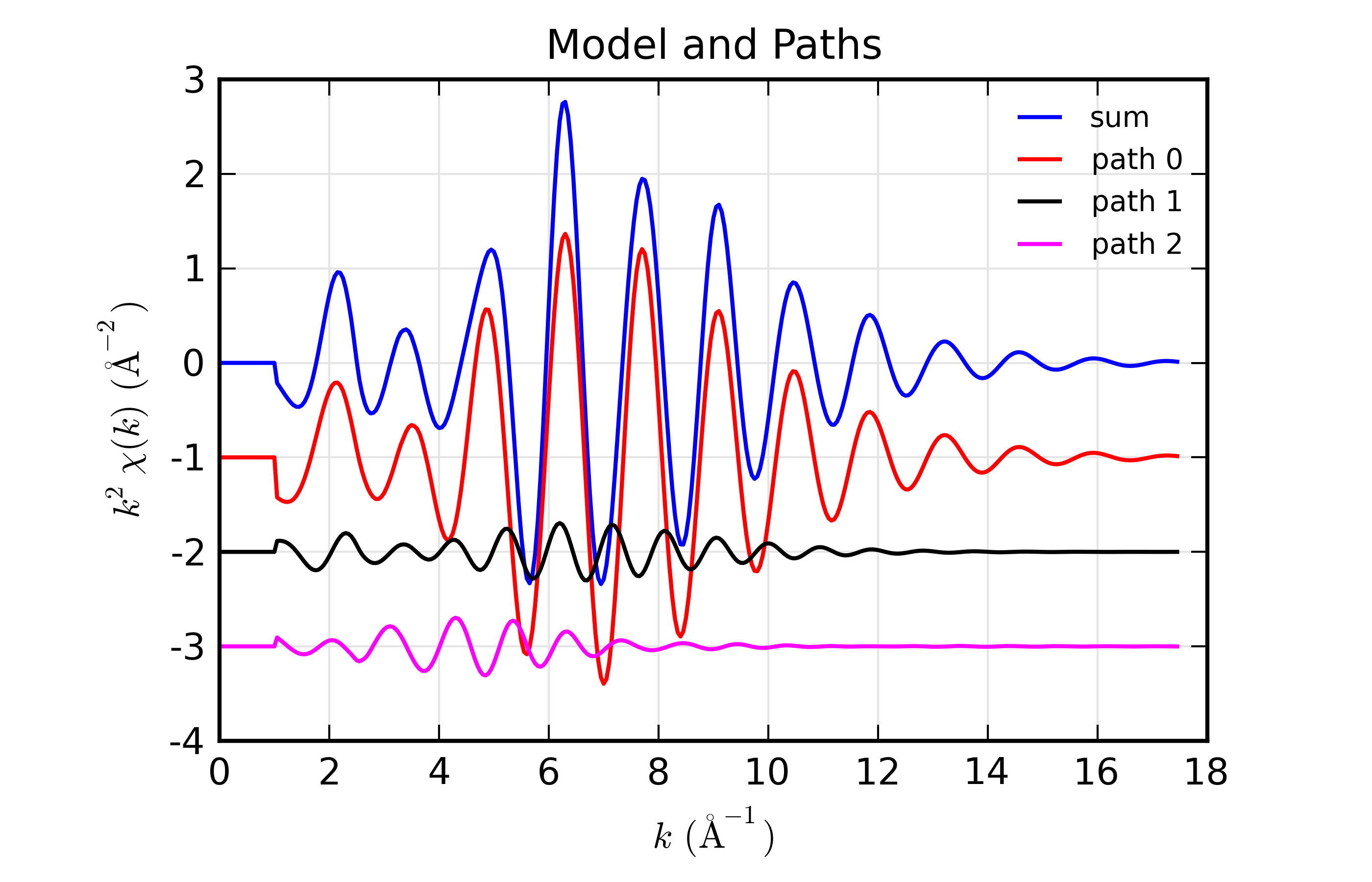

plot_modelpaths_k(dset, offset=-1)
plot_modelpaths_r(dset, comp='re', offset=-1, xmax=6)
to generate the following plots of the contributions of the different paths:
../_images/feffit_example5.png
../_images/feffit_example6.png
Path contributions to full mode for the 3-shell fit to Cu spectrum.

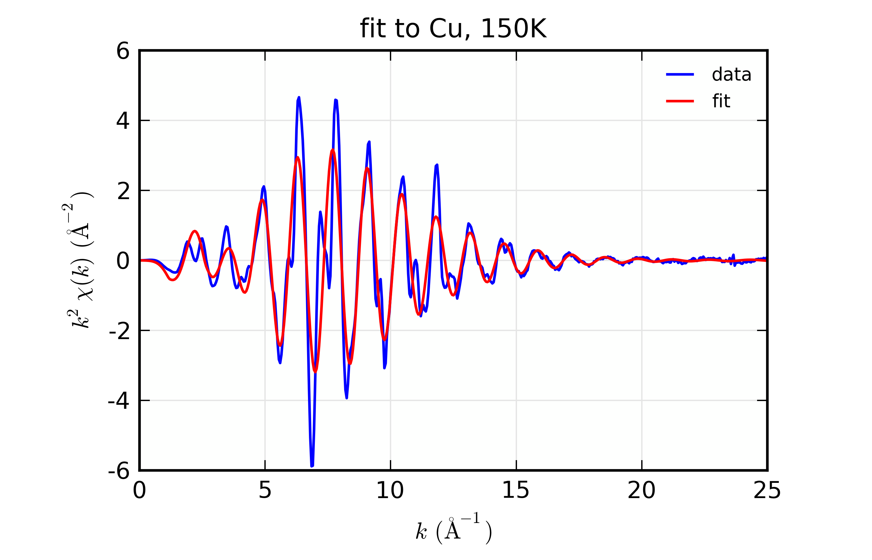

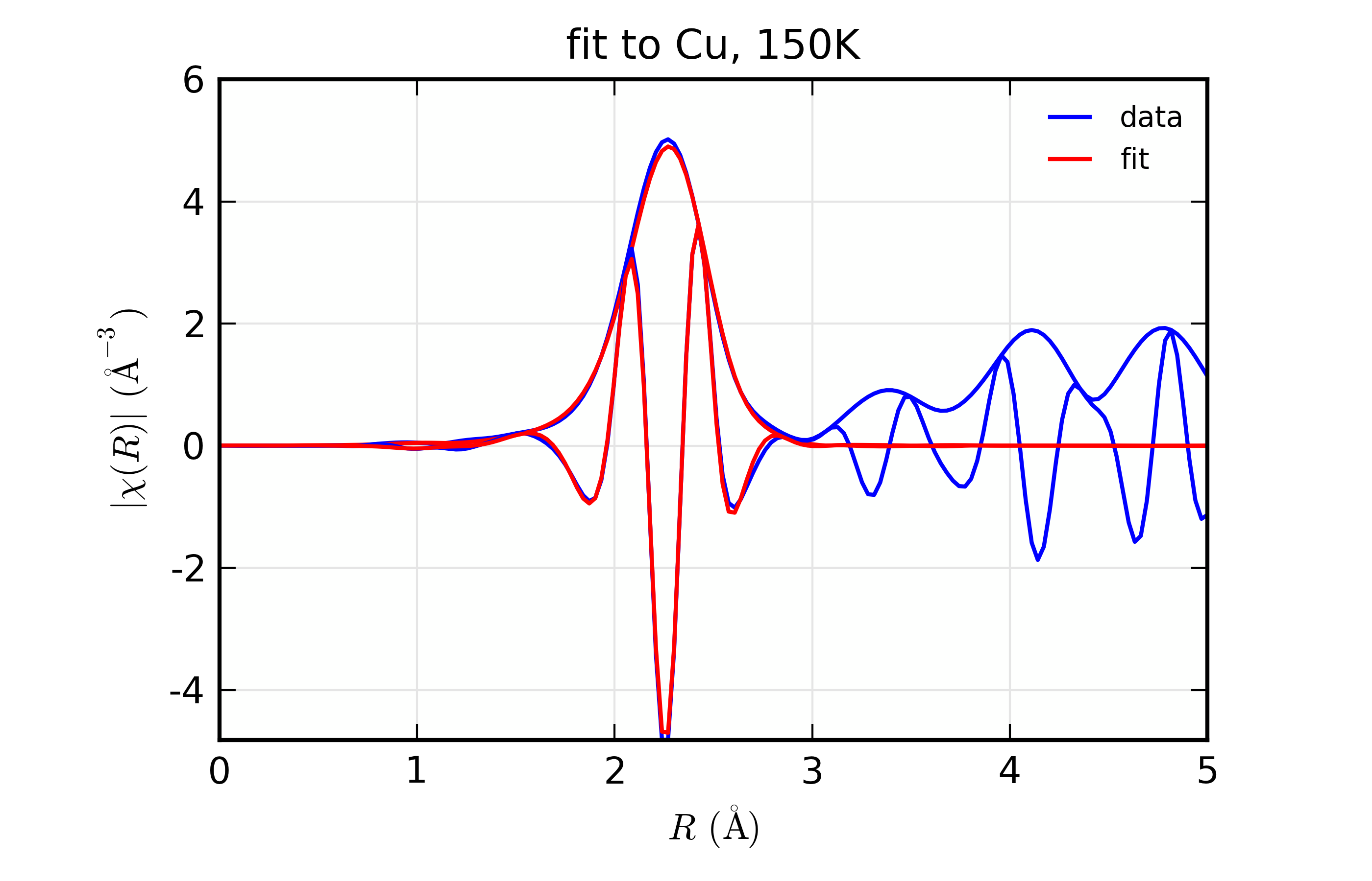

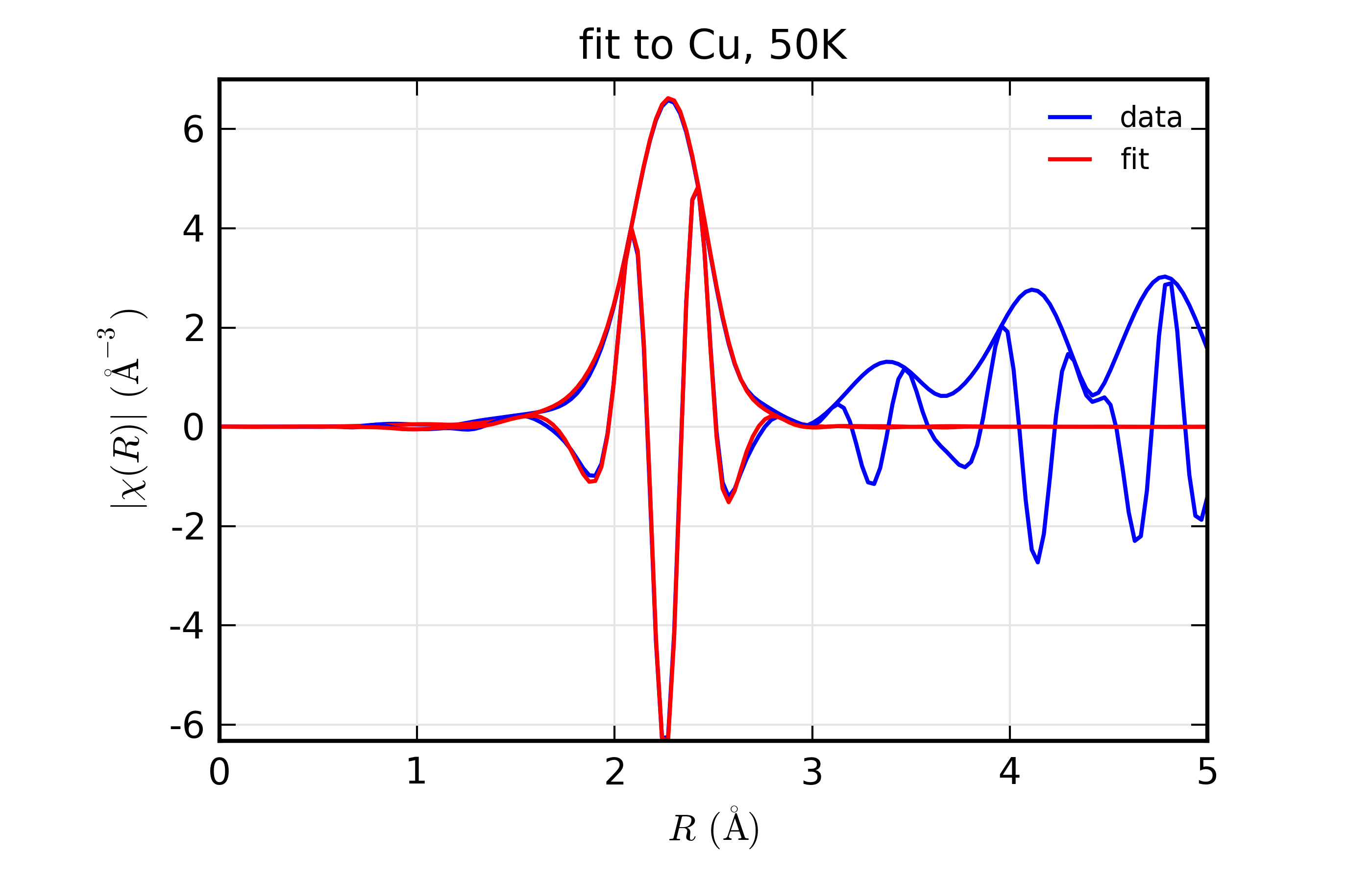

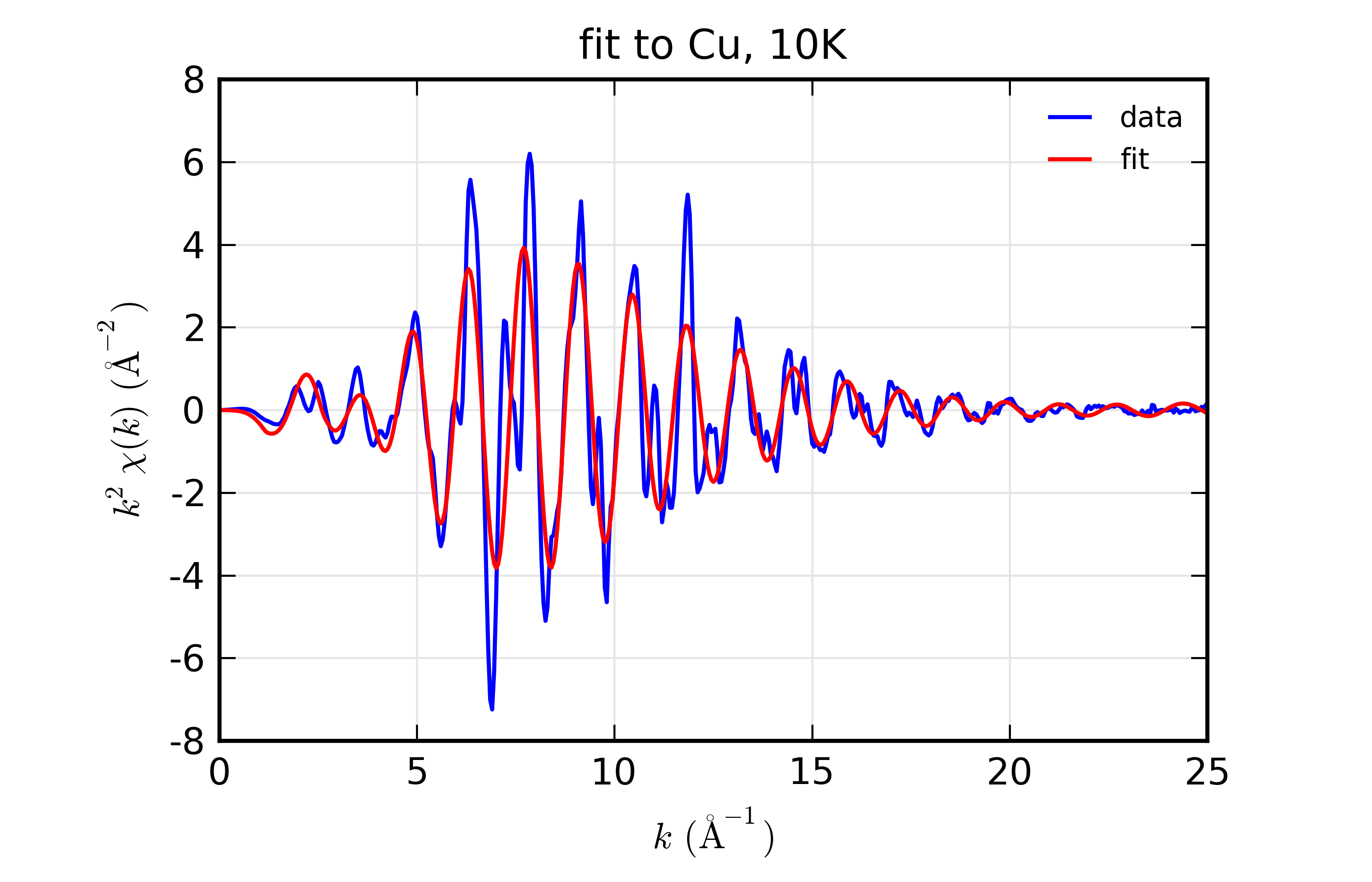

plot_chifit(dset_10, title='fit to Cu, 10K', rmax=5, win=1)
plot_chifit(dset_50, title='fit to Cu, 50K', rmax=5, win=3)
plot_chifit(dset_150, title='fit to Cu, 150K', rmax=5, win=5)
# ## end examples/feffit/doc_feffit3.lar
Here we read in 3 datasets for \(\mu(E)\) data and do the background subtraction on each of them. We define 5 fitting parameters, including the characteristic (here, Einstein) temperature which will determine the value of \(\sigma^2\), and two parameters for the linear temperature dependence of \(R\). The output for this fit is:

 dataset 1:
   Path pfh2ced6i, Feff.dat file = feff0001.dat
     atom      x        y        z       ipot
      Cu       0.0000,  0.0000,  0.0000  0 (absorber)
      Cu       0.0000, -1.8016,  1.8016  1
     reff   =  2.54780
     degen  =  12.000000
     n*s02  =  0.869093 +/- 0.030460  'amp'
     e0     =  5.374313 +/- 0.612594  'del_e0'
     r      =  2.547394 +/- 0.002786  'reff + dr_off + 10*alpha*reff'
     deltar = -0.000406 +/- 0.002786  'dr_off + 10*alpha*reff'
     sigma2 =  0.003275 +/- 0.000115  'sigma2_eins(10, theta)'
 dataset 2:
     atom      x        y        z       ipot
     reff   =  2.54780
     degen  =  12.000000
     r      =  2.548002 +/- 0.002544  'reff + dr_off + 50*alpha*reff'
     deltar =  0.000202 +/- 0.002544  'dr_off + 50*alpha*reff'
     sigma2 =  0.003337 +/- 0.000128  'sigma2_eins(50, theta)'
 dataset 3:
     atom      x        y        z       ipot
     reff   =  2.54780
     degen  =  12.000000
     r      =  2.549525 +/- 0.002960  'reff + dr_off + 150*alpha*reff'
     deltar =  0.001725 +/- 0.002960  'dr_off + 150*alpha*reff'
     sigma2 =  0.005030 +/- 0.000299  'sigma2_eins(150, theta)'

The output plots for the fits to the three datasets are given below.
../_images/feffit_3temp1.png
Figure 9.8.7 Fit to Cu \(\chi(k)\) at 10 K
../_images/feffit_3temp3.png
Figure 9.8.8 Fit to Cu \(\chi(k)\) at 50 K
../_images/feffit_3temp5.png
Figure 9.8.9 Fit to Cu \(\chi(k)\) at 150 K
../_images/feffit_3temp2.png
Figure 9.8.10 Fit to Cu \(\chi(R)\) at 10 K
../_images/feffit_3temp4.png
Figure 9.8.11 Fit to Cu \(\chi(R)\) at 50 K
../_images/feffit_3temp6.png
Figure 9.8.12 Fit to Cu \(\chi(R)\) at 150 K
Fit to Cu metal at 10 K, 50 K, and 150 K, from simultaneous fit to all 3 datasets with 5 variables used.
Again, in the interest of brevity and consistency through this chapter, these example are deliberately simple and meant to be illustrative of the capabilities and procedures and should not be viewed as limiting the types of problems that can be modeled.

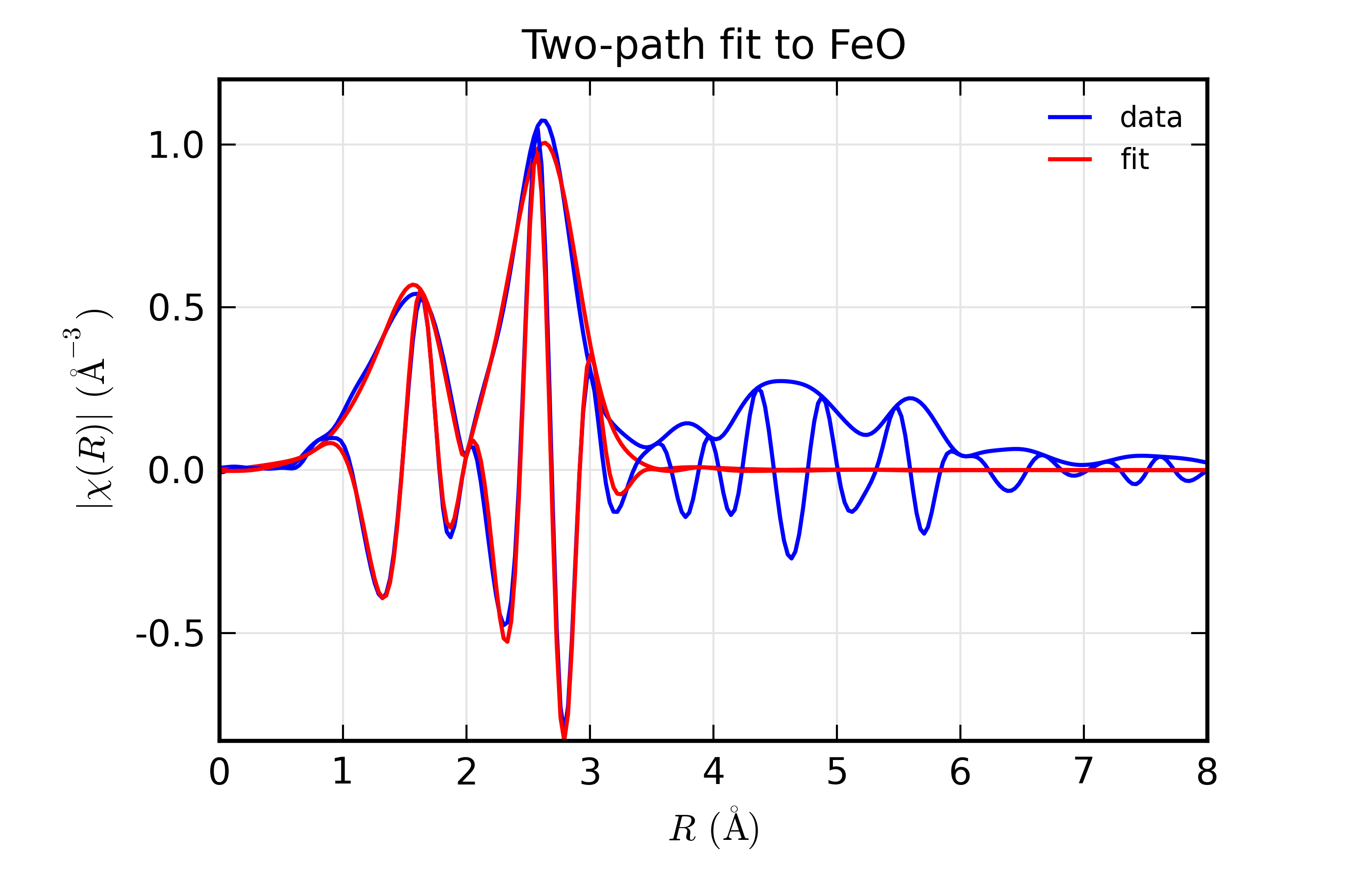

../_images/feffit_feo_r.png
Figure 9.8.14 Fit to FeO spectra, \(R\) space
Fits to 2-path fit to FeO EXAFS.

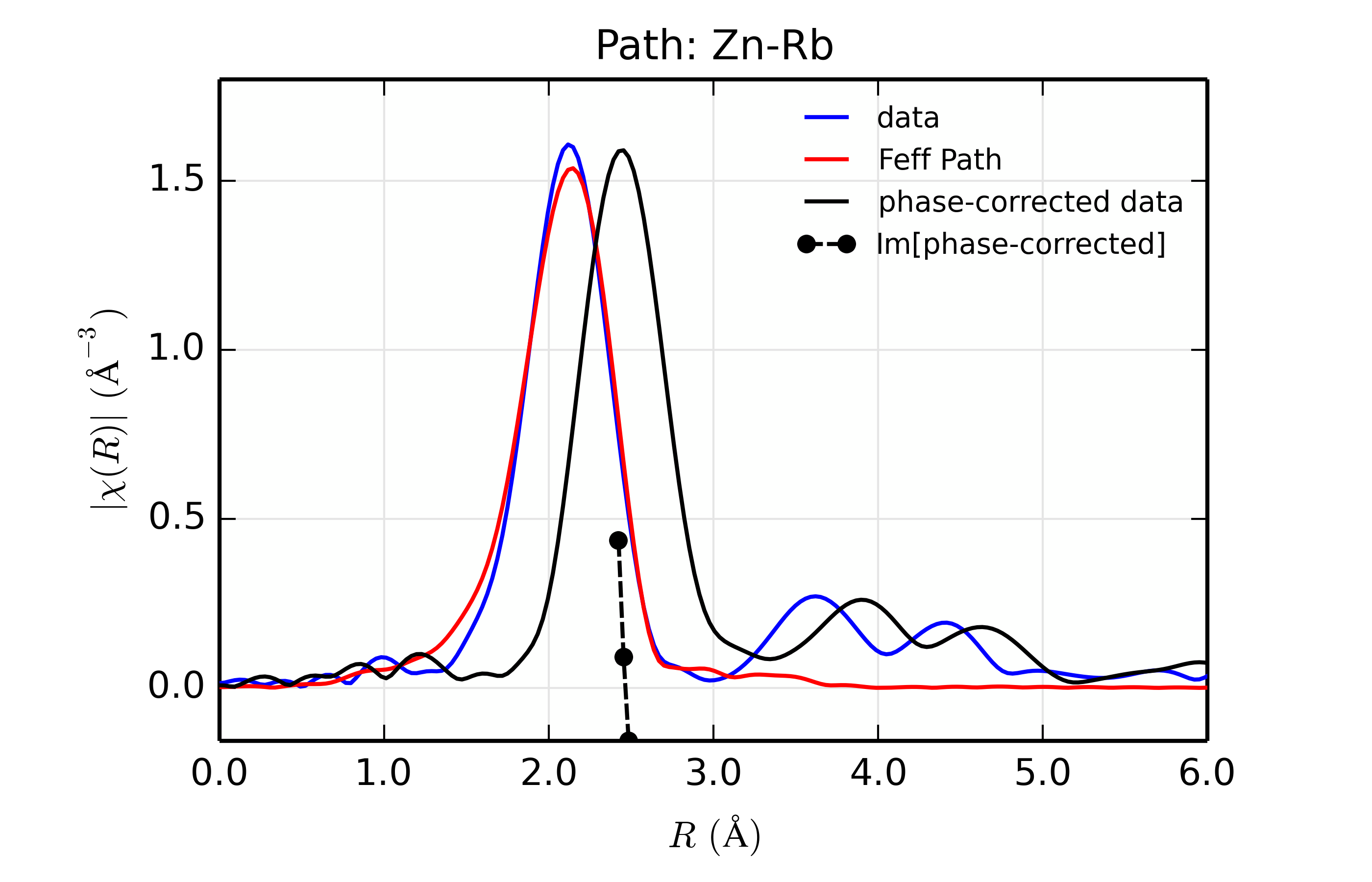

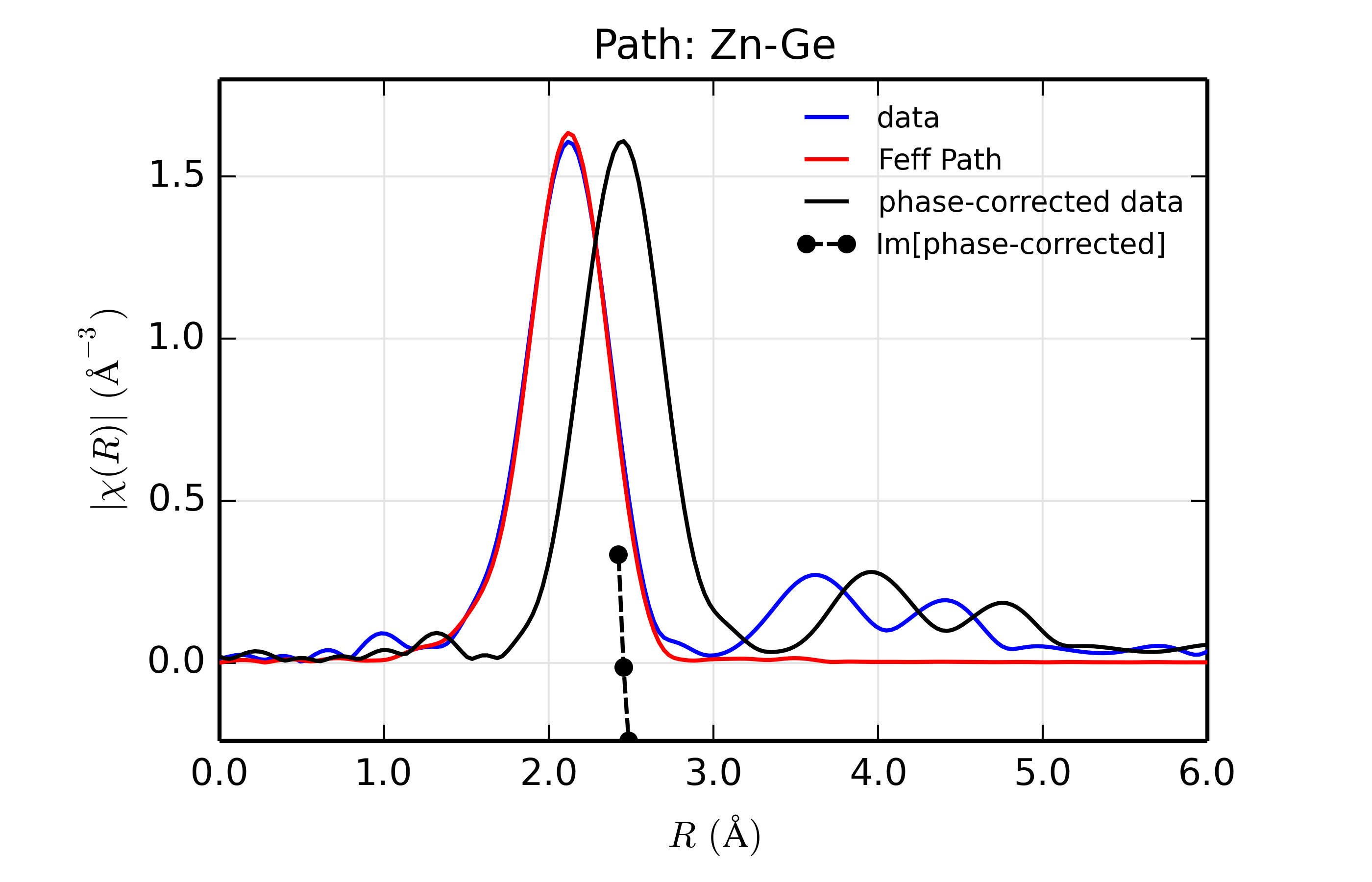

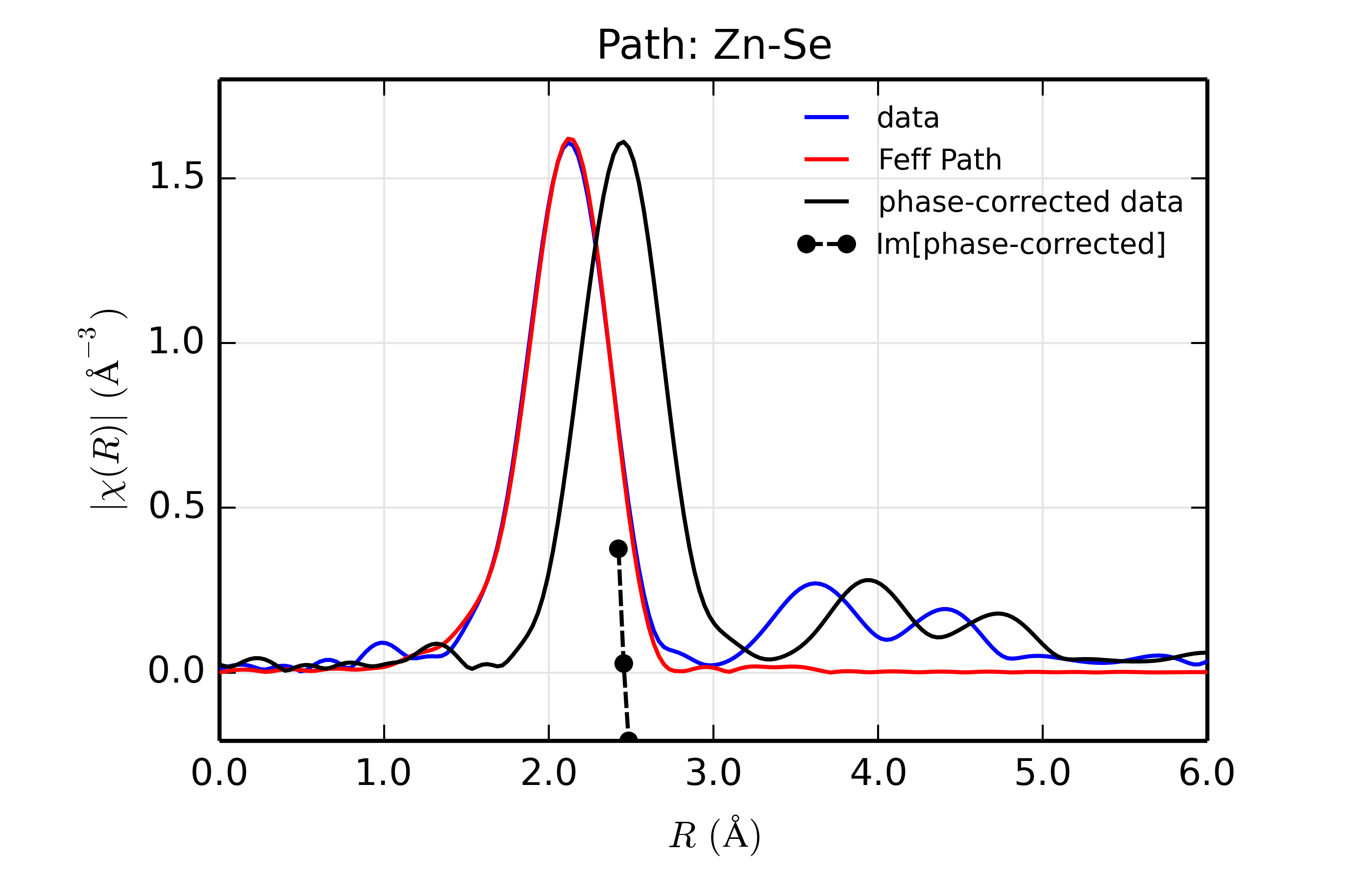

9.8.13. Example 6: Testing EXAFS sensitivity to \(Z\)
EXAFS is known to be sensitive to the atomic number \(Z\) of the scattering atom. This is due to the \(Z\) dependence of the scattering amplitude and phase shift (\(f(k)\) and \(\delta(k)\) in the EXAFS Equation of Section 9.7.5). A rule-of-thumb that is often stated is that EXAFS is sensitive to \(Z \pm 5\), or perhaps pessimistically to row of the Periodic Table, but not as sensitive as \(Z \pm 1\). Occassionally, you may see work that claims very fine \(Z\) sensitivity, such as being able to distinguish N and O ligands. In those works, XAFS results are typically used with chemical arguments about steric effects or known bond distances.
In this section, we’ll explore the \(Z\) sensitivity of XAFS with real data, by constructing Feff paths with different scatterers and trying to fit data with these different scattering paths. This makes a nice exercise in how to manipulate Feff, how to fit XAFS data, and how to compare XAFS fits. Just to make it a little more complicated, we’ll also explore the idea of Phase corrected Fourier transforms and how they might be used to better determine both \(R\) and \(Z\). The example script here is a little more complex than what we’ve seen above, using many feature of the Larch scripting language to do repeated fits and mathematically manipulating the arrays of data.

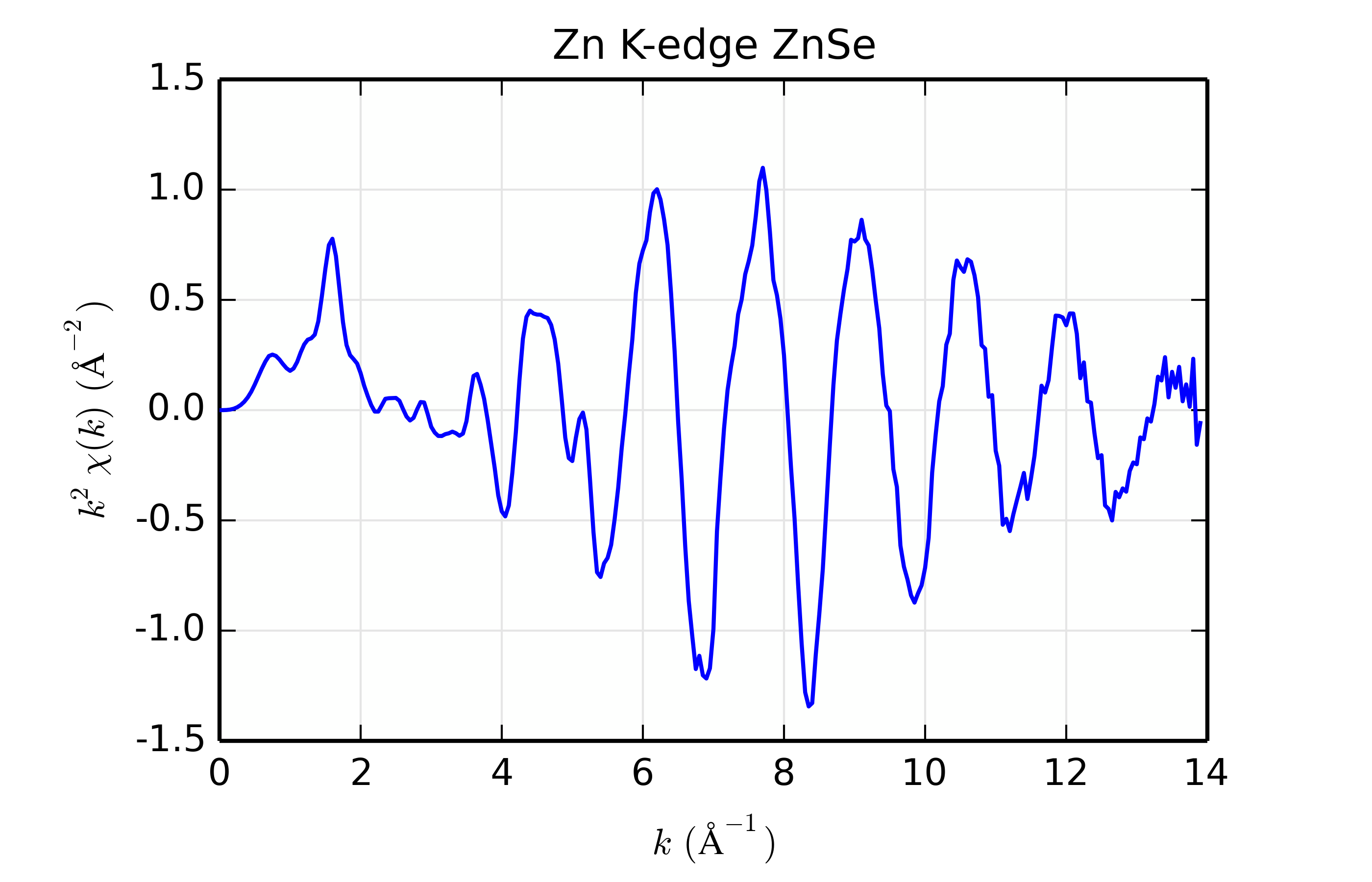

../_images/Feffit_ZnSe_Data.png
Figure 9.8.15 Zn K-edge XAFS data for ZnSe.
For this example, we’ll use Zn K-edge data of ZnSe, with \(\chi(k)\) data shown in Figure 9.8.15. The data is pretty good but not perfect, and is useful for the study here mainly because the structure is simple, with a well-isolated and well-ordered shell of scatterers (the cubic ZnS structure with 1 Zn site surrounded by 4 Se at 2.45 \(\rm\AA\)). While we’re sure that the scatterer should be Se, we’ll try scatterers of Zn, Ge, Se, Br, and Rb, spanning a small but sufficient range of \(Z\).
To construct the scattering paths, we’ll modify a Feff input file. To do this, we start with a feff.inp file generated for crystalline ZnSe by the ATOMS program, and add an IPOT to the list of atomic potentials (here the line 3    35    Br), and then replace the IPOTs for 1 of the neighboring Se atoms (that is, replacing a 2 with a 3, and changing the tag for convenience). The resulting feff.inp file for Br looks this:

The results of the fits are given in the Table of ZnSe Results, with graphs below showing fits to the 5 different scatterers. The dependence of the results on \(Z\) of the back-scattering atom is seen to be reasonably strong. The values for reduced chi-square definitely indicate that Zn-Se is the best fit, and the values for the fitted parameters have rather clear correlations with \(Z\)\(S_0^2\), \(\sigma^2\), and \(E_0\) increase with \(Z\), while \(R\) decreases. If anything, the \(Z \pm 5\) rule-of-thumb seems pessimistic, though the fits with Ge and Br look decent enough that it would be easy to conclude that \(Z \pm 2\) is reasonable.
As a curious side note, we note that \(S_0^2\) increases with \(Z\). The scattering factor should also increase with \(Z\), which might lead us to suspect a trend in the opposite direction. The confounding factor here is \(\sigma^2\) – if we fix \(\sigma^2\) to 0.006 (by changing vary=True to vary=False) and re-run the fits, \(S_0^2\) has a slight negative dependence on \(Z\).

../_images/Feffit_ZnSe_Ge.png
Figure 9.8.17 Fit to ZnSe with Ge back-scatterer
../_images/Feffit_ZnSe_Se.png
Figure 9.8.18 Fit to ZnSe with Se back-scatterer
../_images/Feffit_ZnSe_Br.png
Figure 9.8.19 Fit to ZnSe with Br back-scatterer
../_images/Feffit_ZnSe_Rb.png
Figure 9.8.20 Fit to ZnSe with Rb back-scatterer
Fits to ZnSe XAFS data using different back-scattering atoms.
The figures also show phase-corrected Fourier transforms using the total scattering phase from the Feff calculation to correct the data. This correction is done in the phase_correct() procedure, where the data from the feffNNNN.dat file (in the _feffdat group) is used to construct the Feff phase shift (\(\delta(k)\) in the EXAFS Equation of Section 9.7.5), and apply it to the data. Because this uses complex math, we use the xftf_fast() function to the complex Fourier transform and build the magnitude of the transform explicitly.
The phase corrected transforms are shown in black in Figure 9.8.16 through Figure 9.8.20, and show the key benefit of these transforms – the peak in the phase corrected \(\chi(R)\) peaks much closer to an \(R\) that is the bond distance (for Zn-Se, around 2.45 \(\rm\AA\)), whereas the normal XAFS Fourier transform peaks much lower. This suggests a further test on whether the bond distance and \(Z\) of the scattering atom are correct. That is, in order for the phase-correction to give the correct interatomic distance, the total phase-shift has to be correct, which means that the \(Z\) for the scatterer has to be correct (see the EXAFS Equation in Section 9.7.5). So, we can compare the refined distance with the peak in the phase-corrected transform – if they agree, it gives good confidence that the scatterer is correct.
Since the spacing of points in \(R\) is \(\sim 0.03\rm\AA\), using the peak position may not be accurate enough. Instead, we can use the value where \(\rm Im[\chi(R)_{\rm{ph cor}}]\) passes through zero (see dashed lines in Figure 9.8.16 through Figure 9.8.20). These values are reported in the Table of ZnSe Results as \(R_{\rm{phcor}}\).
We see an interesting trend that while the refined distance decreases with \(Z\), the value for \(R_{\rm{phcor}}\) increases slightly. The two values cross between Ge and Se. This is pretty good agreement, especially considering we left out the \(\sigma^2\) contribution to phase-shift in the EXAFS equation from this phase correction, and applied the theoretical phase-shift from Feff to the measured data. The \(Z\) dependence of \(R_{\rm{phcor}}\) is not as strong as the \(Z\) dependence of reduced chi-square, but this analysis also suggests that one can determine \(Z \pm 3\), at least in this rather favorable case.
