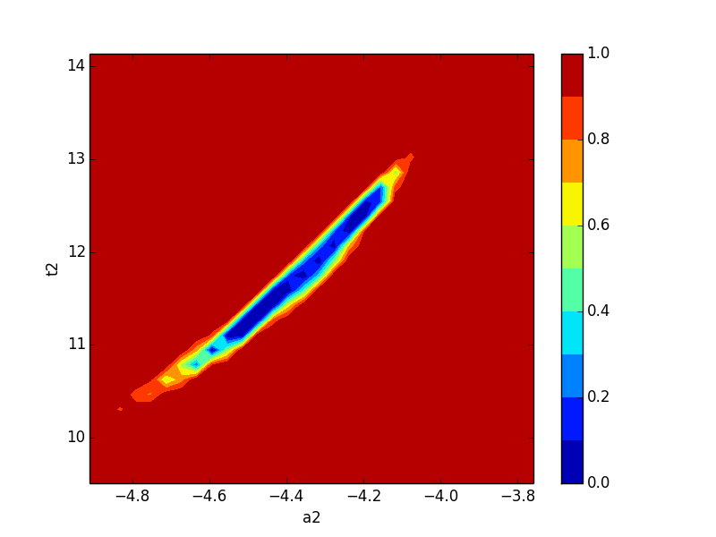

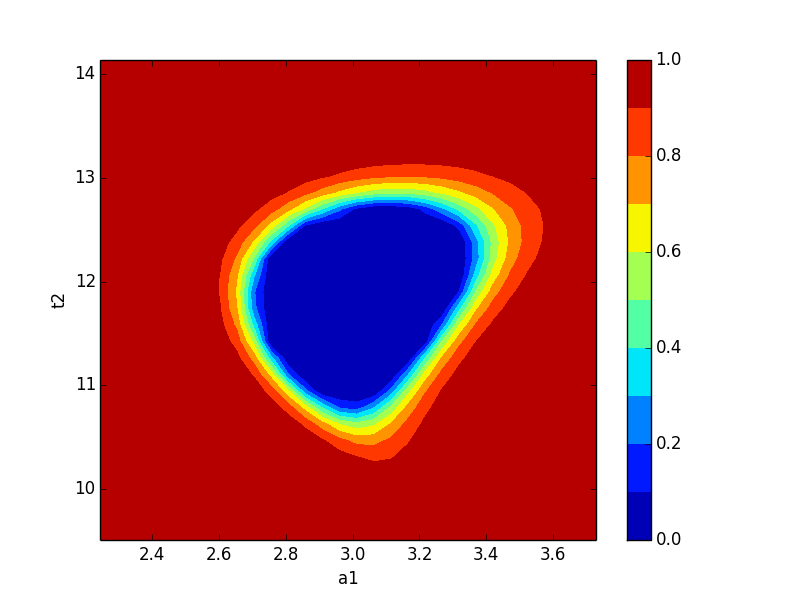

Let plots mad of the confidence region are shown the figure on the left below for a1 and t2, and for a2 and t2 on the right:
Neither of these plots is very much like an ellipse, which is implicitly assumed by the approach using the covariance matrix.

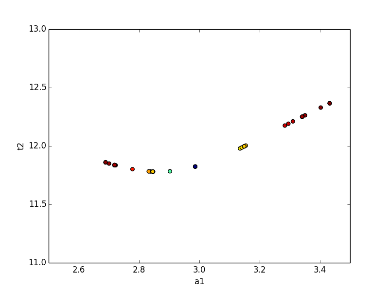

The trace returned as the optional second argument from conf_interval() contains a dictionary for each variable parameter. The values are dictionaries with arrays of values for each variable, and an array of corresponding probabilities for the corresponding cumulative variables. This can be used to show the dependence between two parameters:
>>> x, y, prob = trace['a1']['a1'], trace['a1']['t2'],trace['a1']['prob']
>>> x2, y2, prob2 = trace['t2']['t2'], trace['t2']['a1'],trace['t2']['prob']
>>> plt.scatter(x, y, c=prob ,s=30)
>>> plt.scatter(x2, y2, c=prob2, s=30)
>>> plt.gca().set_xlim((1, 5))
>>> plt.gca().set_ylim((5, 15))
>>> plt.xlabel('a1')
>>> plt.ylabel('t2')
>>> plt.show()
which shows the trace of values:
