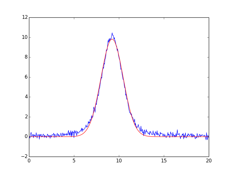

Here, we will fit data to three similar line shapes, in order to decide which might be the better model. We will start with a Gaussian profile, as in the previous chapter, but use the built-in GaussianModel instead of one we write ourselves. This is a slightly different version from the one in previous example in that the parameter names are different, and have built-in default values. So, we’ll simply use:
from numpy import loadtxt
from lmfit.models import GaussianModel
data = loadtxt('test_peak.dat')
x = data[:, 0]
y = data[:, 1]
mod = GaussianModel()
pars = mod.guess(y, x=x)
out = mod.fit(y, pars, x=x)
print(out.fit_report(min_correl=0.25))
which prints out the results:
[[Model]]
gaussian
[[Fit Statistics]]
# function evals = 21
# data points = 401
# variables = 3
chi-square = 29.994
reduced chi-square = 0.075
[[Variables]]
amplitude: 30.3135571 +/- 0.157126 (0.52%) (init= 29.08159)
center: 9.24277049 +/- 0.007374 (0.08%) (init= 9.25)
fwhm: 2.90156963 +/- 0.017366 (0.60%) == '2.3548200*sigma'
sigma: 1.23218319 +/- 0.007374 (0.60%) (init= 1.35)
[[Correlations]] (unreported correlations are < 0.250)
C(amplitude, sigma) = 0.577

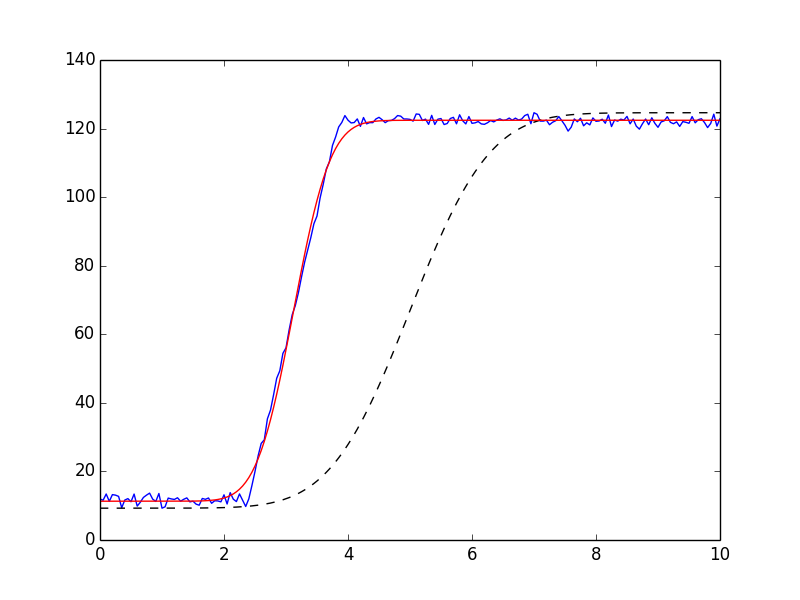

Here, we repeat the point made at the end of the last chapter that instances of model.Model class can be added them together to make a composite model. But using the large number of built-in models available, this is very simple. An example of a simple fit to a noisy step function plus a constant:
#!/usr/bin/env python
#<examples/doc_stepmodel.py>
import numpy as np
from lmfit.models import StepModel, LinearModel
import matplotlib.pyplot as plt
x = np.linspace(0, 10, 201)
y = np.ones_like(x)
y[:48] = 0.0
y[48:77] = np.arange(77-48)/(77.0-48)
y = 110.2 * (y + 9e-3*np.random.randn(len(x))) + 12.0 + 2.22*x
step_mod = StepModel(form='erf', prefix='step_')
line_mod = LinearModel(prefix='line_')
pars = line_mod.make_params(intercept=y.min(), slope=0)
pars += step_mod.guess(y, x=x, center=2.5)
mod = step_mod + line_mod
print(out.fit_report())
plt.plot(x, y)
plt.plot(x, out.init_fit, 'k--')
plt.plot(x, out.best_fit, 'r-')
plt.show()
#<end examples/doc_stepmodel.py>
After constructing step-like data, we first create a StepModel telling it to use the erf form (see details above), and a ConstantModel. We set initial values, in one case using the data and guess() method for the initial step function paramaters, and make_params() arguments for the linear component. After making a composite model, we run fit() and report the results, which give:
[[Model]]
Composite Model:
step(prefix='step_',form='erf')
linear(prefix='line_')
[[Fit Statistics]]
# function evals = 49
# data points = 201
# variables = 5
chi-square = 633.465
reduced chi-square = 3.232
[[Variables]]
line_intercept: 11.5685248 +/- 0.285611 (2.47%) (init= 10.72406)
line_slope: 2.03270159 +/- 0.096041 (4.72%) (init= 0)
step_amplitude: 112.270535 +/- 0.674790 (0.60%) (init= 136.3006)
step_center: 3.12343845 +/- 0.005370 (0.17%) (init= 2.5)
step_sigma: 0.67468813 +/- 0.011336 (1.68%) (init= 1.428571)
[[Correlations]] (unreported correlations are < 0.100)
C(step_amplitude, step_sigma) = 0.564
C(line_intercept, step_center) = 0.428
C(step_amplitude, step_center) = 0.109
with a plot of

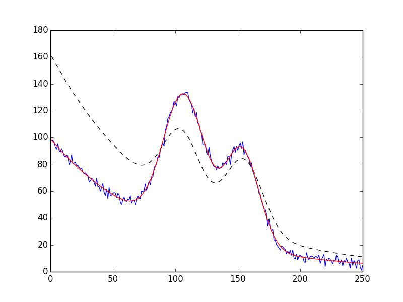

import sys
dat = np.loadtxt('NIST_Gauss2.dat')
x = dat[:, 1]
y = dat[:, 0]
exp_mod = ExponentialModel(prefix='exp_')
pars = exp_mod.guess(y, x=x)
gauss1 = GaussianModel(prefix='g1_')
pars.update( gauss1.make_params())
pars['g1_center'].set(105, min=75, max=125)
pars['g1_sigma'].set(15, min=3)
pars['g1_amplitude'].set(2000, min=10)
gauss2 = GaussianModel(prefix='g2_')
pars.update(gauss2.make_params())
pars['g2_center'].set(155, min=125, max=175)
pars['g2_sigma'].set(15, min=3)
pars['g2_amplitude'].set(2000, min=10)
mod = gauss1 + gauss2 + exp_mod
init = mod.eval(pars, x=x)
plt.plot(x, y)
plt.plot(x, init, 'k--')
print(out.fit_report(min_correl=0.5))
plt.show()
#<end examples/doc_nistgauss.py>
where we give a separate prefix to each model (they all have an amplitude parameter). The prefix values are attached transparently to the models.
MN—-: Note that the calls to make_param() used the bare name, without the prefix. We could have used them, but because we used the individual model gauss1 and gauss2, there was no need.
Note also in the example here that we explicitly set bounds on many of the parameter values.
The fit results printed out are:
[[Model]]
Composite Model:
gaussian(prefix='g1_')
gaussian(prefix='g2_')
exponential(prefix='exp_')
[[Fit Statistics]]
# function evals = 55
# data points = 250
# variables = 8
chi-square = 1247.528
reduced chi-square = 5.155
[[Variables]]
exp_amplitude: 99.0183291 +/- 0.537487 (0.54%) (init= 162.2102)
exp_decay: 90.9508788 +/- 1.103104 (1.21%) (init= 93.24905)
g1_amplitude: 4257.77384 +/- 42.38354 (1.00%) (init= 2000)
g1_center: 107.030955 +/- 0.150068 (0.14%) (init= 105)
g1_fwhm: 39.2609205 +/- 0.377907 (0.96%) == '2.3548200*g1_sigma'
g1_sigma: 16.6725781 +/- 0.160482 (0.96%) (init= 15)
g2_amplitude: 2493.41747 +/- 36.16907 (1.45%) (init= 2000)
g2_center: 153.270103 +/- 0.194665 (0.13%) (init= 155)
g2_fwhm: 32.5128760 +/- 0.439860 (1.35%) == '2.3548200*g2_sigma'
g2_sigma: 13.8069474 +/- 0.186791 (1.35%) (init= 15)
[[Correlations]] (unreported correlations are < 0.500)
C(g1_amplitude, g1_sigma) = 0.824
C(g2_amplitude, g2_sigma) = 0.815
C(g1_sigma, g2_center) = 0.684
C(g1_amplitude, g2_center) = 0.648
C(g1_center, g2_center) = 0.621
C(g1_center, g1_sigma) = 0.507

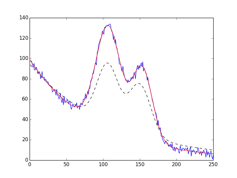

We get a very good fit to this challenging problem (described at the NIST site as of average difficulty, but the tests there are generally hard) by applying reasonable initial guesses and putting modest but explicit bounds on the parameter values. This fit is shown on the left:
One final point on setting initial values. From looking at the data itself, we can see the two Gaussian peaks are reasonably well separated but do overlap. Furthermore, we can tell that the initial guess for the decaying exponential component was poorly estimated because we used the full data range. We can simplify the initial parameter values by using this, and by defining an index_of() function to limit the data range. That is, with:
def index_of(arrval, value):
"return index of array *at or below* value "
if value < min(arrval): return 0
return max(np.where(arrval<=value)[0])
ix1 = index_of(x, 75)
ix2 = index_of(x, 135)
ix3 = index_of(x, 175)
exp_mod.guess(y[:ix1], x=x[:ix1])
gauss1.guess(y[ix1:ix2], x=x[ix1:ix2])
gauss2.guess(y[ix2:ix3], x=x[ix2:ix3])
we can get a better initial estimate, and the fit converges in fewer steps, getting to identical values (to the precision printed out in the report), and without any bounds on parameters at all:
[[Model]]
Composite Model:
[[Fit Statistics]]
# function evals = 46
# data points = 250
# variables = 8
[[Variables]]
exp_amplitude: 99.0183281 +/- 0.537487 (0.54%) (init= 94.53724)
exp_decay: 90.9508863 +/- 1.103105 (1.21%) (init= 111.1985)
g1_amplitude: 4257.77321 +/- 42.38338 (1.00%) (init= 2126.432)
g1_center: 107.030954 +/- 0.150067 (0.14%) (init= 106.5)
g1_fwhm: 39.2609141 +/- 0.377905 (0.96%) == '2.3548200*g1_sigma'
g1_sigma: 16.6725754 +/- 0.160481 (0.96%) (init= 14.5)
g2_amplitude: 2493.41766 +/- 36.16948 (1.45%) (init= 1878.892)
g2_center: 153.270100 +/- 0.194667 (0.13%) (init= 150)
g2_fwhm: 32.5128777 +/- 0.439866 (1.35%) == '2.3548200*g2_sigma'
g2_sigma: 13.8069481 +/- 0.186794 (1.35%) (init= 15)
This example is in the file doc_nistgauss2.py in the examples folder, and the fit result shown on the right above shows an improved initial estimate of the data.
