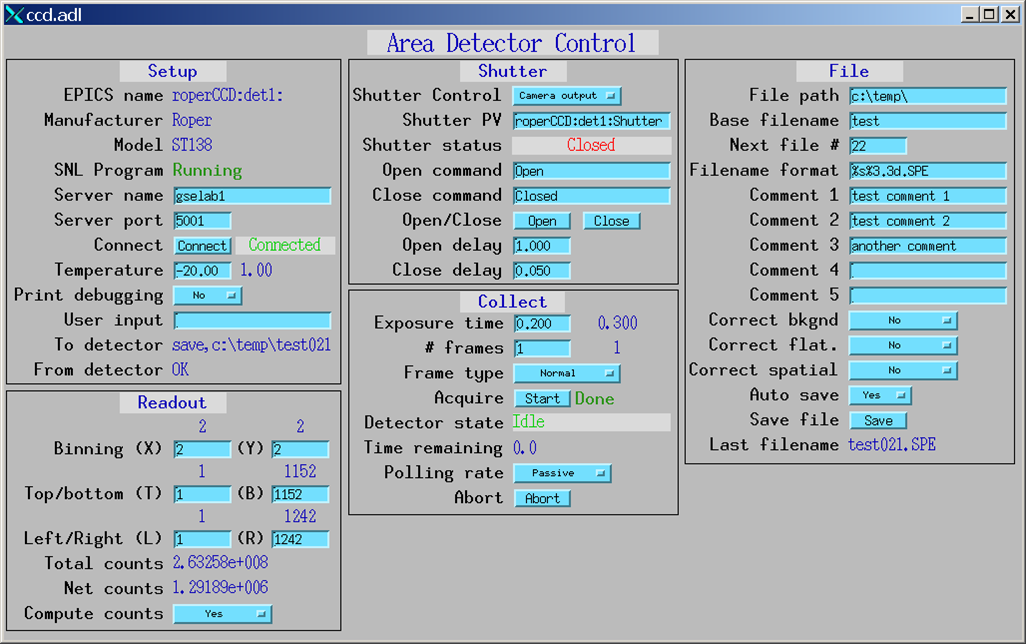

MEDM User Interface
This screen is the complete collection of PVs. Not all of these PVs are
implemented for any particular detector type, depending upon the limitations in
the manufacturers control software.

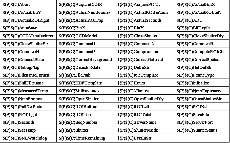

EPICS Process Variables (PVS)

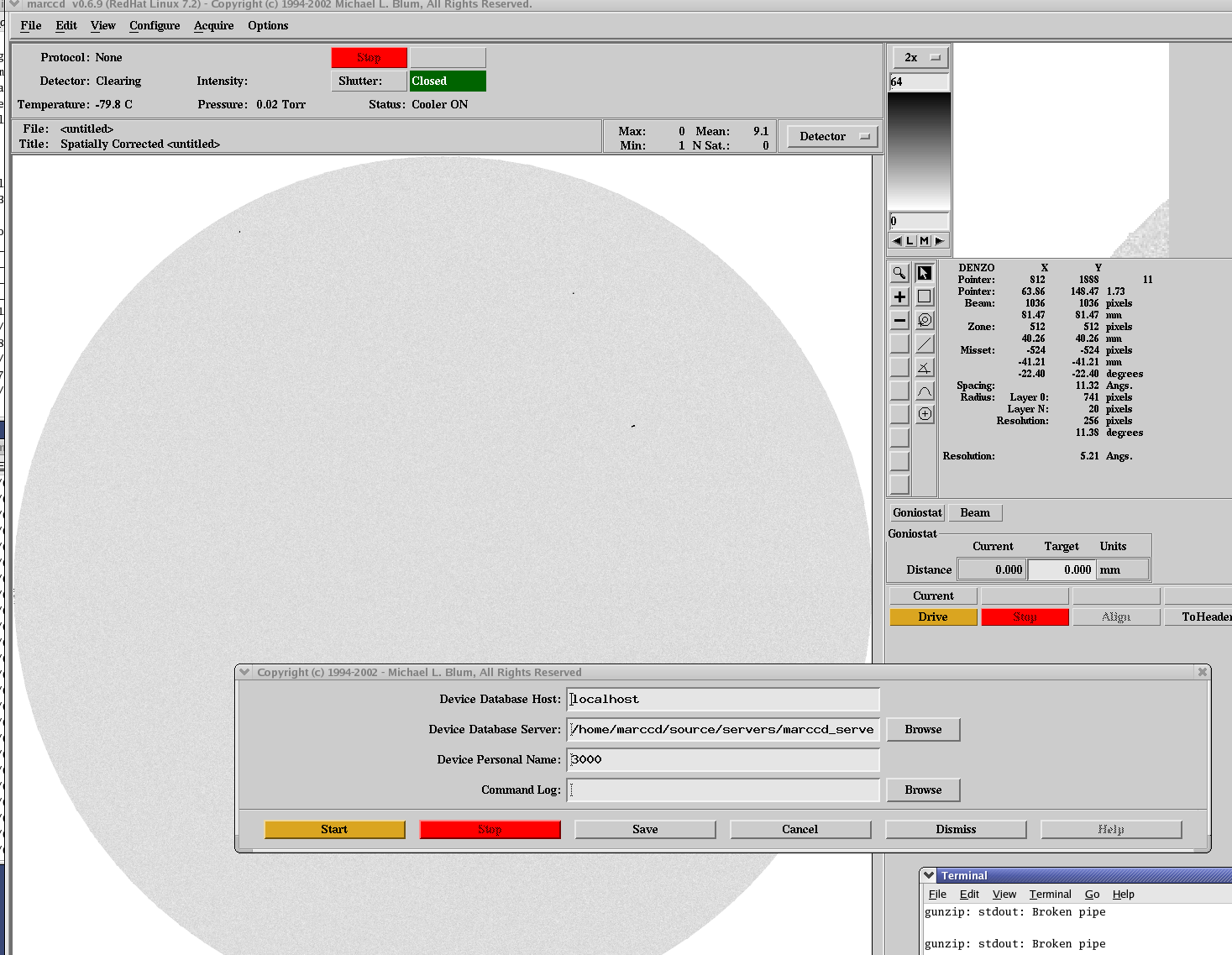

marCCD interface

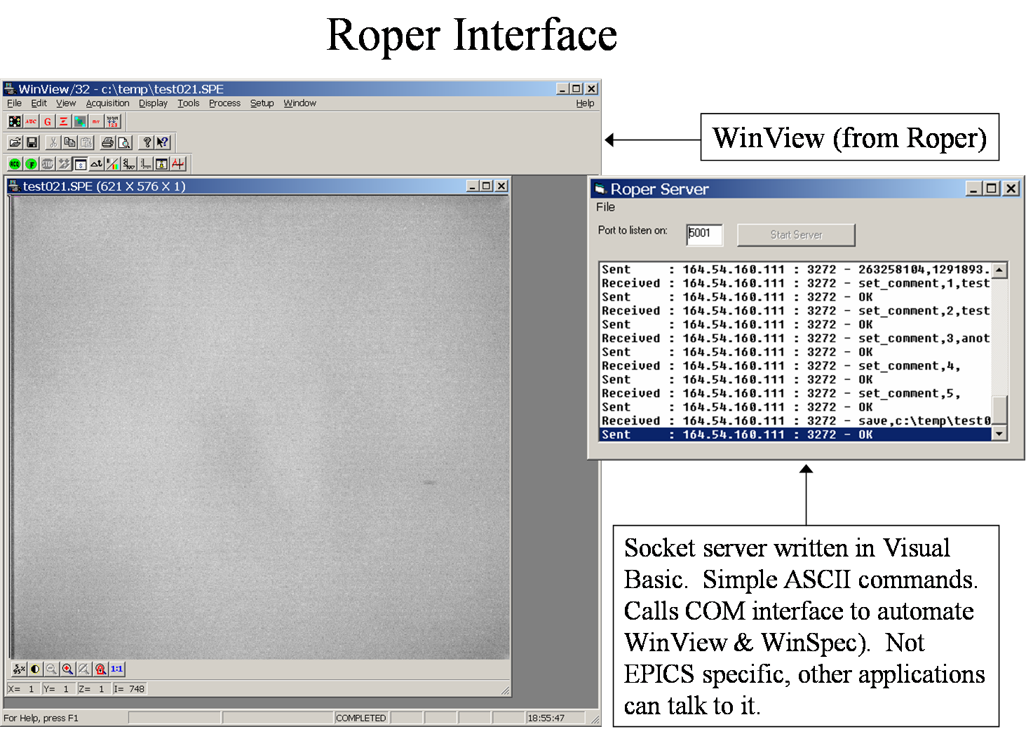

Roper Interface
