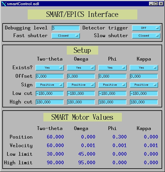

The following shows the MEDM screen (smartControl.adl)
with which the user can view and modify the smartControl
database parameters. smartControl.adl is called with
macro parameters P and R. These are the
prefix and record base used when the database was loaded.
Debugging level is used to control debugging
print statements to the vxWorks console port. The values range
from 0 (no output), 1 (errors and warnings only) through 5
(maximum amount of debugging output). This output can be useful
for seeing what commands are being received from SMART, and the
responses being sent back to SMART. Note, however, that debugging
output reduces the performance of smartControl and
so Debugging level should normally be set to 0.
Detector trigger, Fast shutter and Slow
shutter are used to monitor the state of these control
signals, and also to change them manually if desired.
Under the Setup menu are 5 controls for each
motor.
Exists is a flag which is used to signal
whether or not a given axis actually exists. If an axis
does not exist then smartControl will not
attempt to communicate with that EPICS motor.Offset and Sign are used to
convert from the EPICS motor coordinate system to the
SMART coordinate system. The equation relating the two is
EPICS = Offset + Sign*SMART. If the
coordinate systems are the same then Offset
should be 0 and Sign should be Positive
(1). If the sign convention is different for EPICS and
SMART then Sign should be Negative
(-1).High cut and Low cut are used
to determine when the axis should "roll-over"
by 360 degrees. The relationship, in EPICS motor
coordinates, is:High
cut then the target position is
decremented by 360 degrees. Low cut
then the target position is incremented by 360
degrees.Under the SMART Motor Values screen are 4 values for each motor.
Position is the last position which SMART
commanded this motor to move to. If the motor has never
been told to move by SMART then this value will be 0.Velocity is the last velocity command which
SMART issued for this motor. If the motor has never been
sent a velocity command then this value will be 0.Low limit and High limit are
