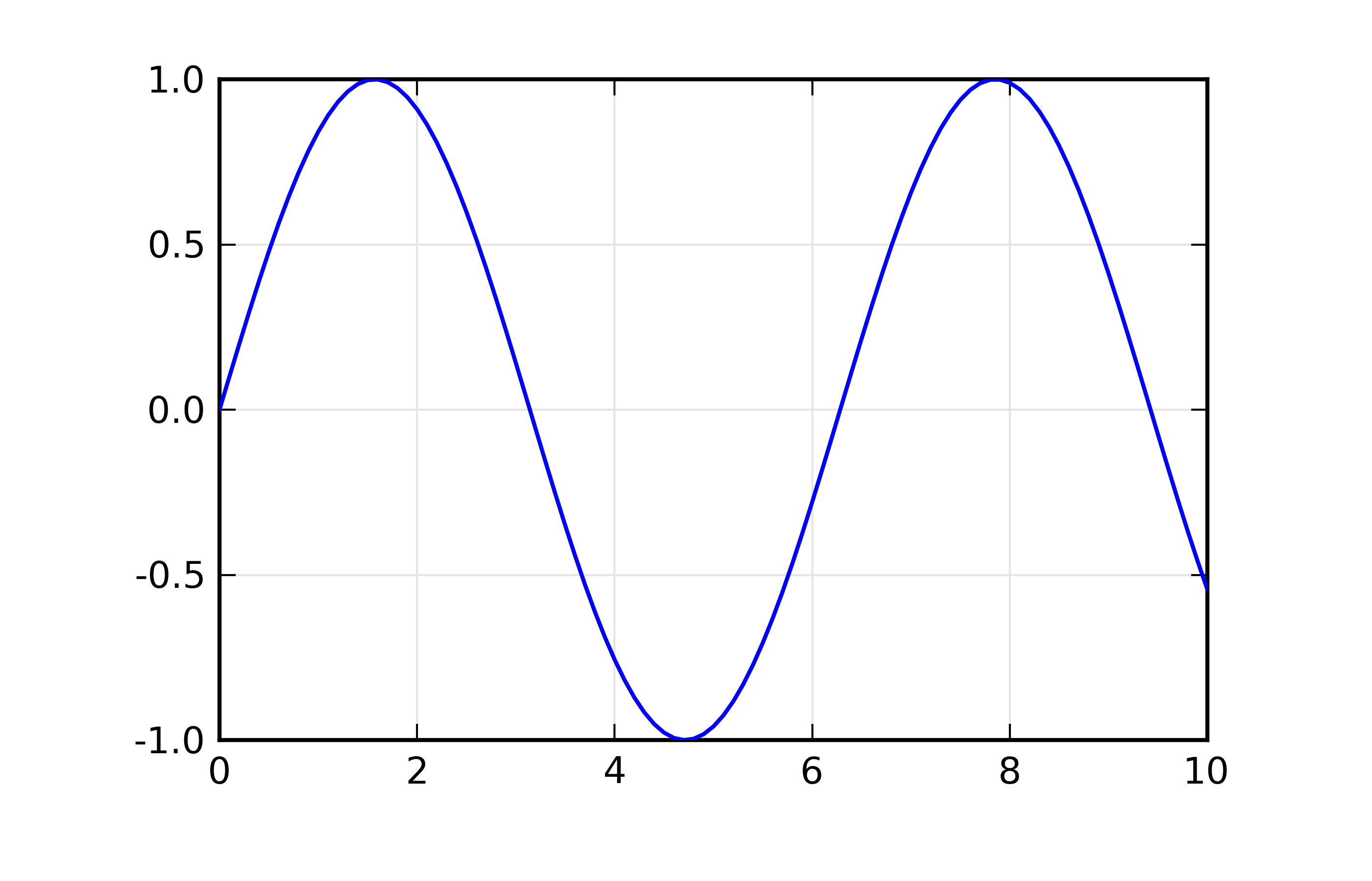

x = linspace(0, 10, 101)
y1 = sin(x)
y2 = -2 +0.2*x + (0.2*x)**2
newplot(x, y1)
will make this plot:
../_images/plot_basic1.png
Figure 9.1.1 A basic line plot.

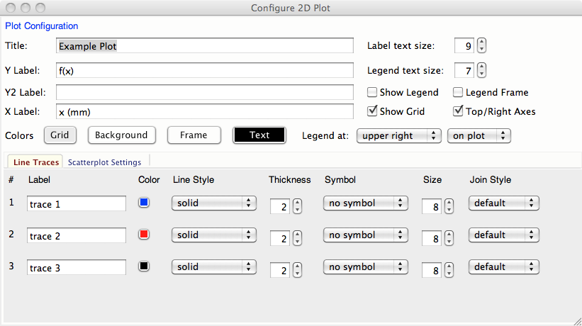

Adding a second curve, and setting some labels:
plot(x, y2, xlabel='x (mm)', ylabel='f(x)', title='Example Plot')
../_images/plot_basic2.png
Figure 9.1.2 A line plot with two curves.

Configuring the Plot:
From the Plot Window, either Ctrl-K (Apple-K for Mac OS X users) or Options->’Configure Plot’ (or right-click to bring up a popup menu, then select Configure) will bring up the plot configuration window, which looks like this:
../_images/plot_config.png
Figure 9.1.3 Screenshot of the Configuration window for Plots.
From here you can set the titles, axis labels, and styles, colors, symbols, labels, and so on for each of the line traces drawn.

When using the Plot Configuration window to enter a TeX-like string, the text control box will be given a yellow background color (instead of the normal white color) if there is an error in rendering your TeX string.

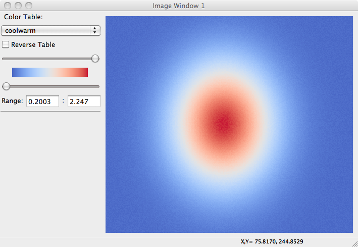

## examples/plotting/doc_image2d.lar
def gauss2d(x, y, x0, y0, sx, sy):
    return outer(exp(-(((y-y0)/float(sy))**2)/2),
                 exp(-(((x-x0)/float(sx))**2)/2))
enddef
ny, nx = 350, 400
ix = arange(nx)
iy = arange(ny)
x  =  ix / 10.
y  = -2 + iy / 10.0
dat = 0.2 + (0.05*random.random(size=nx*ny).reshape(ny, nx) +
             2.0*gauss2d(ix, iy, 190,   176,  57,  69))
imshow(dat, x=x, y=y, colormap='coolwarm')
## end of examples/plotting/doc_image2d.lar
is shown below:
../_images/plot_image1.png
Figure 9.2.1 A false-color display of 2 dimensional image data.

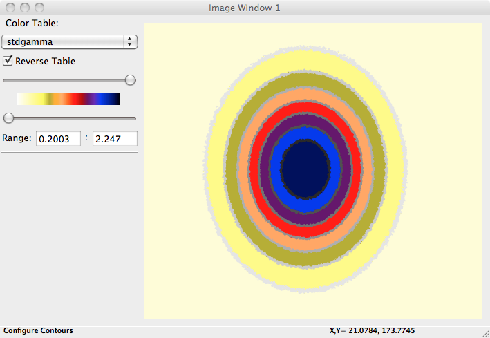

and as a contour plot, with a different color table:
../_images/plot_contour1.png
Figure 9.2.2 A contour plot of 2 dimensional image data.

larch> x = linspace(0, 10, 101)
larch> y = sin(x)
larch> plot(x, y)
larch> display = get_display(win=1)
larch> axes = display.pane.axes

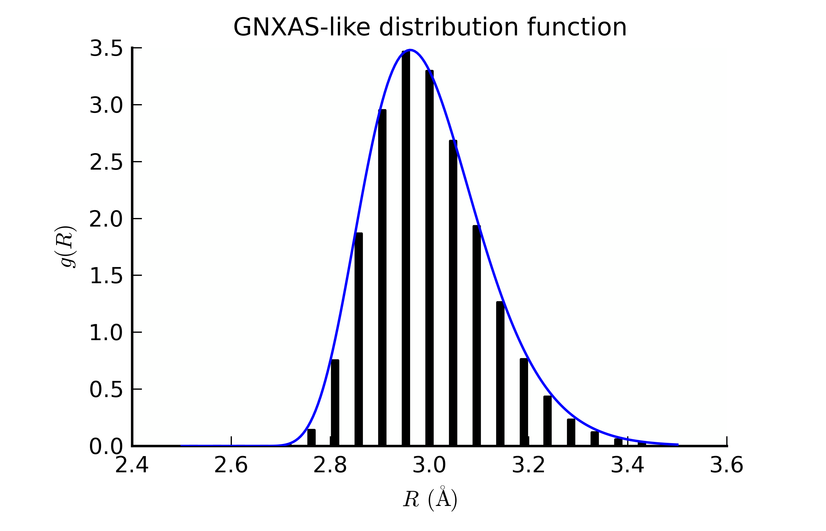

As an example of what you can do with this, here we make a histogram plot from a sampling of a more conitinuous distribution. This uses matplotlib’s hist() function,
## examples/plotting/doc_use_mpl.lar
from scipy.special import gamma
title = 'GNXAS-like distribution function'
sigma, beta, r0 = 0.12, 0.65, 3.0
q    = 4/beta**2
amp  = 2 / (sigma*abs(beta)*gamma(q))
# calculate g(r) on a fine r-grid:
r   = linspace(2.5, 3.5, 201)
arg = q + (2*(r-r0)) / (beta*sigma)
gr  = amp * exp(-arg)*arg**(q-1)
# note removal of nan's and impossible values
gr[isnan(gr)] = 0
if min(gr)< 0: gr[where(gr<0)] = 0
# standard plot of g(r)
newplot(r, gr, grid=False,
        xlabel=r'$R\,\rm(\AA)$', ylabel=r'$g(R)$',
        title=title, fullbox=False)
# calculate g(r) on a coarse r-grid:
hr   = linspace(2.5, 3.5, 21)
harg = q + (2*(hr-r0)) / (beta*sigma)
hgr  = amp * exp(-harg)*harg**(q-1)
hgr[isnan(hgr)] = 0
if min(hgr)< 0:  hgr[where(hgr<0)] = 0
# get panel, matplotlib axes
panel = get_display().panel
axes  = panel.axes
# plot histogram of coarse-grid data
histo = axes.hist(hr, weights=hgr, bins=len(hr), rwidth=0.25, color='k')
panel.draw()
## end of examples/plotting/doc_use_mpl.lar
which generates a plot that looks like
../_images/plot_histogram.png
Figure 9.3.1 A histogram plot made using matplotlib’s hist() function.
