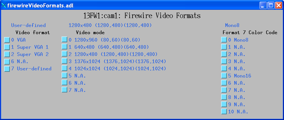

The following show the MEDM screens that are used to control the Firewire detectors. Note that the general purpose screen ADBase.adl can be used, but it exposes some controls that are not applicable to Firewire cameras, and lacks many fields that are important for such cameras.
FirewireFeatures.adl
is the screen used to control the features of Firewire cameras.
FirewireVideoFormats.adl
is the screen used to control the video formats and modes of Firewire cameras.
This is a screen shot when the camera is not in Format 7.
This is a screen shot when the camera is in Format 7, in which case the video rate menu is not displayed.
