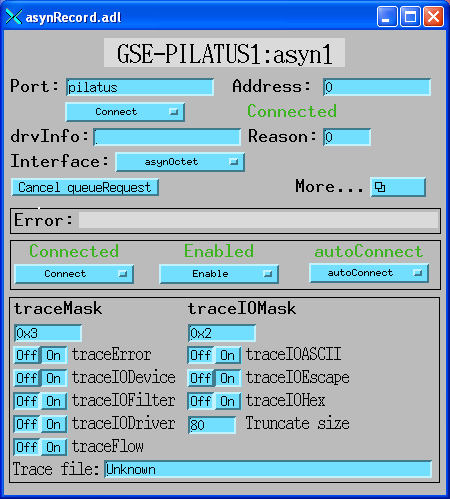

# Load an asyn record for debugging
dbLoadRecords("$(ASYN)/db/asynRecord.db", "P=PILATUS:,R=asyn1,PORT=pilatus,ADDR=0,IMAX=80,OMAX=80")

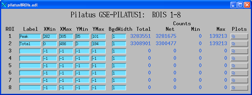

pilatus8ROIs.adl is used to define the ROIs, and to display the statistics for
each ROI. In this example there are 2 valid ROIs defined. ROI 1 is a small rectangle near the center
containing the Bragg diffraction peak from a crystal. ROI 2 is the entire chip.

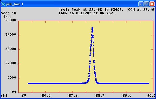

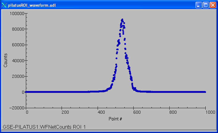

pilatusROI_waveform.adl is used to plot the net or total counts in an ROI when
NImages>1. In this example the plot is the net counts in ROI 1 as the diffractometer chi was scanned
+- 1 degree with 1000 points at .02 seconds/point. This was done with the SPEC command
lup chi -1 1 1000 .02using trajectory scanning on a Newport kappa diffractometer. This was a compound motor scan with the Newport XPS putting out pulses every .02 seconds. These pulses triggered the Pilatus in External Enable mode. The pilatusROI program read each TIFF file as it was created and updated this plot every 0.2 seconds. The total time to collect this scan with 1000 images was 20 seconds.

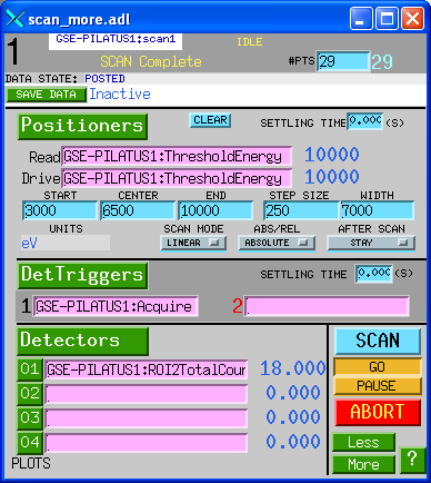

scan_more.adl is used to define a scan. In this example the sscan record is set up
to scan the ThresholdEnergy PV and to collect the total counts in ROI2, which was defined to include
the entire detector.

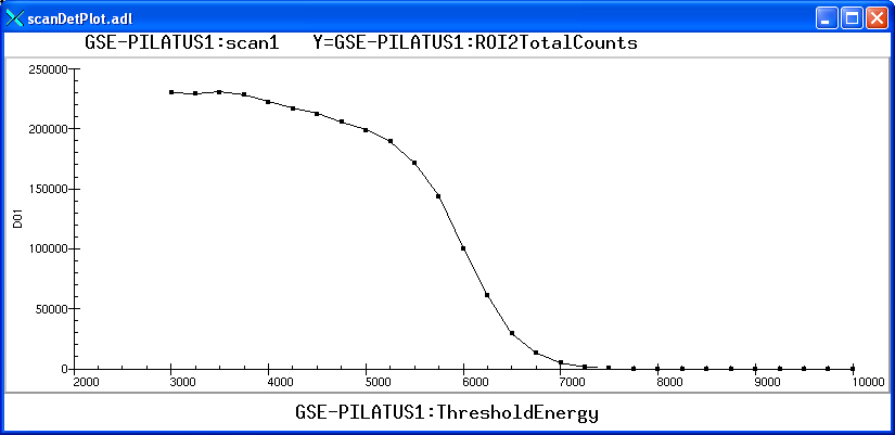

scanDetPlot.adl is used to plot the results of a scan after it is complete.
In this example the total counts in ROI 2 are plotted as a function of the ThresholdEnergy as it was
scanned from 3000 to 10000 eV in 250 eV steps. The source was Fe55, and the cut-off is at 6 keV, as
expected for the Mn Ka and Mn Kb x-rays that this source produces.
asynRecord.adl is used to control the debugging information printed by the asyn TCP/IP driver
(asynTraceIODriver) and the SNL program (asynTraceIODevice).

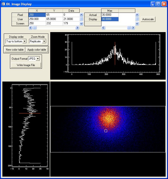

The control window for epics_image_display is shown below. It has fields to input the name of
the EPICS PV with the image data, which is $(DET)ImageData in the case of pilatusROI. It also has fields
for the number of pixels in the X and Y directions. This is needed because EPICS waveform records are
1-dimensional only, and so do not contain the information on the number of rows and columns in the image.
epics_image_display uses the routine
image_display.pro
to display the images. This routine displays row and column profiles as the cursor is moved. It allows
changing the color lookup tables, and zooming in and out with the left and right mouse buttons. The following
is an example of image_display displaying a Pilatus image with an Fe55 source in front of the detector.

lup chi -2 2 1000 .015
This tells SPEC to do a relative scan of the chi axis from -2 degrees to +2 degrees with 1000 points
at .015 seconds/point. On our kappa diffractometer this entails a coordinated motion of the phi, kappa
and omega axes. The EPICS trajectory scanning software downloads the non-linear trajectory that SPEC computes
into the XPS controller, which executes it. As the motors are moving the XPS outputs synchronization pulses
at the period of the collection time, .015 seconds in this case. These pulses are stretched
(see Hardware notes below) and used as the external input to the Pilatus.
The time to execute this scan should be 15.0 seconds. The actual time was 16.3 seconds, measured
using camonitor on the Acquire PV. Again, this includes the time for camserver to save all 1000 images to disk
(366 MB), and for pilatusROI to read each file, correct the bad pixels and flat field, compute the ROIs, and post the ROIs
to EPICS. It also posted the images to EPICS at 1Hz (15 images total). The total additional time was less
than 1.3 seconds for all 1000 images. As soon as the acquisition was complete SPEC plotted the net counts in
the first ROI (containing the Bragg peak) as follows:
