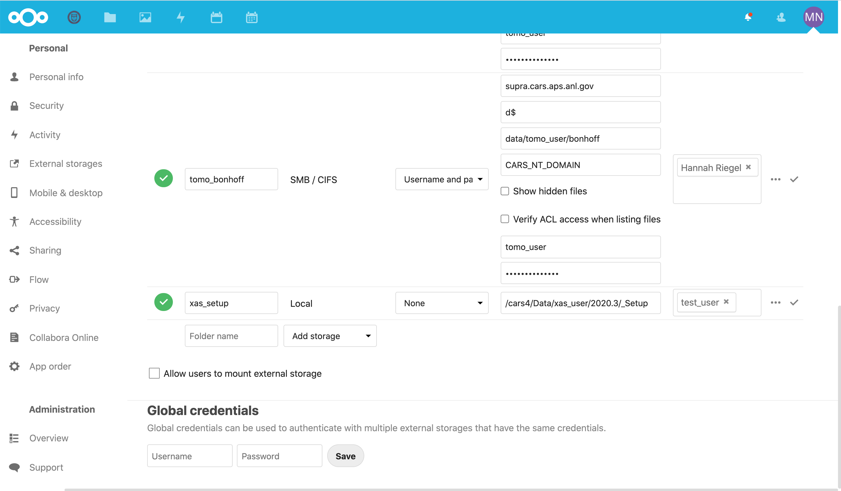

This will show a list of the currently active external shares. Browsing to the bottom of that page, you will see an “Add Storage” menu:
_images/StaffAddStorage.png
Add External Storage Page: Select “Local” or “SMB/CIFS” from the “Add storage” menu, then give that share a name and add users who should have access to that data.
From here you can add either Local storage to a share that is already mounted from millenia, or select SMB/CIFS to share data from any of the shares available in the CARS Windows domain. Note that there are other options too, but most of these are not actually configured.
Most of the shares for user data will be to /cars5/Data or /cars4/Data, which are already mounted as “Local”, so you can just give the full path to the folder to share, such as:
/cars5/Data/dac_user/2020/IDD_2020-2/CARS/

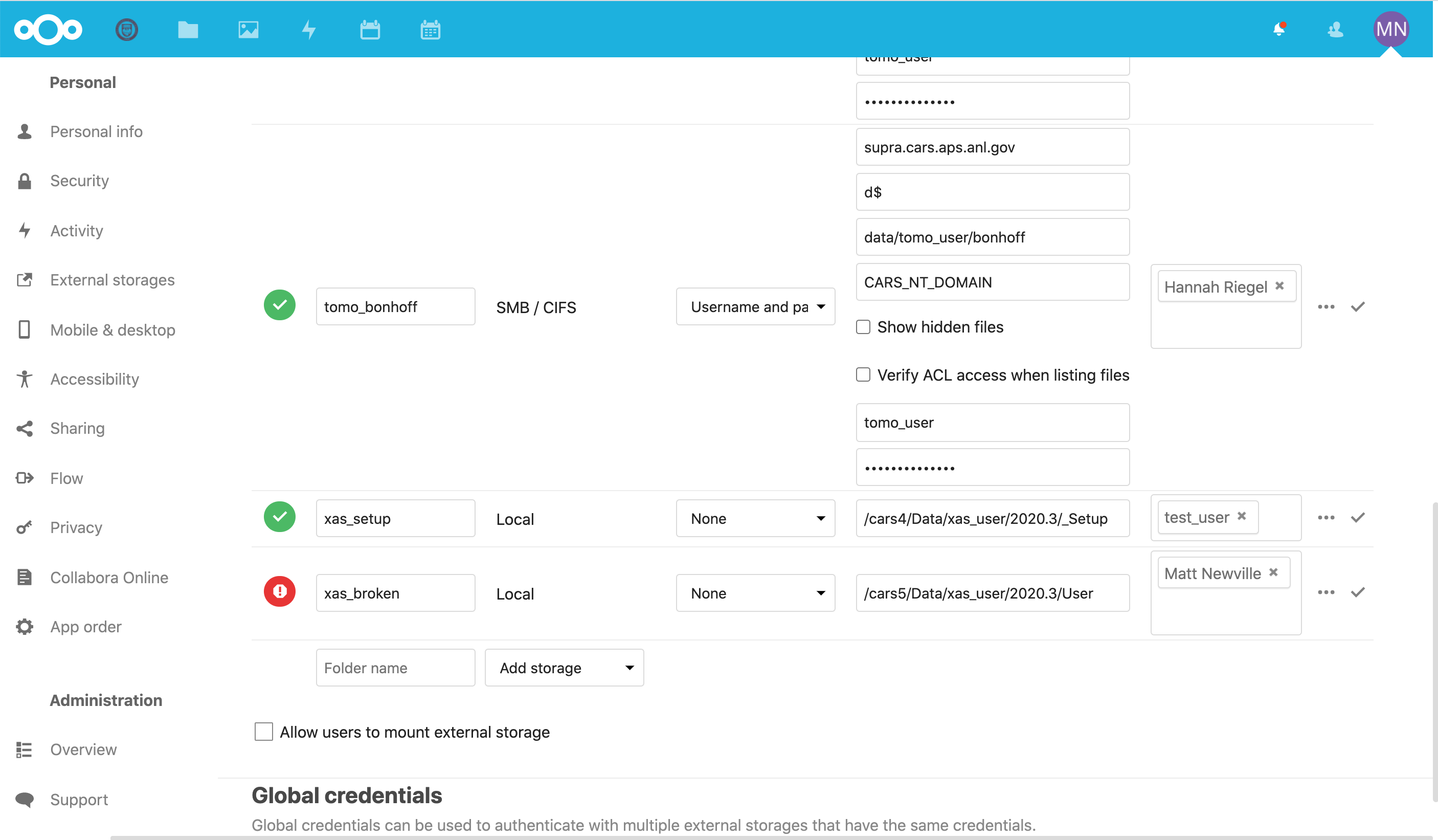

Give that folder a name (preferrably following the convetion of lvp_username, dac_username, etc just so we can all keep them organized),then select from the dropdown list which users to share with, and click the Checkmark. If it all works, the icon on the left will be a green checkmark, and if there is a problem (like, the share does not exist or was mispelled), it will show as a red exclamation point. Note that millenia mounts these shares as Read-only so the beamline data cannot be erased or changed by the remote users share of the data.
