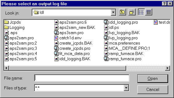

you’ll get a popup screen like this:
From the Look in: window, select your current working folder (the one that you want to save all your data files), and give the logging file a name corresponding to your run number. For example, if you run is T0208, then name your logging file as T0208.log.

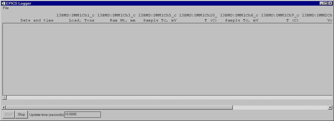

After you hit the Open button, you’ll get the logging displayed like this:
You can resize the window by dragging the margins to show more data. You can also change the time interval between the data recorded and stop and restart the logging again.
Note: the data channels being logged are specified in
another file called lvp_logging.inp, on
P:\lvp_user. You’ll need to modify this file if you
need to change the data to be logged.
