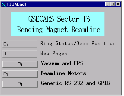

1. MEDM: To run all beamline motion controls
Choose Start > Programs > EPICS WIN32 Extensions in the Start menu of LeBaron. You’ll get the following popup window:

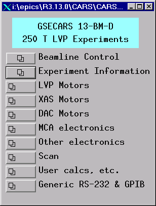

Click File, and Open the file named 13BMD.adl
This will open the main control window called 13BMD.adl:
13BMD.adl
    Be sure to select Execute button in the MEDM.EXE popup!! Select each field by dragging the mouse in the corresponding button. Keep the left mouse button pressed when going to the next level of selections.  The first five buttons will allow you to control various components of the LVP setup:
HH01515A.gif (970 bytes)Beamline Control: beam status, equipment protection system (EPS) status, beamline slits (in BM-A and BM-D) etc.
Experiment Information: Allows you to enter specific information on the particular run (the info will be saved in the MCA file, so remember to upgrade the information relevant to each particular spectrum).
HH01515A.gif (970 bytes)LVP Motors: essentially ALL motors for LVP operation
HH01515A.gif (970 bytes)MCA electronics: electronics for the multi-channel analyzer (MCA).  Canberra amplifier, A to D converter (ADC), etc.
HH01515A.gif (970 bytes)Other electronics: Stanford Research Systems (SRS) preamps (# 2 is used for photo diode input and output); Scaler (used for clock and photo diode readings); Keithley (used for logging in ram position LVDT, pressure, temperature, heater cureent, voltage, thermocouple emfs, etc.); Digital-analog converter (DAC; used for controlling heating power supply).
HH01515A.gif (970 bytes)Scan: used for scanning any positioners (a motor, a cmpound motor, or anything that can be "moved").

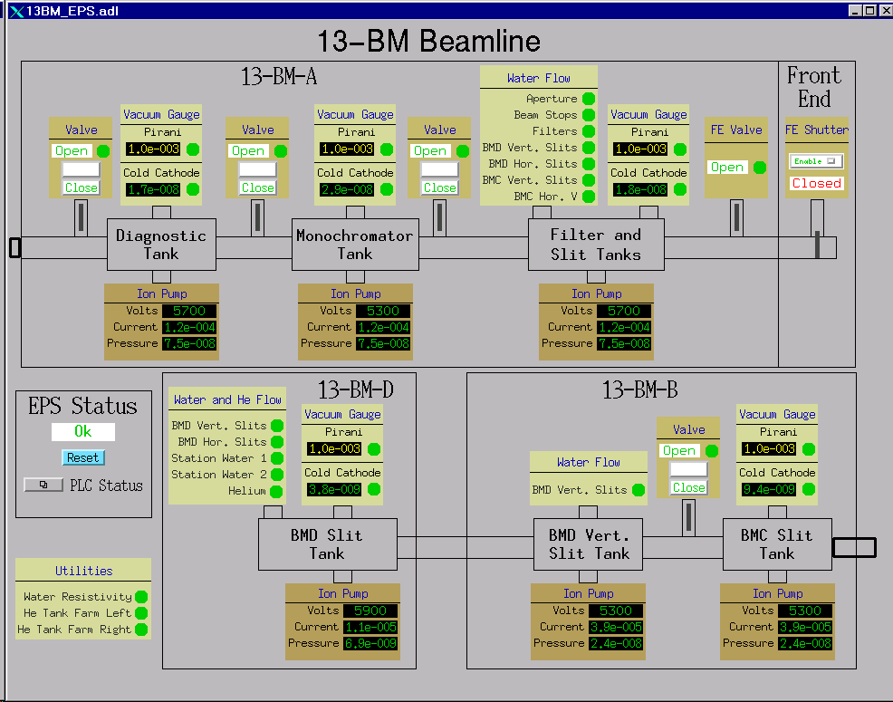

1.1. Beamline Control

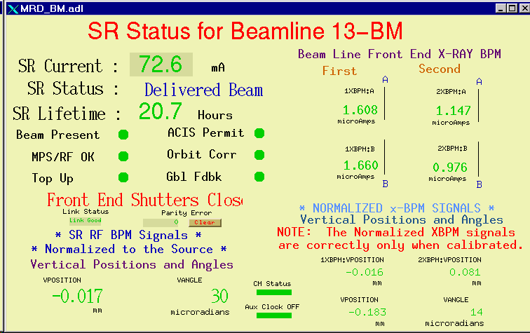

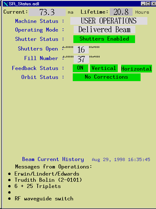

Ring Status/Beam Position
Storage Ring Status [SR_Statis/adl]
13-BM Beam Position Monitors [MRD_BM.adl]
Web Pages
Vacuum and EPS
The green dots will become red when any equipment protection system (EPS) fails and the beam will be disabled. Report any faults to Yanbin.

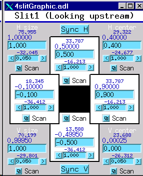

FOE Slits (compound) [4slitGraphic.adl]
Controls beam size and position using the slits in 13-BM-A (first optics enclosure or FOE). Use this record instead of the "individual" motor record (below) for motor controls.

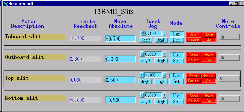

FOE Slits (individual) [4motors.adl]

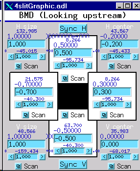

BMD Slits (compound) [4slitGraphic.adl]
Controls beam size and position using slits in the slit tank at 13-BM-D (the upstream tank).  Use this record instead of the "individual" motor record (below) for motor controls.
BMD Slits (individual)

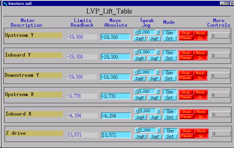

        For controls of LVP positions, choose LVP Lift Table.  You have two choices: compound and simple.   ALWAYS USE THE COMPOUND VERSION FOR EXPERIMENTAL CONTROL!
LVP lift table (simple) [6motors.adl]
    This record gives positions of individual motors for the LVP lift table. Because both linear translation and rotation of the press require multiple motors, in actual control you need to run using the compound record.

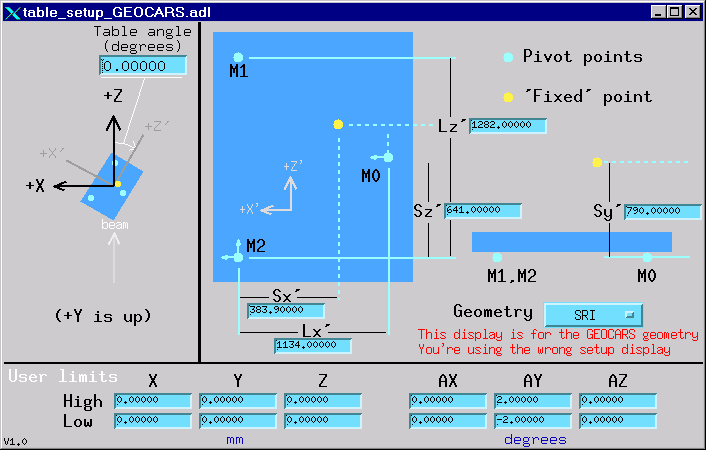

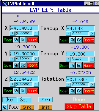

LVP lift table (compound) [LVPtable.adl]
    Click "more" for geometry description:
    To check geometry set up, choose "Setup (GEOCARS geometry)".  Note we are using the GSECARS geometry:

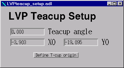

    To set up T-Cup geometry, choose "Setup teacup geometry":
    In T-Cup setup, make sure the "Teacup angle" is at 35.2644 degrees for T-Cup operation.  You can set up T-Cup origin at any time during the experiment.  A good practice is after you have centered the sample using the LVP lift table (compound), set that point as T-Cup origin, so you can scan in the T-Cup X and Y directions.

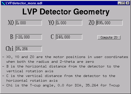

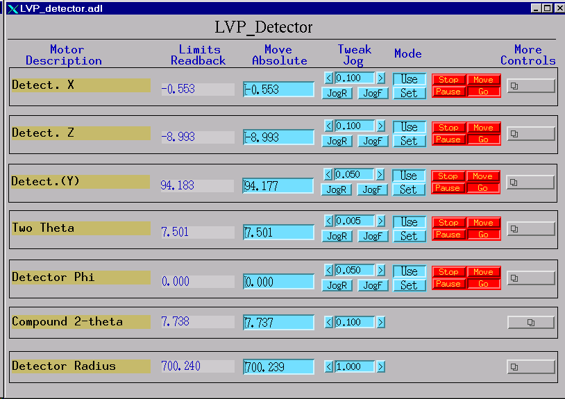

LVP detector [LVP_detector.adl]
This record controls positions of the detector.  In DIA mode, Detector Phi must be zero. For T-Cup mode, the true two theta angle is decomposed into two angles, Two Theta and Detector Phi. Only Compound 2-theta will give you the true value.
Click on the far right button for Compound 2-theta, to open the following window:
Be sure that the Chi angle is set at 35.264 degrees. The Parameters for Z0, B, and C should be set as above.

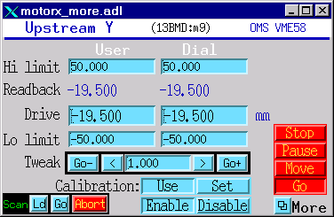

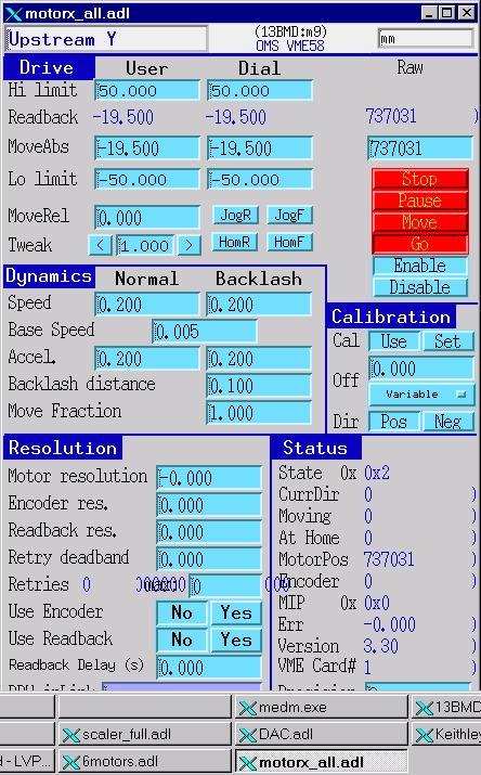

For each motor, "More Controls" gives you more information in three options
More
All     Gives all the information about driving this motor.
Scan Parameters
Helps load scan parameters for this motor to the scan record.
   Typically, use "Relative" and select "Prior Pos" so the motor will return to its position before the scan. Choose range by giving start and end points, and step size by giving number of points. Click "Load" to load the parameters to the scan record.

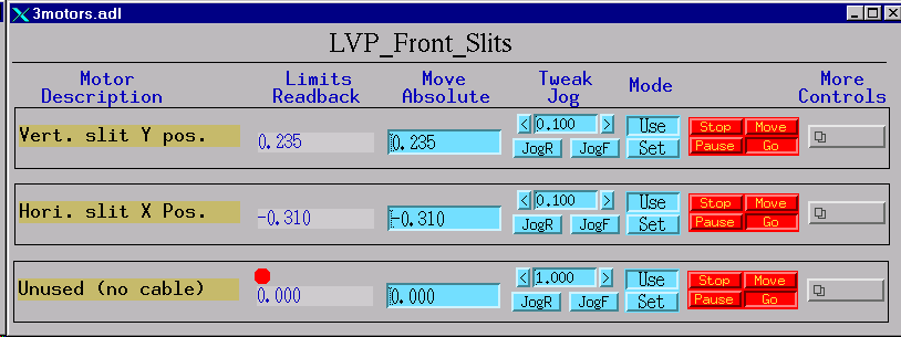

LVP front slits [3motors.adl]

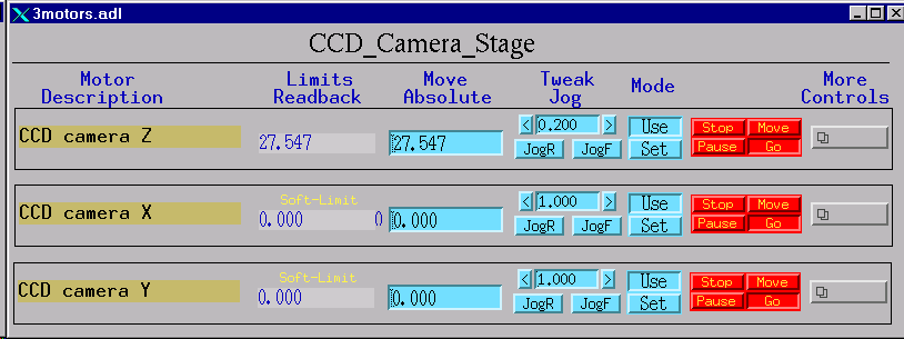

CCD camera stage [3motors.adl]

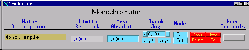

monochromator [1motors.adl]

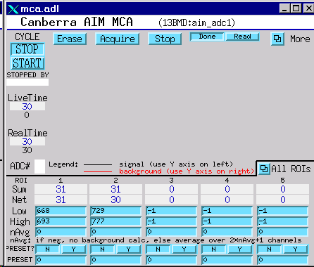

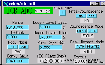

        1.3. MCA Electronics
    Note: this is NOT used for collecting data from the MCA, but to set up the electronics.

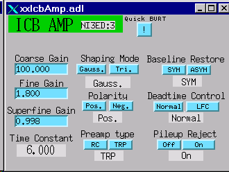

Canberra Spectroscopy Amplifier [xxlcbAmp.adl]
Canberra ADC [xxclbAdc.adl]

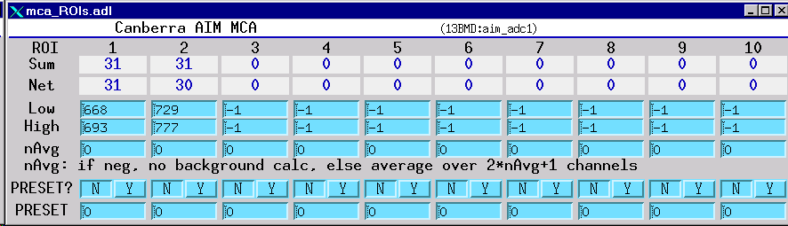

MCA Regions of Interest [mca_ROIs.adl]
MCA Plot [mca.adl]

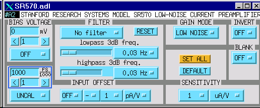

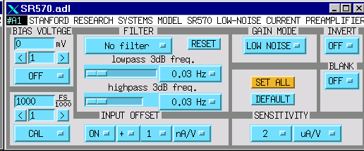

SRS Current preamplifier 2 is for the photo diode (beam intensity monitor),

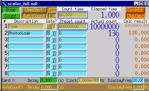

Scaler for clock and photo diode readings,

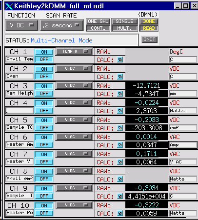

Keithley 2000 DMM for logging voltage, current, thermocouple, LVDT, pressure, etc. information.
DAC for sending control signal (0-10 VDC) to the power supply for heating.
SRS current preamplifier 1 [SR570.adl]
SRS current preamplifier 2 [SR570.adl]
    You can change the settings on the SRS preamps remotely by clicking these buttons.  Especially, if the photo diode readings are around 640,000, it means it is saturated.  You should (1) reduce the beam, and (2) change the sensitivity (say, from nA to microA).
Scaler [scaler_full.adl]

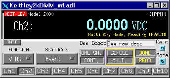

Kiethley 2000 DMM
First click on Keithely 2000 DMM will bring you to the following window:
Click on "More" and select "Multi-channel screen" will bring you to the following window.  Remember to close the single-channel screen.
    Make sure you click on the "INIT" bottom to activate the Keithley.  Also make sure the "SCAN RATE" button is set at scan option (i.e., a rate is given, such as 0.1 second, 0.2 second, etc, NOT set at "EVENT" or "Passive").  Clicking on the "CALC" button next to any channel will open the calculation window (see below).   You'll see that the number under "Result" gets updated every few seconds.

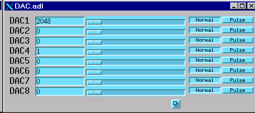

DAC [DAC.adl]
    DAC controls the AC power supply by sending a DC voltage signal to the supply.  The DC signal is from 0 to 10 V, corresponding to the output AC voltage from 0 to maximum (which i sset up by chossing cable setups on the supply).

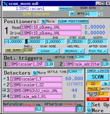

        1.5. Scan
    Used for scanning any positioners (a motor, a compound motor, or anything that can be controlled to "move") while watching any detectors (time, intensity of the photo diode, ROIs in the MCA, or anything that can be measured).
Scan 1 [scan_more.adl]
Enter the following fields:

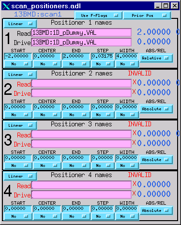

Positioners 1 can be loaded for any positioners either by typing the positioner’s PV name, or by clicking the scan button on a Positioners Window, e.g. see for example the LVP Lift Table. Dummy positioners can be used by clicking on the "USE DUMMY" button. This allows you to perform multiple MCA data collections while watching temperature or other parameters, without moving any positioners.
2, 3, and 4 are for 2-D, 3-D, and 4-D scans
Under the positioner "More" button, there are two options.
"Positioners 1 – 4" allows you to enter up to four positioner for each scan.

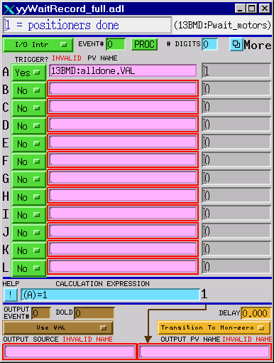

"Positioner Waits" allows you to set up positioner waits (our default is Alldone)

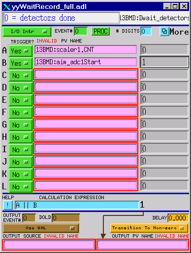

Det. triggers
1: 13BMD:Scaler.CNT VAL:1.0
2: 13BMD:aim_adc1Start.VAL VAL:1.0
Detectors 1: the clock (13BMD:Scaler1.T)
2: the photodiode (13BMD:Scaler1.S2)
3: temperature (in this example) 13BMD:DMM1Ch10_calc.VAL (chan. 10 of the Kiethley)
4: one ROI (again in this example) (13BMD:aim_adc1.R1)
Under "More"> "Detectors 1-15", you can enter up to 15 detectors.
Under "More"> "Detector waits", set up detector waits:
In "CALCULATION EXPRESSION", A | | B = A or B
See scan record documents in 13-BM-D LVP Operations Instruction notebook.

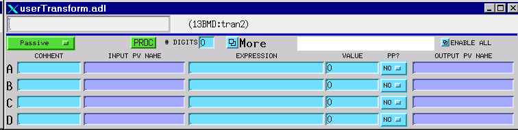

        1.6. User Calcs, etc.
User Transform 1 [userTransform.adl]
User Transform 2 [usedrTransform.adl]

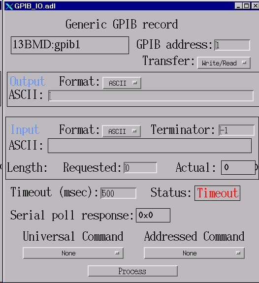

        1.7. Generic RS-232 & GPIB
GPIB 1 [GPIB_IO.adl]
Serial 1

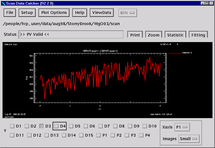

2. Data Catcher lets you catch scan data
Telnet to CORVETTE using HOST ACCESS under Exceed6 on LeBaron
Log onto CORVETTE with username LVP_USER and the appropriate password. Since CORVETTE is a Unix box, all commands are case sensitive!
Enter setenv DISPLAY lebaron:0
Load IDL (idl)
Run the data catcher under IDL: IDL > catcher_v1.

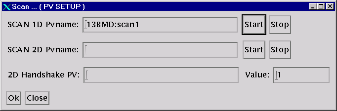

After the data catcher is loaded, run Process Variable Setup (PV Setup) by clicking on the setup button and then choose scan.
Enter 13BMD:Scan1 in the field of "SCAN 1D Pvname". For 2D scans, enter the second PV name in the field of "SCAN 2D Pvname".
Scan 2 – for 2-D scans
Scan 3 – for 3-D scans
Scan 4 – for 4-D scans

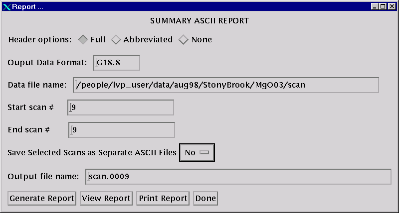

Under "Print", you may chose to print out your scan results (ASCII) to a printer or save it in a file – be sure to select the correct scan # to save.

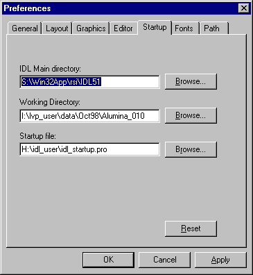

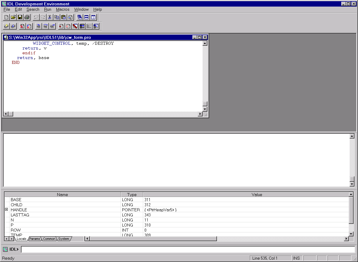

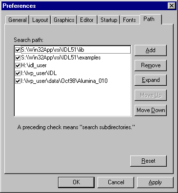

Choose Start > Programs > IDL5.1 > IDL. This will open the IDL development window:
Choose File > Preferences > Startup and select Working Directory, e.g.:
Then choose Path, and add the Working Directory in the path, as shown below:
Make sure the box next to the directory is checked.
