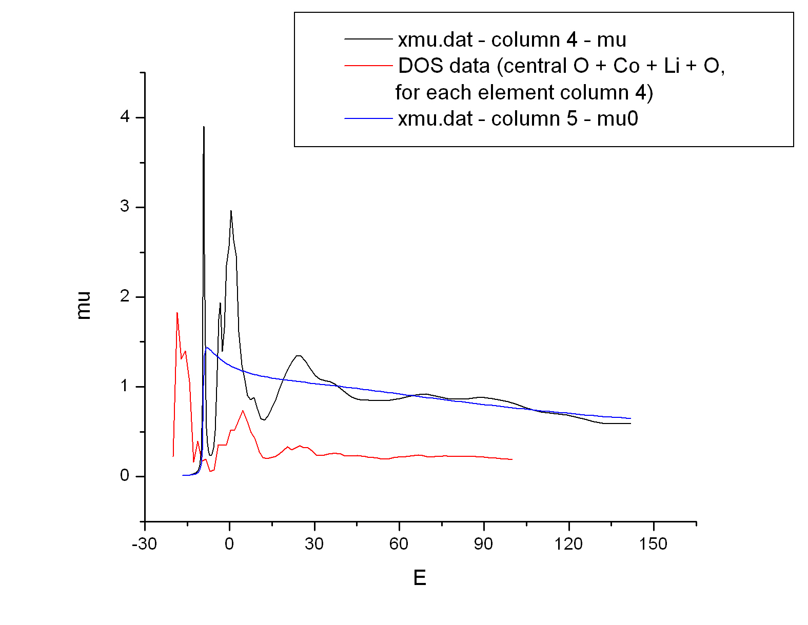

Hi John,
Thanks for your detailed reply. I am attaching the feff.inp file as well as a plot of mu, mu_o, and pDOS vs. energy. Please have a look. Faisal
