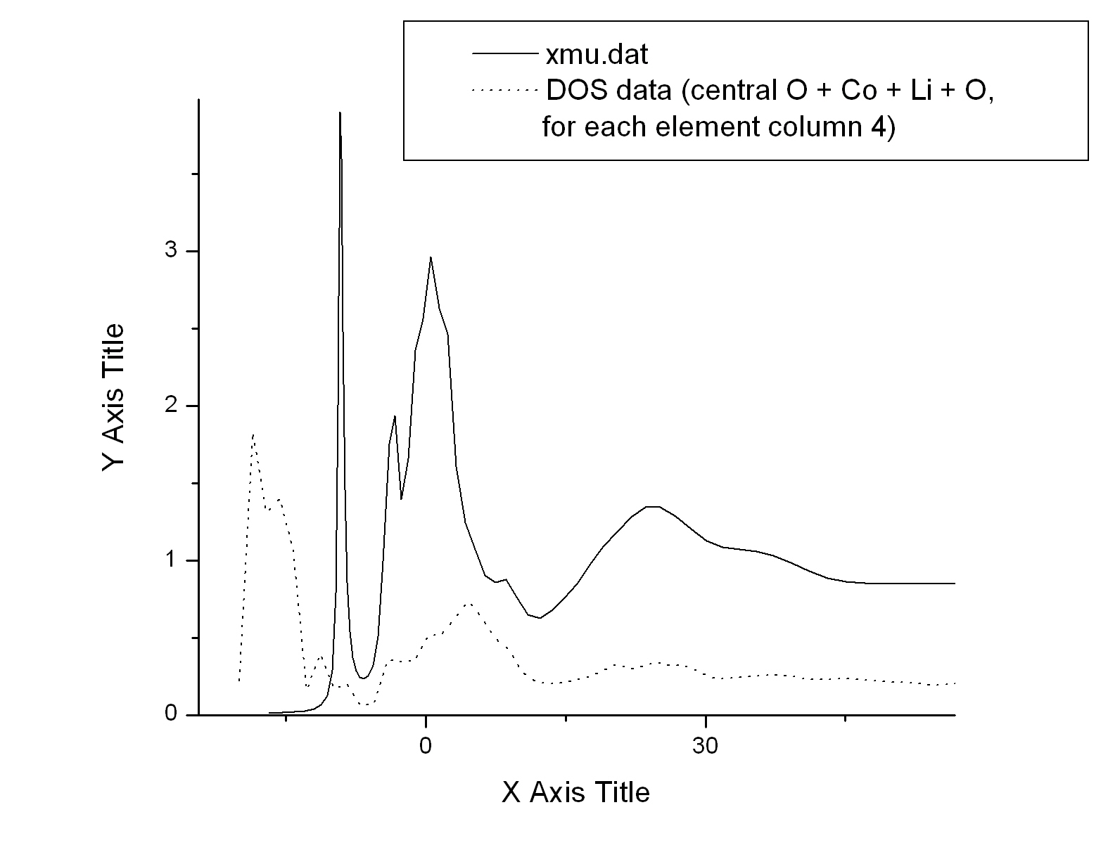

1. I am attaching the sum of all the p-symmetry LDOS as compared to the mu plot. Sorry that the axes are not labeled. The x-axis here is in electron volts. As you can see, there is significant disagreement between the pDOS and the mu plots, especially in the region of ~ 10 eV where there is no sharp p feature. Where is this feature in the mu plot coming from, if it is not present in the pDOS?
2. In order to make a proper comparison between the pDOS and the mu functions, I suppose I need to add a step function to the pLDOS . Is that correct? Would it instead be valid to amplify the amplitude of the pLDOS function by a constant so that it more or less overlaps with the mu function in the region of say 35 to 60 eV?
