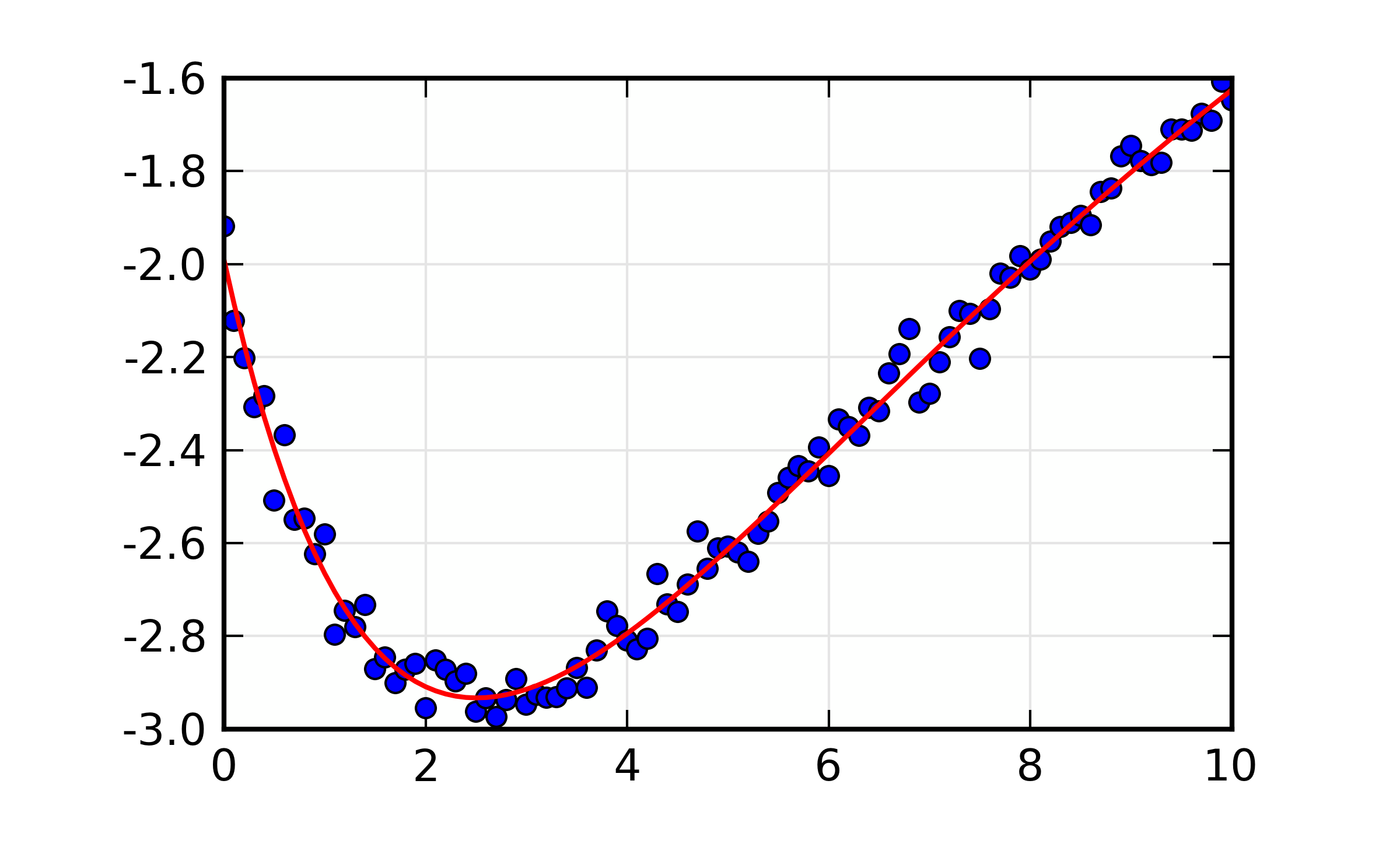

You can see that the correlations between all 6 pairs of variables is above 90%. The resulting plot of the best-fit looks fairly reasonable:
../_images/fit_example_conf2.png
Figure 10.8.1 Fit to double exponential function.

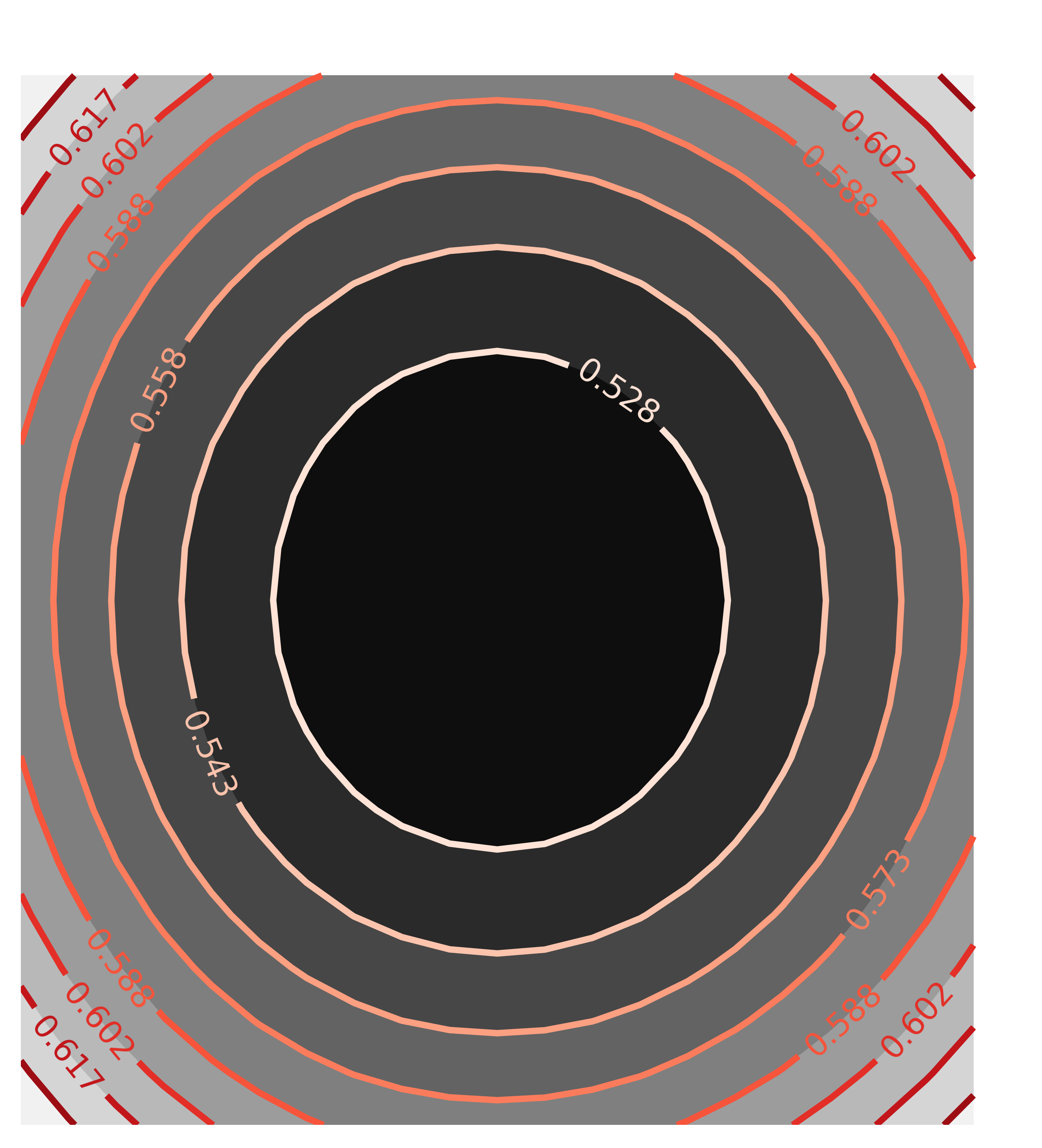

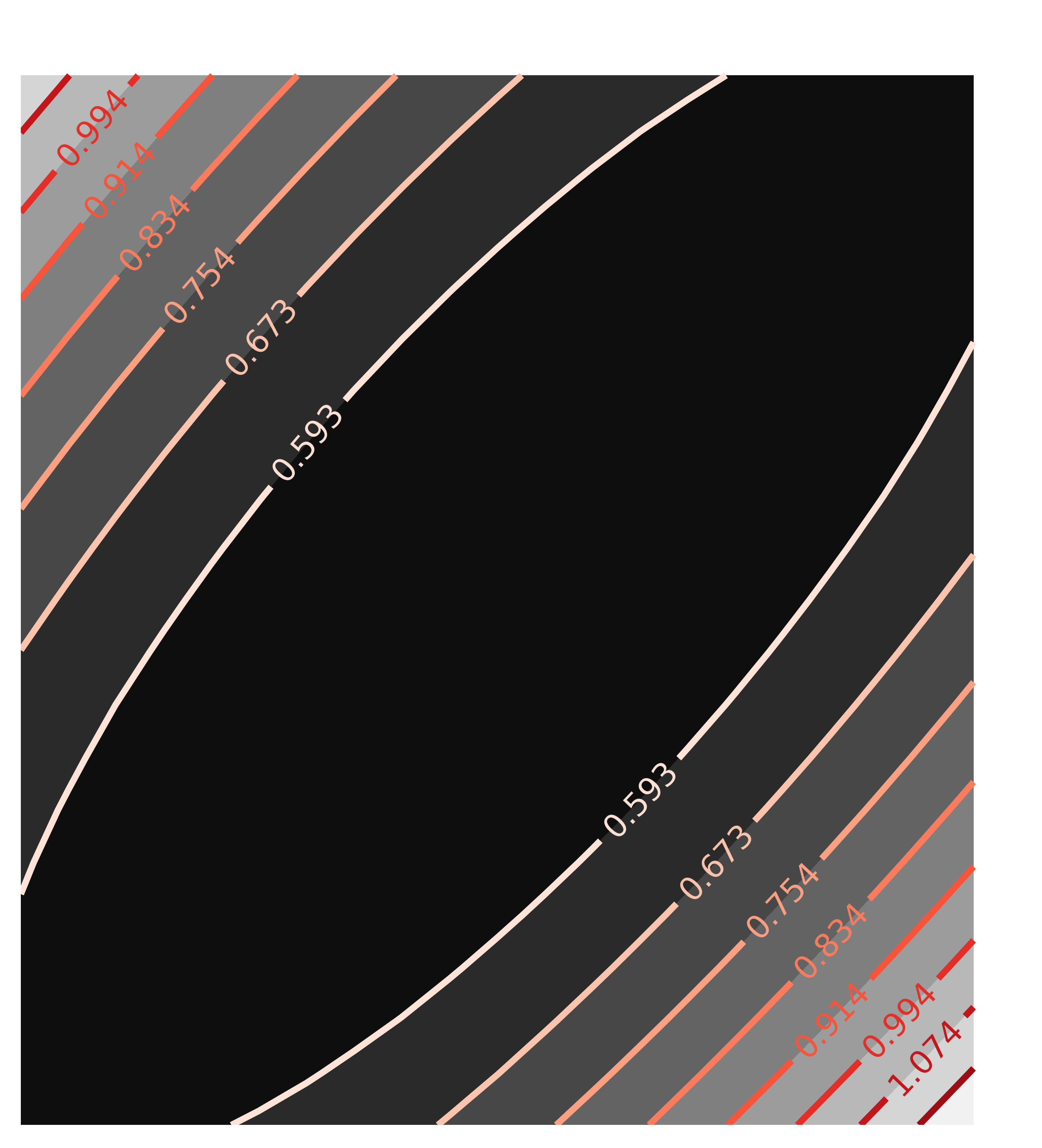

As an example usage, we return to the first example of the “well-behaved” fit, and run chi2_map() on a pair of variables with low correlation and a pair with high correlation:
x1, y1, chi2_ampcen = chi2_map(mout, 'amp', 'cen', nx=21, ny=21)
x2, y2, chi2_ampwid = chi2_map(mout, 'amp', 'wid', nx=21, ny=21)
contour(chi2_ampcen, x=x1, y=y1, title='Correlation(amp, cen)')
contour(chi2_ampwid, x=x2, y=y2, win=2, title='Correlation(amp, wid)')
with the resulting Chi-square maps looking like this:
../_images/fit_example_conf3a.png
../_images/fit_example_conf3b.png
Chi-square maps for two pairs of variables for the fit to Gaussian data. With the best-fit chi-square value of 0.5134, the contour map for relatively uncorrelated parameters amp and cen is shown on the left, while that for the more highlycorrelated parameters amp and wid is shown on the right.
The circular map for the uncorrelated parameters amp and cen and the elliptical map for the highly correlated parameters amp and wid are exactly as would be expected, and what the automated estimate of uncertainties and correlations assumes.

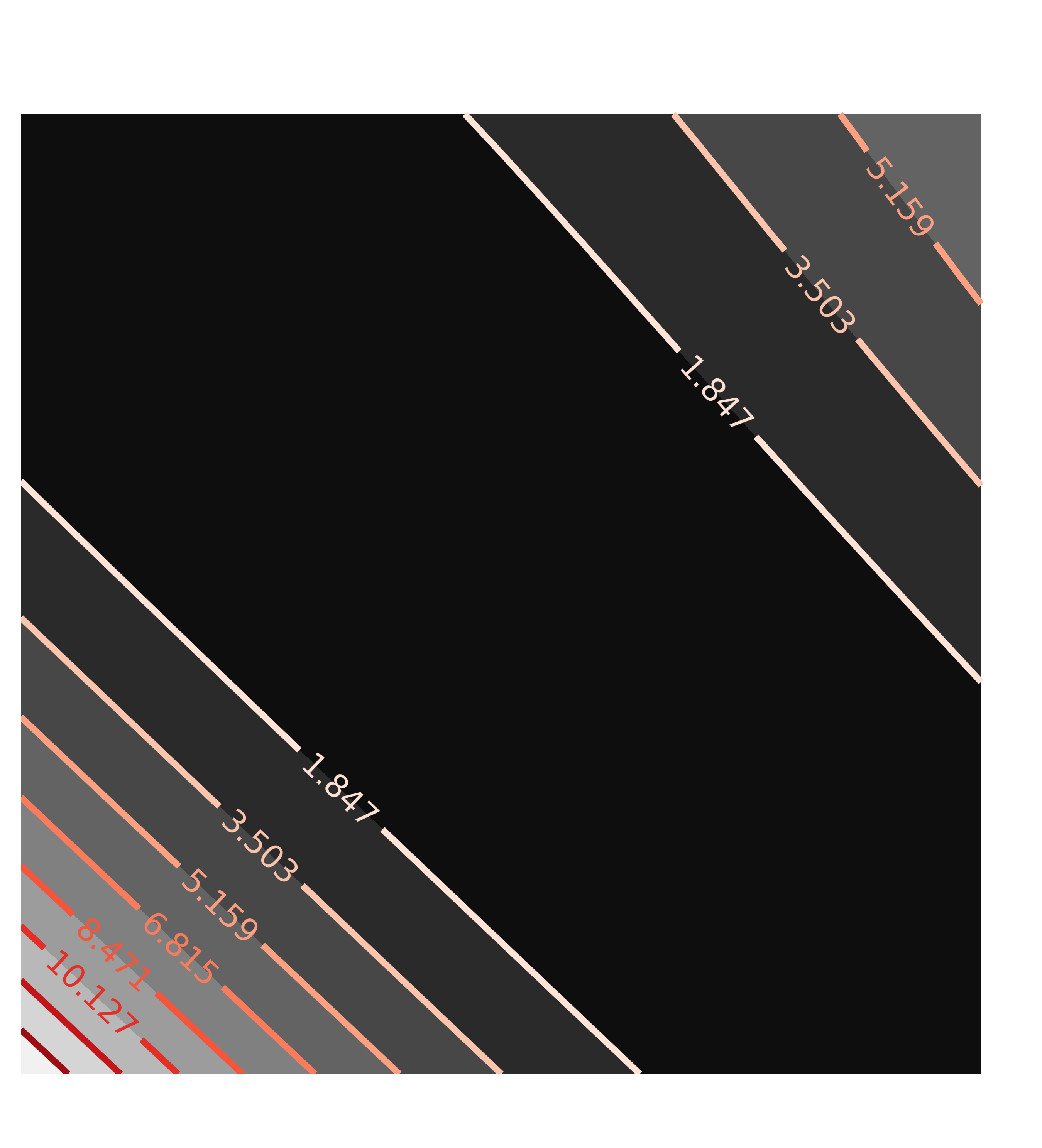

But now, if we turn to the more pathological case of the double exponential, we calculate the chi-square maps as:
x1, y1, c1 = chi2_map(minout, 'a1', 'a2', nx=25, ny=25)
x2, y2, c2 = chi2_map(minout, 'a1', 't1', nx=25, ny=25)
contour(c1, x=x1, y=y1,        title='Correlation(a1, a2)')
contour(c2, x=x2, y=y2, win=2, title='Correlation(a1, t1)')
with the resulting contour plots:
../_images/fit_example_conf4a.png
../_images/fit_example_conf4b.png
Chi-square maps for two pairs of variables for the fit to Double Exponential. With the best-fit chi-square value of 0.1913, the contour map for a1 and *a2 is shown on the left, while that for a1 and t2 is shown on the right.
Here, the values of chi-square quickly grow very large away from the ideal fit. More importantly, the maps are not remotely elliptical.
