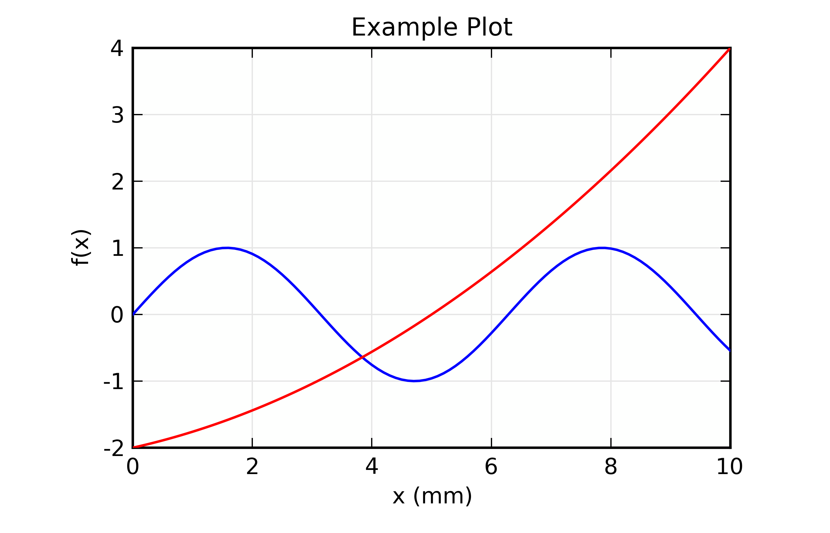

Adding a second curve, and setting some labels:
plot(x, y2, xlabel='x (mm)', ylabel='f(x)', title='Example Plot')
will make this plot:

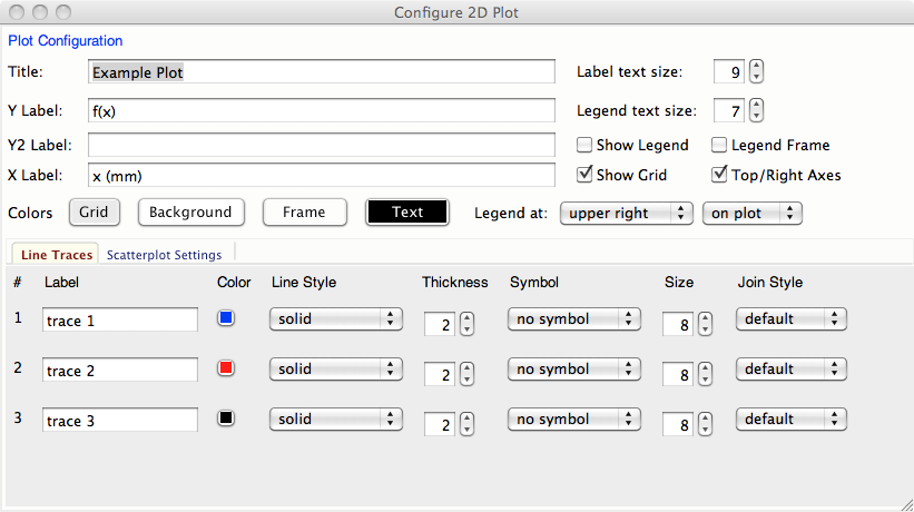

Configuring the Plot:
From the Plot Window, either Ctrl-K (Apple-K for Mac OS X users) or Options->’Configure Plot’ (or right-click to bring up a popup menu, then select Configure) will bring up the plot configuration window, which looks like this:
From here you can set the titles, axis labels, and styles, colors, symbols, labels, and so on for each of the line traces drawn.

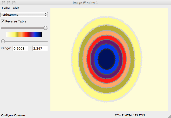

7.2. Image Display and Contour¶
_plotter.imshow(dat, x=None, y=None, colormap=None, **kws)¶ Parameters: - dat – 2-d array of some intensity
- x – 1-d array of x values
- y – 1-d array of y values
- colormap – name of color table to use.
display a grey-scale or false-color image from a 2-d array of intensities.
_plotter.contour(dat, x=None, y=None, colormap=None, nlevels=None, **kws)¶ Parameters: - dat – 2-d array of some intensity
- nlevels – number of contour levels shown
display a grey-scale or false-color contour map from a 2-d array of intensities.
For both these functions, the x and y arguments are intended to show real world coordinates for the image, not just the array indices. If None, the array indices will be shown.
By default, the image will be shown with the origin (pixel [0, 0]) in the lower left corner. The image can be rotated and flipped by the user.
The colormap argument is the name of the color map to use to transform intensity to color. The default table is ‘gray’ for a grayscale mapping. Other valid names include ‘coolwarm’, ‘cool’, ‘hot’, ‘jet’, ‘Reds’, ‘Greens’, ‘Blues’, ‘copper’, and a host of others, available
From the Image Display Window, you zoom in on regions of the image, rotate the image, change the color table, change the intensity scaling, change the interpolattion algorithm used. You can also toggle between showing an image of continuously varying intensities and a contour map. An example image, generated with
## examples/plotting/doc_image2d.lar
def gauss2d(x, y, x0, y0, sx, sy):
return outer(exp(-(((y-y0)/float(sy))**2)/2),
exp(-(((x-x0)/float(sx))**2)/2))
enddef
ny, nx = 350, 400
ix = arange(nx)
iy = arange(ny)
x = ix / 10.
y = -2 + iy / 10.0
dat = 0.2 + (0.05*random.random(size=nx*ny).reshape(ny, nx) +
2.0*gauss2d(ix, iy, 190, 176, 57, 69))
imshow(dat, x=x, y=y, colormap='coolwarm')
## end of examples/plotting/doc_image2d.lar
is shown below:
and as a contour plot, with a different color table:

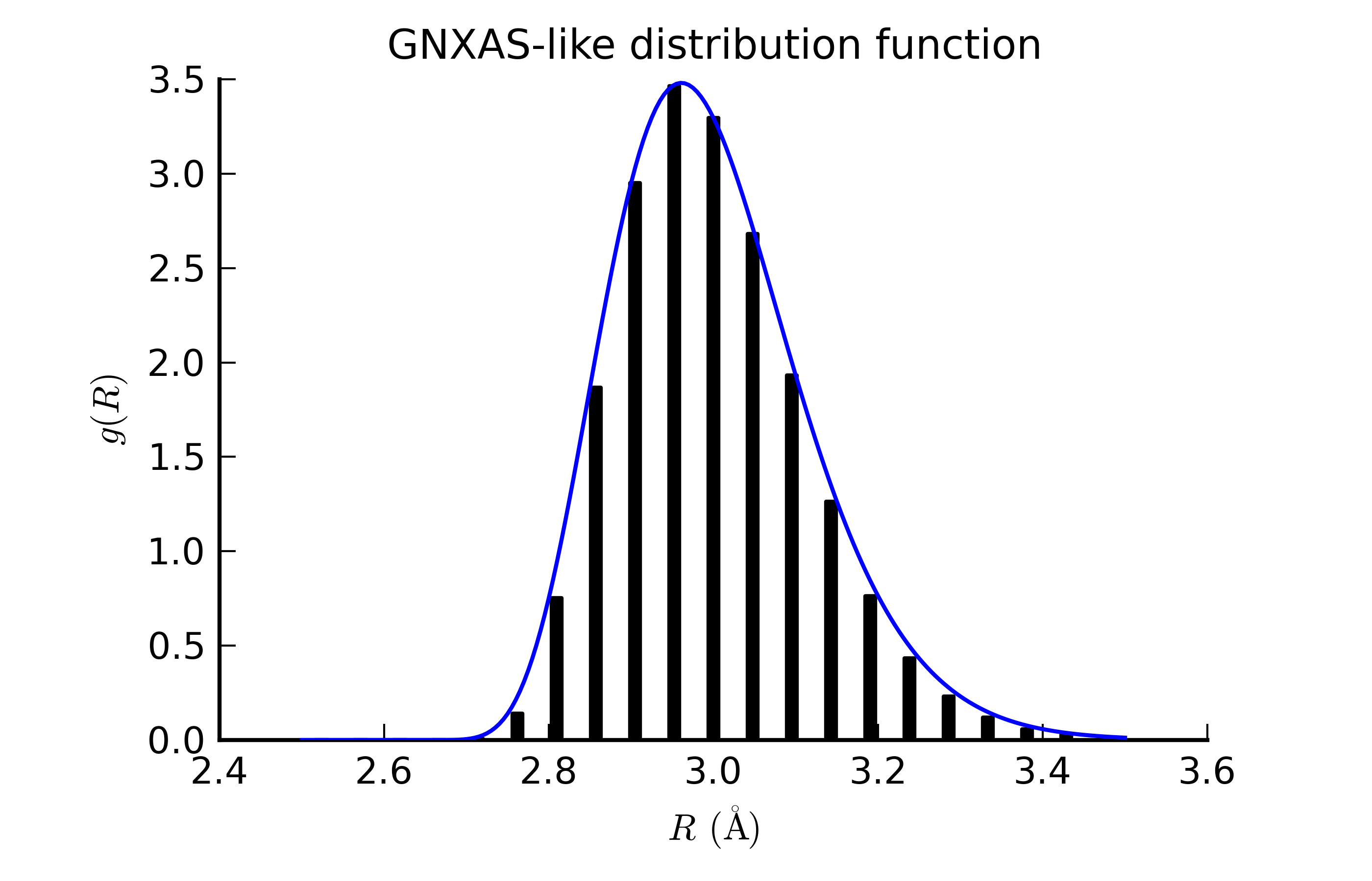

As an example of what you can do with this, here we make a histogram plot
from a sampling of a more conitinuous distribution. This uses
matplotlib’s hist() function,
## examples/plotting/doc_use_mpl.lar
from scipy.special import gamma
title = 'GNXAS-like distribution function'
sigma, beta, r0 = 0.12, 0.65, 3.0
q = 4/beta**2
amp = 2 / (sigma*abs(beta)*gamma(q))
# calculate g(r) on a fine r-grid:
r = linspace(2.5, 3.5, 201)
arg = q + (2*(r-r0)) / (beta*sigma)
gr = amp * exp(-arg)*arg**(q-1)
# note removal of nan's and impossible values
gr[isnan(gr)] = 0
if min(gr)< 0: gr[where(gr<0)] = 0
# standard plot of g(r)
newplot(r, gr, grid=False,
xlabel=r'$R\,\rm(\AA)$', ylabel=r'$g(R)$',
title=title, fullbox=False)
# calculate g(r) on a coarse r-grid:
hr = linspace(2.5, 3.5, 21)
harg = q + (2*(hr-r0)) / (beta*sigma)
hgr = amp * exp(-harg)*harg**(q-1)
hgr[isnan(hgr)] = 0
if min(hgr)< 0: hgr[where(hgr<0)] = 0
# get panel, matplotlib axes
panel = get_display().panel
axes = panel.axes
# plot histogram of coarse-grid data
histo = axes.hist(hr, weights=hgr, bins=len(hr), rwidth=0.25, color='k')
panel.draw()
## end of examples/plotting/doc_use_mpl.lar
which generates a plot that looks like
